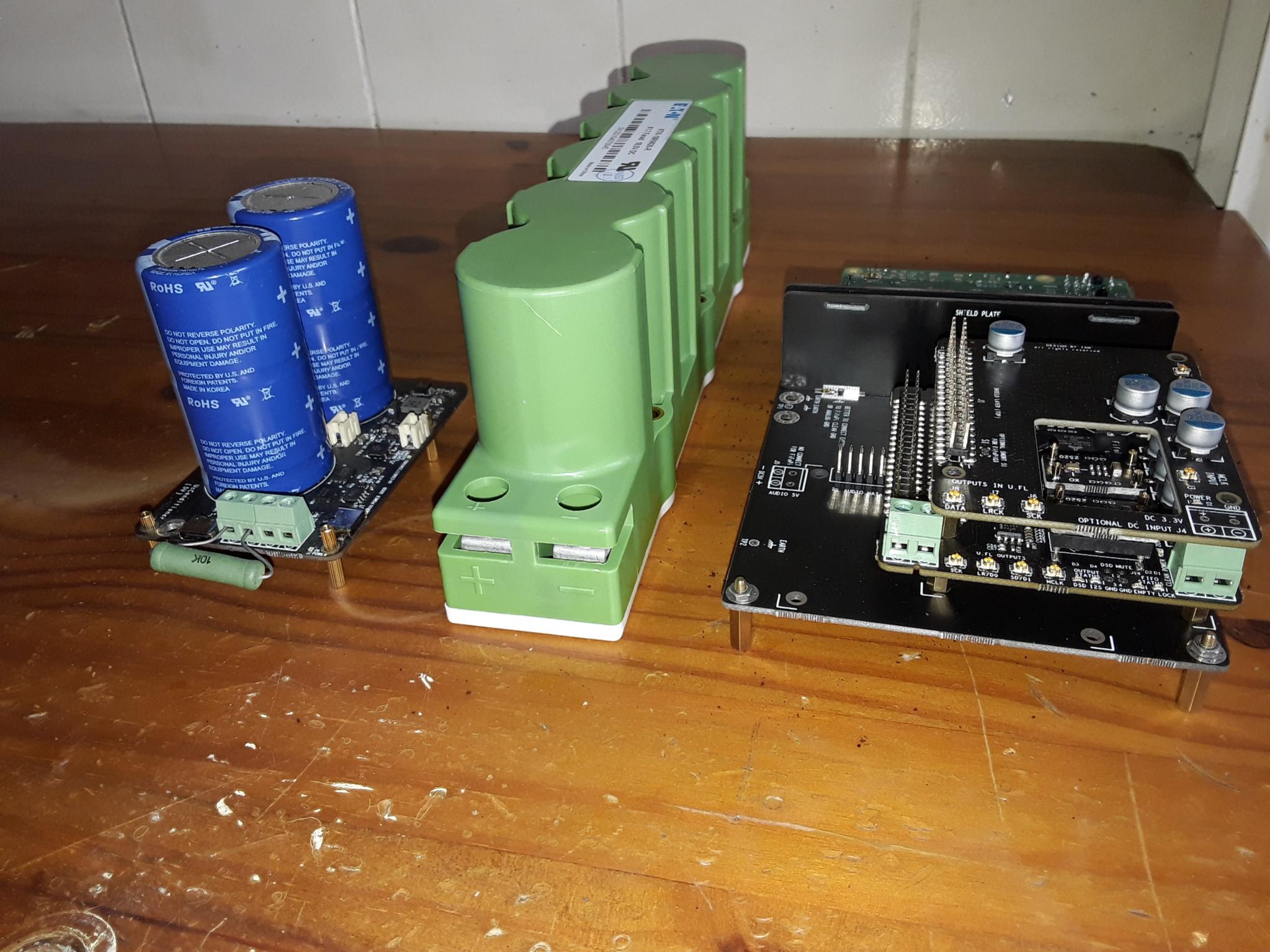

Hello,
Recently i asked Doede ( DDDAC man) to make a kind of '' redesign '' of his 5/12 volt regulator board by removing the transformer, diodes and input capacitors because i wasnt planning to use them. This gave me a much small board which is easier to use.
I have several '' spots '' where i will use it. Some will take more current like the Roon Nucleus so need to use a bigger heatsink.
As you can see the output cable from the circuit will be soldered on that board using a 5/6/7 cm cable ending with a plug that will be connected to the NUC power input.
I really think that this will be better than spending a few hundred Euro's on a separate DC supply in a slick box connected with a 50 cm cable ( which will have several '' interruptions '' if you start counting at circuit board in the slick box. We both start with a connection at the circuit board. Their second connection will be on the inside of the power output terminal. My second one will be on the plug entering the Nuc board.
I REALLY think that if you wanna take full advantage of very nice power supplies you must focus also on getting SHORT connections with very few interruptions.
Greetings, Eduard

Thank you Andrea.
Of course Eduard, as short as possible.
But powering 2* DRIXO and 4*DBM require a minimum length.
I imagine two parallel cables for each clocks families, with 3 DC jacks in the two parallel lines.
You are free to comment this arrangement if I'm mistaking.
