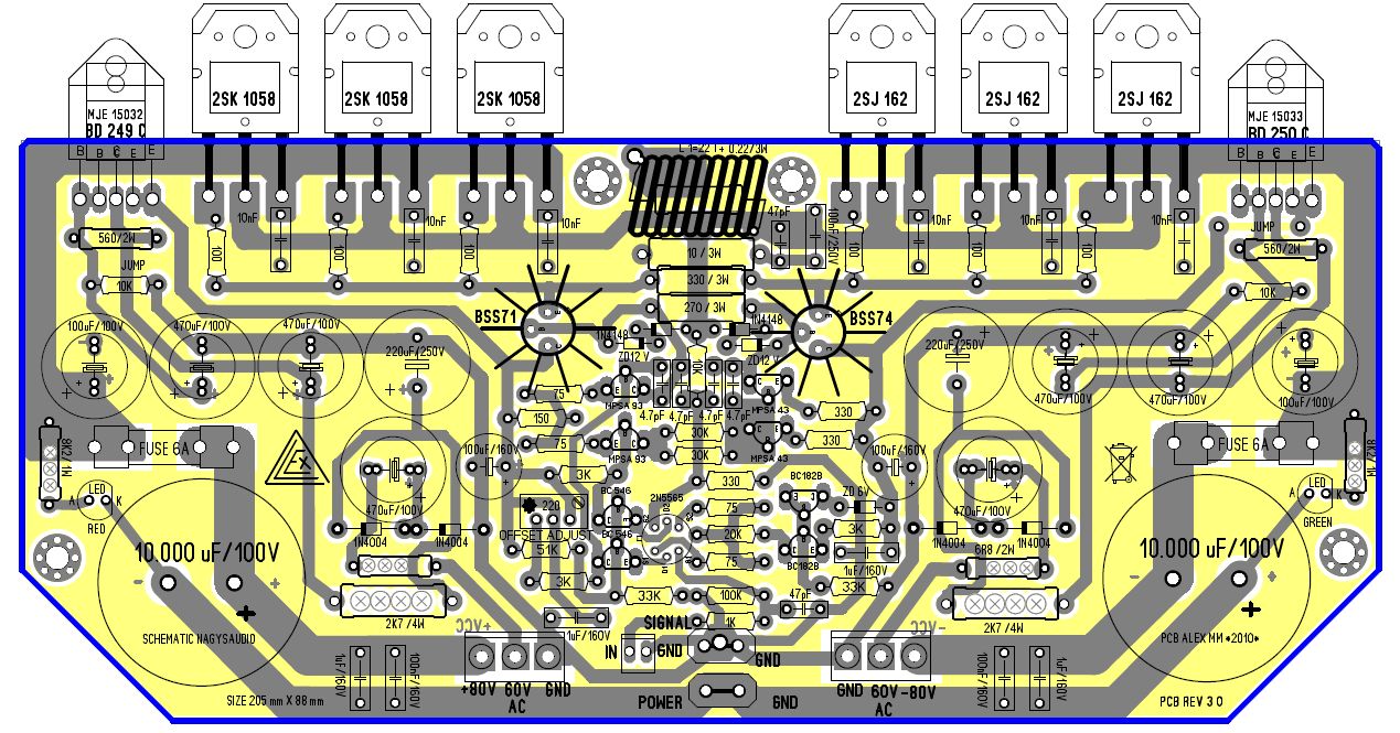

Some interesting snippets taken from the Goldmund technical notes
The question has been asked multiple times in this thread about transistor matching, and it seem the design has engineered this factor out.
No wonder your previous breadboard clones were not blowing up Nagys 😉
TRANSISTOR SELECTION
Transistors have been selected for their minimum sonic thumbprint. The double inverted symmetrical topology makes the negative and positive part of the signal travel in the same type of transistors to symmetrize the non-linearity of these transitors.
The low coloration allows multiplication of this same kind of stage without the typical sound alteration.
The total symmetry and use of inverted transistors in each signal path provides high insensitivity to transistor matching. Replacement of a transistor doesn't effect the balance of the design nor the sound quality.
A single adjustment for each stage compensates for DC offset differences between modules so that a quick DC tuning is the only adjustment needed after a transistor or input module replacement.

All this is more reason to build the modules exactly as Goldmund did. It is perhaps possible they knew what they were doing.
Certainly Nagys experience of this amp besting all the other high end brands attest to that.
Nagys: If we use a single transformer with dual windings (1 for 80V+, 1 for 80V-) we still don't have a separate winding for the 65VAC required for the VA section. What are your recommendations for that transformer?
The transformer should have dual secondary windings of 60VAC in parallel, or 120VAC in series.
You can certainly use just a single transformer for each channel. If you take the voltages after the bridge, you'll have +/- 85VDC (formula: 60X1.414=84.84) to feed the outputs, which is perfect. Then just feed the input stages with 60VAC that you can take before the bridge.
As far as the toroidal transformers are concerned... Goldmund Mimesis 9.2 (mono block) used 2 transformers.
Can you confirm what Goldmund use in the 9.2?
You will be doing everyone a disservice if they put in a smaller transformer than what Goldmund use.
The transformer is one of the key ingredients.

I cannot confirm how powerful Goldmund's transformers are because I don't own the Mimesis 9.2, nor do I have access to one. And even if I did, the transformers are completely potted so I wouldn't be able to look.
Any suggestion that Goldmund Mimesis 9.2 uses, or that this amp needs transformers in the 1000+VA range, is completely ridiculous.
For Mimesis 6, Goldmund used approximately 300VA (5"X2") transformers per channel. That amp has a max power rating of 200 watts at 3 ohms. Perfectly falls in line with this simple basic formula: 200 X 1.414 = 283 watts.
Here's a picture that shows the tops of the transformers:
For Mimesis 3, Goldmund used two transformers per channel. They are very small (3.5"X1.5"), therefore I'm guessing they are 150VA each. Mimesis 3 also has a max power rating of 200 watts at 3 ohms. Which again corresponds with this basic simple formula: (150 + 150) X 1.414 = 283 watts.
I conclude with certainty, that Goldmund Mimesis 9.2 uses two 300VA transformers per channel, totaling 600VA. Mimesis 9.2 has a max power rating of 400 watts at 3 ohms. 400 X 1.414 = 566 watts.

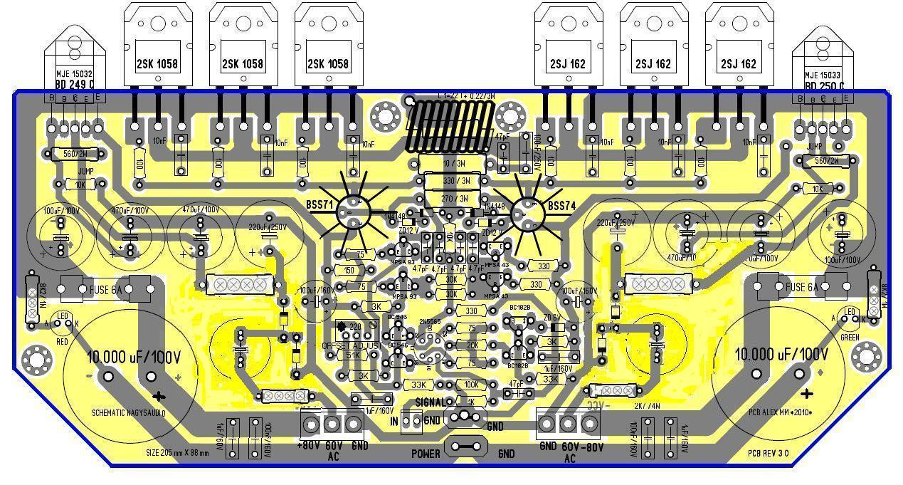

Basic rule for that overhere in the '80s-'90s was sizing the transformer smaller or at max equal to total Pd of the output devices.
Also in-line with the mains fuse value, 5A slow at 220Vac is 1100VA, fat chance the total transformer VA was way more than half that value.
IMHO, this project would require a MAX 500VA XFMR per channel(and that is too much) but who cares anyway. Strap a couple 2000VA's down and get yer freak on. To each is own.
300VA to 400VA per channel would deliver the goods.
Now if somebody would proto these Goldmund board(s) and run it through some paces...then you may end up with another "Krell KSA50 Clone" type thread...but who ever did finish THOSE K50 builds anyway?
