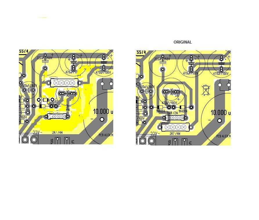

fuse
Hi there,
First thank you for launching such a exciting project. As I would like to participate to this GB, I will do my homework comparing schematics vs PB.
I've had just a quick look, the fuse on the PCB is ON FRONT of the big cap (4.700uF) (not between C31 and C32) - on switch-on it could burn - unless a "slow" type used (?)
I will try to pass through it this afternoon...
Hi there,
Can you also please add fuses to the schematic? There should be a 10A fuse located between C31 and C32. And also between C34 and C35.
PCB with fuse in right place ....

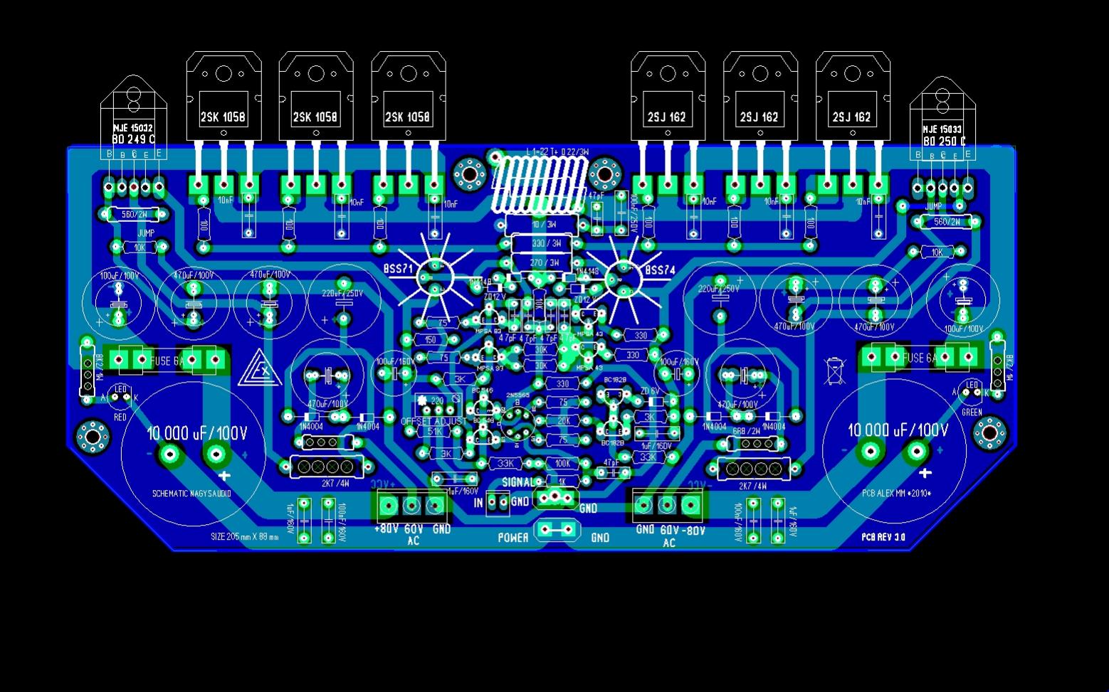

Hi ,
This afternoon PCB was revised and upgraded to version 3.0 ...🙂
Alex.
Hi ,
Alex.
Looks really good Alex! Can you please update the protection circuit and use this relay (Panasonic JTN1AS-PA-F-DC24V): http://pewa.panasonic.com/assets/pcsd/catalog/jtn-catalog.pdf
Please make sure that the circuit traces will work with this relay's legs/pin-out. This is a current Panasonic relay and a replacement for the old Panasonic relay that Goldmund used. This relay is inexpensive and is available everywhere, so a great choice to use.
Thank you again for very quick work. Please contact Bigpanda so that he can receive your new files.
Anyone who is interested in participating in the group buy, please go here and follow post #6: http://www.diyaudio.com/forums/group-buys/175296-pcb-order-goldmun-clone.html
We are getting close to the final version of the board now. Only a few minor changes remain.

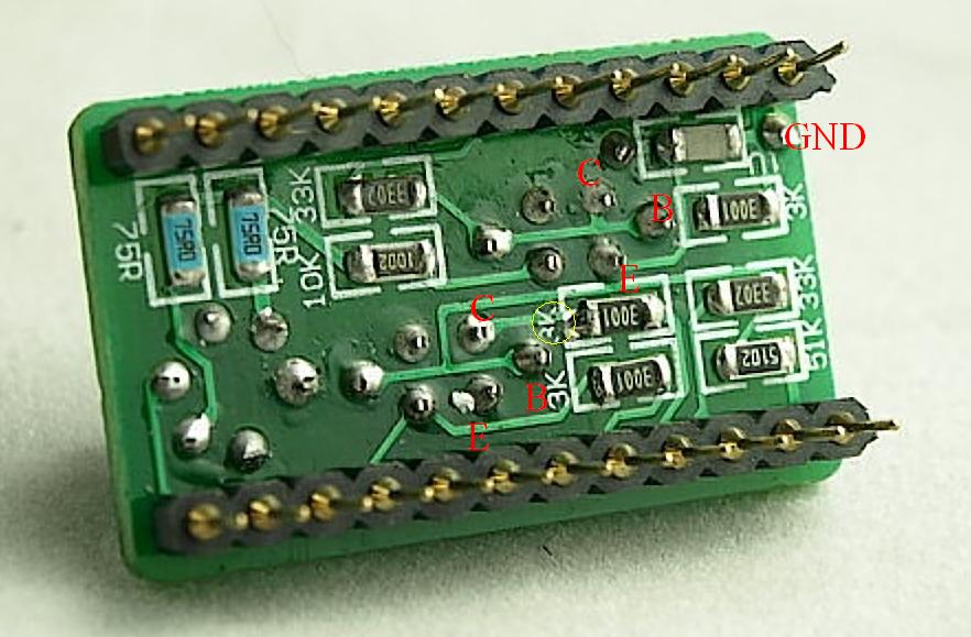

T6
NagsAudio, I have looked at the picture of the SMT version of the module in post 540 and T6 is mounted the "normal" way, not flipped. See picture. The BC182B transistor was/is manufactured with different pin configurations from different manufactures. Hope this helps.
