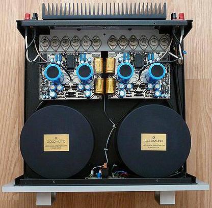

BTW, in this Goldmund amp I plan to compare different output schemes:
(1) 2 pairs of K135/J50
(2) 2 pairs of K135/J50 + 1 pair of K1058/J162
In this Goldmund schematic, you don't need to match any transistors. Including the output MOSFETS. Change them as you will, with no degradation to sound. The amp will always perform 100%
This PCB board that Alex has created has a ground plane. You can simply connect all the ground points to the top of the board, makes it extremely simple. The entire grounding scheme in the Goldmund amplifier is extremely simple. All ground points are soldered to the ground plane. The chassis and the ground plane are NOT connected. The chassis is connected to the ground wire that goes to the receptacle. That's it!

You all do not know how Goldmund managed this very critical circuit.
Strangely I feel the same thing that as Jam stated this circuit should not be as stable as keantoken has "simulated". But I don't know nothing about this so I don't want to give opinion, and it doesn't matter much anyway.
Just from looking at the top picture of the Mimesis85 I can see how well the circuit is laid out. So different from the pcb shown in this thread.
Well, I remember once I hade a tremendousely nice layout on my board. I had been working on it for weeks. And it all went oscillating. Then I shortened the distance between the drives and the end transistors by about 5 mm (another weeks work). And suddenly everything went rock stable, regardless of what load I put on the amp and so on. That gave me the wisdom that I really did know nothing at all.... ;-) I will later give you an example of the circuits I designed. Would be interesting to get your opinion. But we must all know that this was all about 1990. Things may have changed dramatically since then.....
