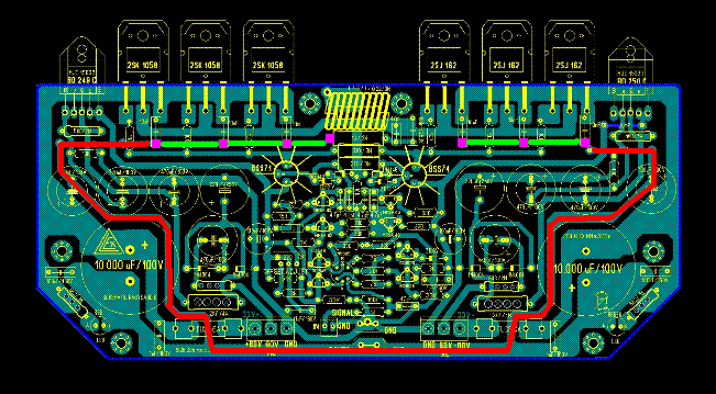

I have a concern about the 10nF decoupling capacitors on the output devices. The idea is to have as short a path as possible at HF between the output devices and the "power ground". Unfortunately the PCB has been laid out so that the "power ground" connection is at the opposite side of the PCB to the output devices.
Fortunately not all is lost as the really important thing is just that there's a short path between the positive rail decoupling caps, the negative rail decoupling caps, and the "earthy" end of the zobel. The path length to the PSU is not so important.
In the pic below, the pink spots show the bits that need to be connected with the shortest possible path lengths. On the left, the green lines show the connections between the positive rail caps and the zobel. On the right, the green lines show the connections between the negative rail caps. So far so good, but...
The long red line shows how the negative rail caps are connected to everything else. Oops, this is not good. Seriously, it doesn't help to put the caps right next to the mosfets if the other end of the caps are connected to a long skinny copper track that snakes around the entire PCB before connecting to anything useful.
As a quick-fix, I'd recommend adding a few wire links between the stuff on the left and the stuff on the right.
If double-sided board is going to be used, it would be really good to have a wide strip of copper across that side of the board as a local power ground plane, with the decoupling caps and zobel soldered directly to it.
Cheers - Godfrey
p.s. All the above is just IHMO. Perhaps someone who understands this stuff better would care to comment?

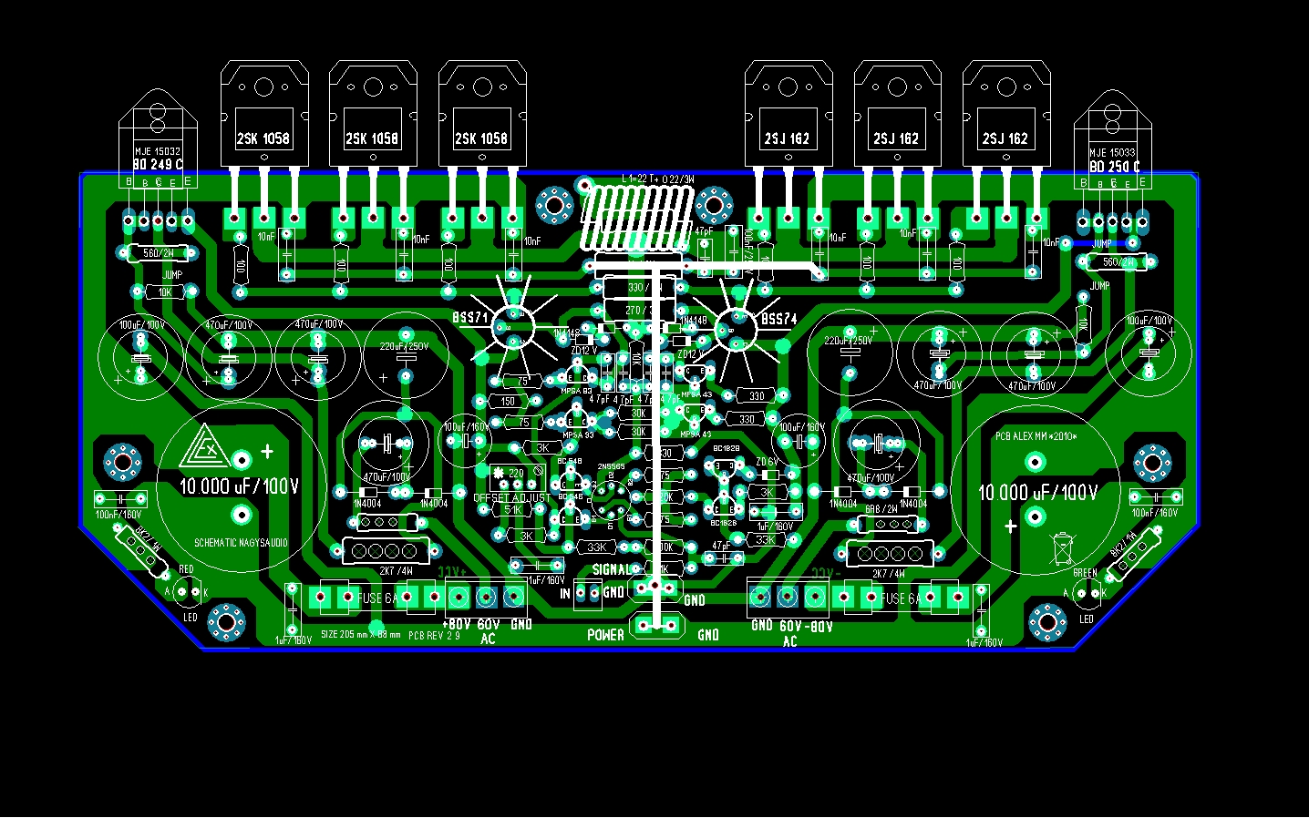

.... yes you are right gotfrey , I know about all you tell as, but when I layout PCB I intended from start to make it single sided to be avaible to all diy people around here .I'm not an proffesional guy , it was only my wish to help this forum .The problem could be solved in an simplier way adding two pices of wires on bottom like in the picture below attached (white line). Next will be double sided.Top side is ground plain ....so no problem.
Regards Alex.🙂
