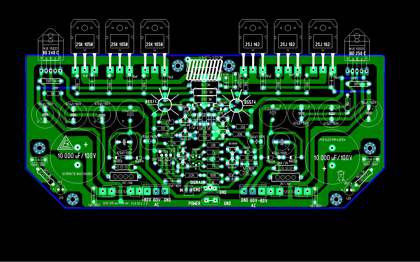

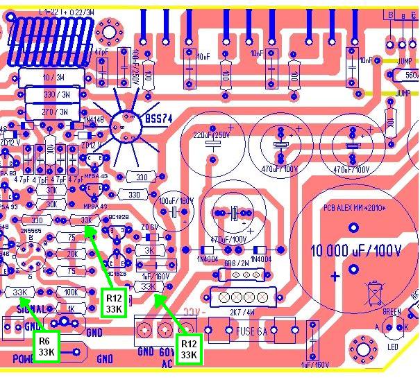

There is an extra 33K resistor on the PCB. R13 has been duplicated. See pic below. The PCB is wrong.There are two 33K resistors in the schematic...
[snip]
This PCB is 100% correct and extremely well designed, layed out.
...yes , my mistake , only one resistor from b T6 to gnd will be soldered on PCB , so the right PCB can see below .
Alex .
L.E. gaborbela witch one ? and whay ?
Alex .
Hello
That 33K you took out from the layout , that was an extra and made wrong connection.
I wrote about these many times . I you go back some post earlier you can see it.
Now it since to me is fine.
Thank you Alex!
Greetings
Thank you Alex!
Greetings

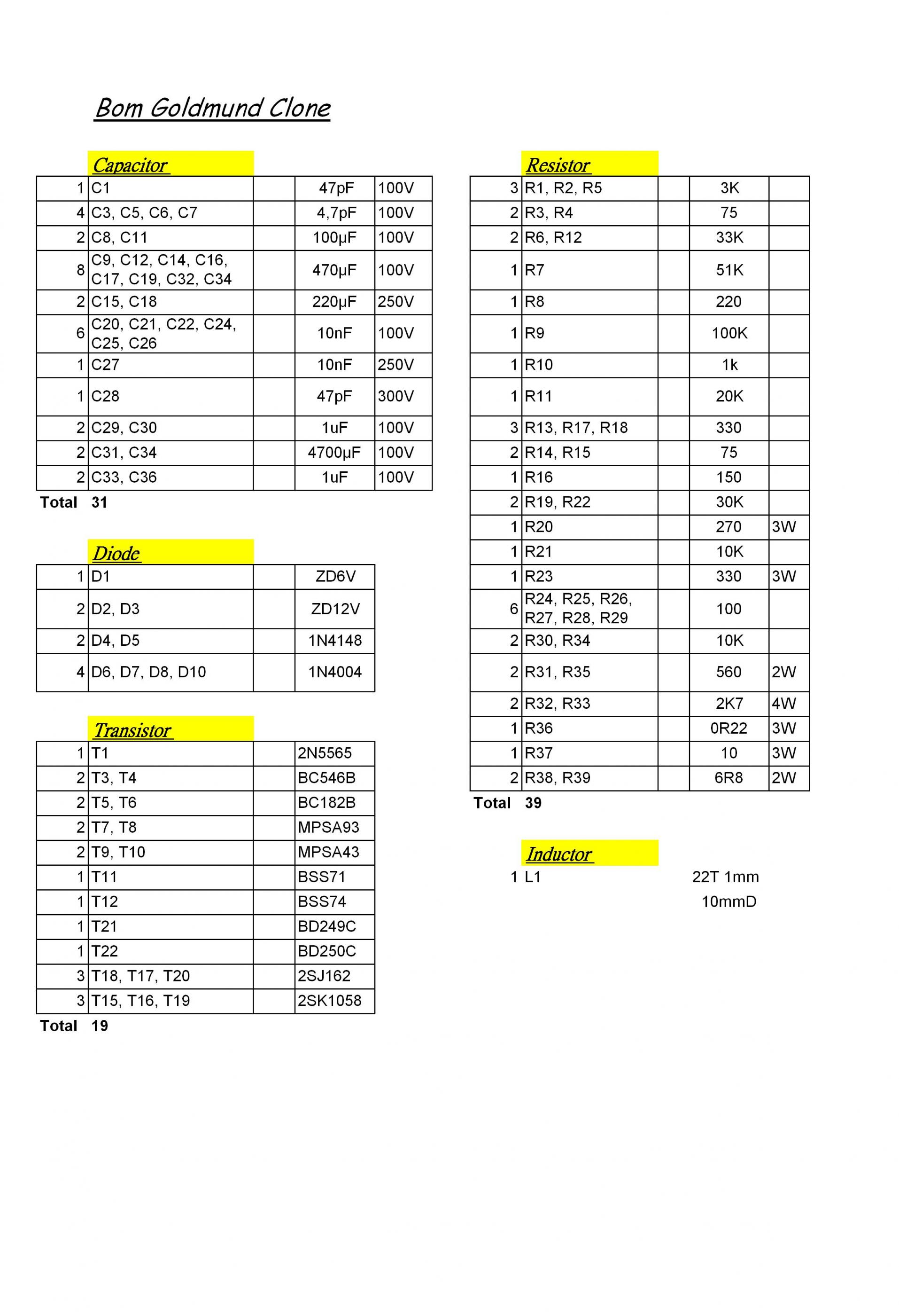

BSS71/BSS74 can be replaced by MPSA92/MPSA42 in this schematic. You might need to change the bias 270ohm resistor (R20) with a 330ohm resistor.
Well guys I observed the thread for some time and the project really seems to be nice, I might be interested in the boards as well, can someone please summarize the project as
type of amplifier, expected power, and put a parts list together? This might help to have in one reply as the complete informations, what might help as well might be a powersource design. Just to make a complete overview.
Daniel
Daniel
