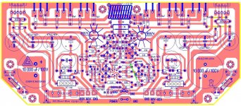

..Schematic , PCB file ... revised, again and again ...
Hi to all,
I think this time will be the right schematic and PCB files posted here acordings to Nagysaudio schematic from the bigining of this thread.
I don't share files until we are not totaly agree if are correct all files .....🙂
Alex.
Hi to all,
Alex.

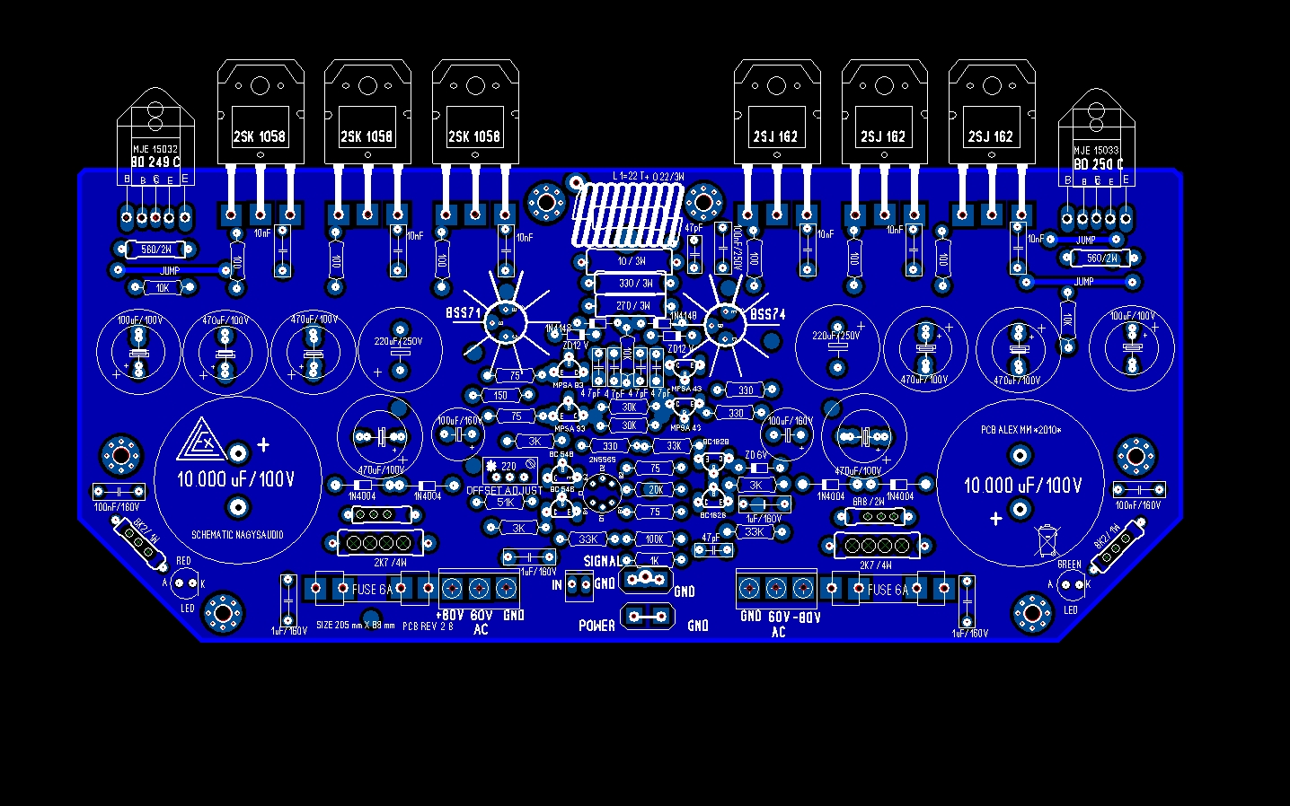

bigpanda, can you please organize the group buy? Also, will the boards have Electroless Nickle surface finish? I'm not sure how you want to handle this. DIYAUDIO members who are interested, can you please PM bigpanda, or post here on the forum with your order?

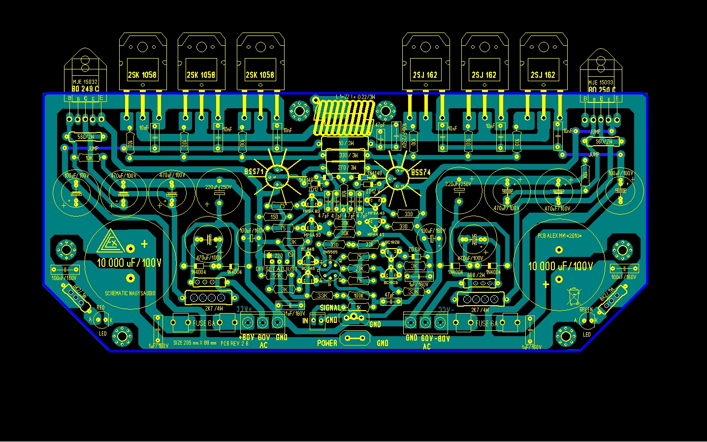

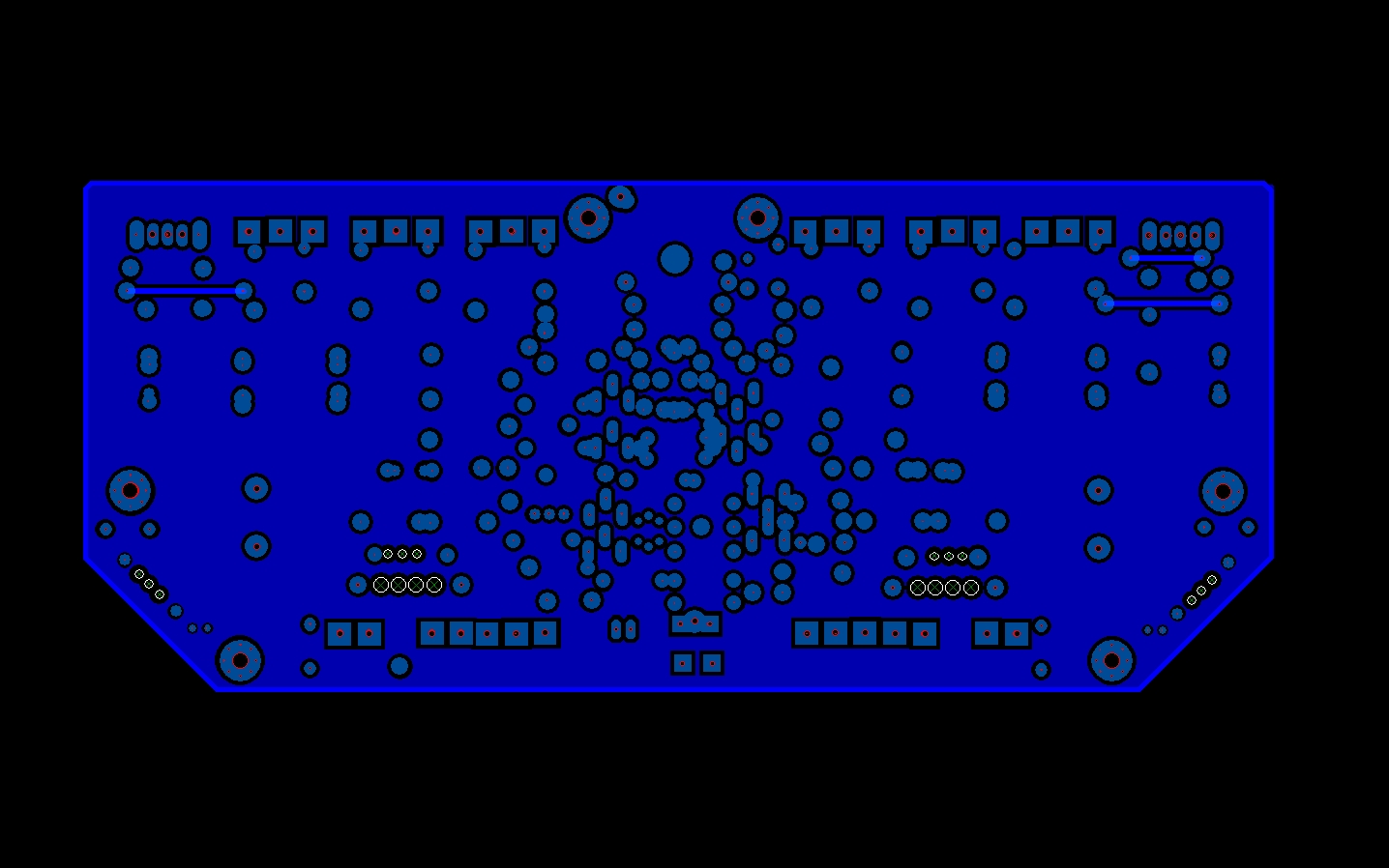

Alex, has not provided the files which would show the "ground plane", on the component side of the PCB. So if there are enough interested members who want the ground plane, maybe we can all kindly ask Alex to provide this file. Otherwise, I say we go ahead without it. The amplifier will perform correctly either way.
Alex, can you please post, or send the printable .pdf files to bigpanda. The final main circuit PCB layout from post #549 and the smaller protection circuit layout?
We will need 1 pair of each board to complete this project. I can be the first one to be added to bigpanda's group buy list. I will take 2 pairs of each board. Total of 4 main circuit PCBs and 4 protection circuit PCBs.
NOTE 1: Please remember, T6 on this PCB is connected incorrectly. When building the amplifier, please follow my original schematic on page one. To correct this problem, T6 will have to be rotated 180 degrees. The correct connection is as follows: T6's (BC182B) Emitter (leg 3) and Base (leg 2) are to be shorted. The Cathode of the 6V Zener diode should be connected to T6's Collector (leg 1).
NOTE 2: D2, D5, D4, and D3 are all connected incorrectly. Please follow my original schematic on page one when building this amplifier to see their correct orientation. To correct this problem, simply reverse the orientation of D2, D5, D4, and D3.
Other than that, this layout and circuit is ready for prime time! The PCB can be etched as is in post #549, so long as these corrections are made while building.

Alex, thank you very much!!! The schematic and PCB are now 100% correct 🙂 T6, D2, D5, D4, and D3 are now all correctly connected. Is there any possible chance that you could post the layout of the component side of the PCB with a ground plane? I think a lot of potential builders would be interested 🙂
Great! Thank you so, so much Alex!!
bigpanda - Group buy can now go ahead. For the main circuit board, we should do the double sided PCB, with the ground plane on the component side. For the protection circuit (smaller PCB), it shall just be single sided.
