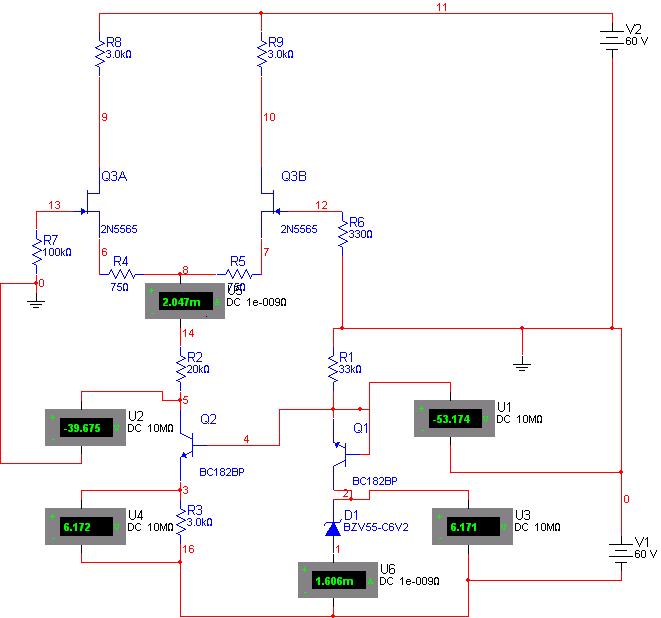

I sort of agree, except that there can be a significant variation due to component tolerances anyway. It seems odd to put that much effort into making sure the bias doesn't drift with temperature, if you don't know whether it was right to start with.Second, it looks to my like this CCS was designed for low tempco, and this is smart considering the FETs use just a resistor for setting the bias right.
Something that keep's bugging me about this circuit is that there's no way to adjust the bias. I'm not familiar with these kind of output devices but the datasheet does indicate that the "turn-on" voltage can vary over a wide range. Is that not important?
I'm wondering if Goldmund doesn't have a way of setting the bias that's not shown on the schematic. e.g. R23 is shown as 330R, but maybe that's just a "typical" value, rather than cast in stone.
Scratch that, a temperature analysis would be useless since the FETs are located away from the CCS. There's no way we can expect the CCS to compensate the the FETs unless they are mechanically coupled.
With this, my opinion is that the "emitter-down" version is best, because of the lowest tempco and higher output impedance. As far as noise, we may never be able to tell.

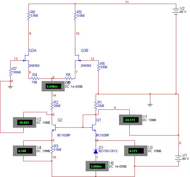

I'm not sure how far to trust simulators wrt upside down transistors. Is there not some simple test you could do on an actual device to check real-world behavior....I will simulate tempco of the Goldmund amp using all 3 CCS types.
As far as temperature behavior, I don't think it matters, since the heatsink and CCS aren't coupled. I also don't have any zeners to test with. And there's no way I can test noise.

Wait, your right MJF, I got that backwards. I was simulating with the other transistor flipped.
All my CCS simulations officially DON'T COUNT.
Okay, let's start again... Having the right transistor flipped, the only things to be affected should be noise and tempco.
- keantoken
- keantoken
I think that simulation is wrong, a diode formed from T6 is reverse biases and will give 6V abouth, or a bit more. In this casethe current source will dive cca 4mA.
That is why I wanted to know the voltage on the base of T5 with respect to the negative rail.

D2, D5, D4, D3, and T6 are all incorrectly connected. I know this amp and this circuit and I can promise all potential builders that it will not perform correctly. Beware.
The diodes can be reversed/changed while building the amp, no big deal. No changes are necessary to the PCB.
However, T6 cannot be easily rotated on the existing PCB. The PCB's tracks would have to be modified around T6.
EDIT: Actually, T6 can be rotated 180 degrees and its legs can be manipulated to make it still work. Kind of silly, but it would still work correctly. I'll still do the group buy. Anyone who connects the diodes and T6 the way it's shown in this schematic, please do not come to me for help. To make your amplifier operational.
