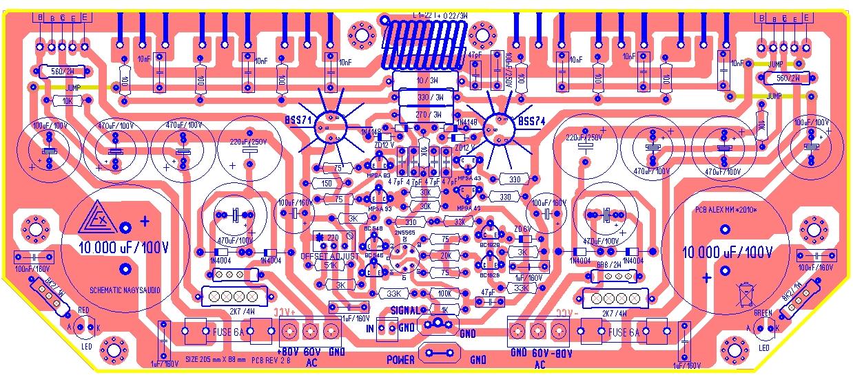

A single board should be etched and tested with a cro to be sure there is not any issues with pcb layout.
Hi Alex,
I am sorry about the mistakes I said in Post#576 about your pcb and schematic in Post#549. I missed Post#499 by Nagys who had cleared the problem at the end of the post.
However, the quote for PCB is OK

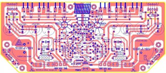

Hello
Guys now someone please tel me which is the correct layout or schematic .
I made a test PC board after the last version but I read Nagy comment on it.
The diodes are reversed and T6 is not right connected ???..🙄
Can someone please inform me , I do not want to each a bad test board.
These is the last layout posted by Alex at post 549. I switched the color so I can see it better .....
Thank you

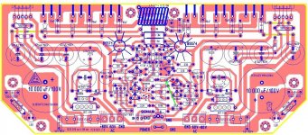

Hello
I believe these is a important mistake!
At T6 Emitter should be connected with Base after Nagy schematic..
Also you do not need that 33K resistor , I did put a mark there..
Where is the red line have to be cut .

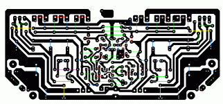

Bigpanda I made many PC board , I design after the color lay out , or I had just the schematic.
No program at all. I don't know how to use programs . I made them in the paint program!
It goes very slow
Please take a look my black & white layout and you decide..
Greetings🙂
