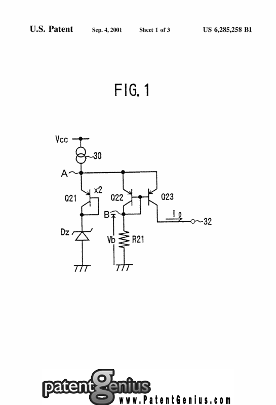

Apex, we know that there are many kinds of ccs, and they have MICRO difference. The question to you is, what difference does it make to connect it the way Goldmund does? I know the transistor doesn't function as a transistor there, but McGyver may know something?
With such a strange arrangement, will it give a certain amount of temperature coefficient? If so, remember that they (the front end) are potted with special compound, and I heard about dedicated heatsinking (?). Could it be just an attention to detail of the implementation?
Because we might have different implementation, how about this kind of ccs (attached)?

Again, T6 can be connected either way. But if you connect it the way apexaudio suggests, then you'll have slightly different voltages and it might unbalance the circuit. If that's what you want, please go ahead and do it. I will build it the proper working way, as been proven in the 2 Goldmund amplifiers that I listen to almost everyday.
You will have 6V on 3k emitter resistor of T5, and CCS give 2mA either way. Without thermal compensation 6V +/-0,002V per degree, so change of 50deg give 0,1V change Vbe on T5, less than 1% current change of CCS.
