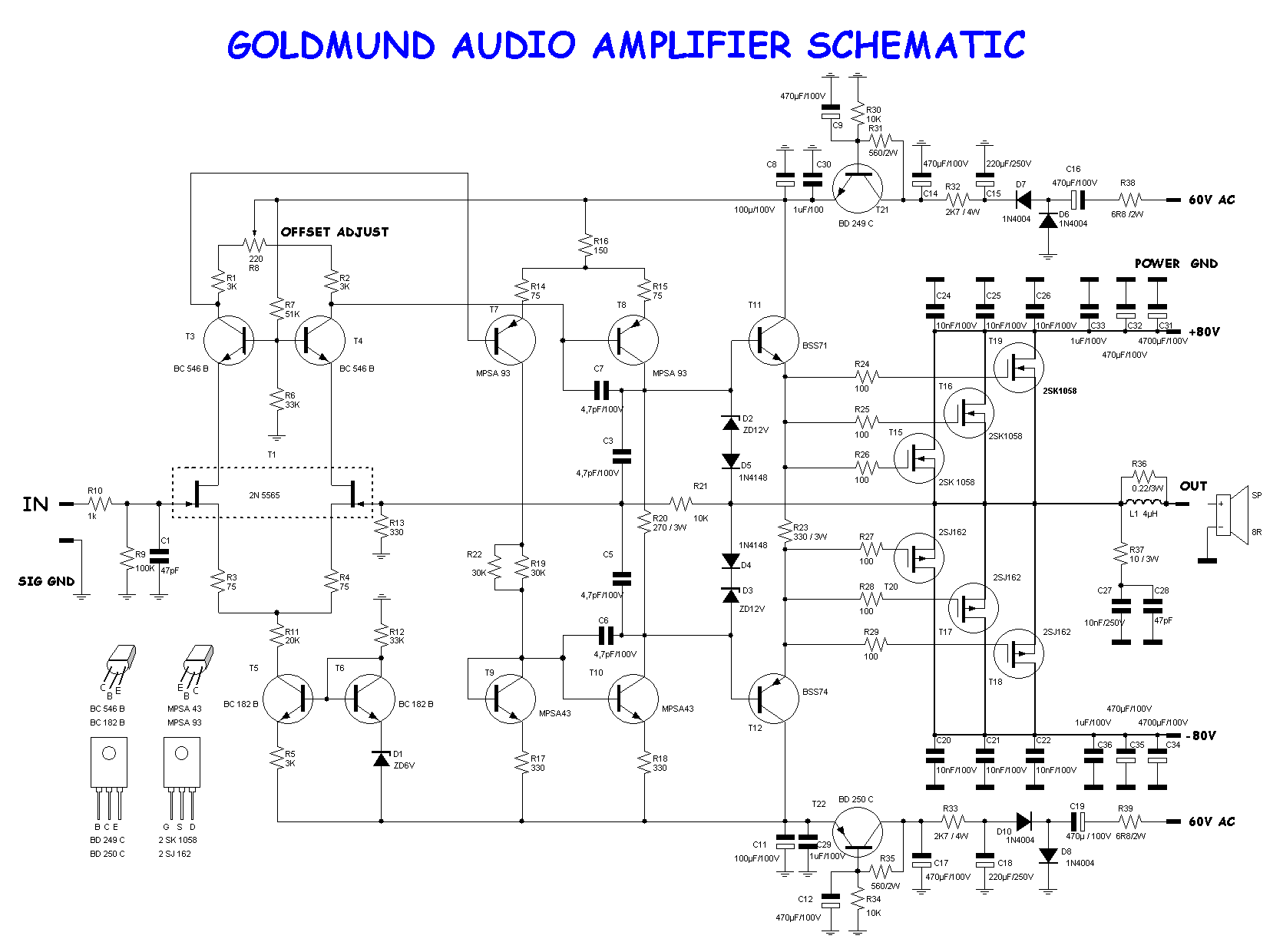

Schematic and BOM
Hi Bigpanda , Schematic update , and BOM with no details .
About output coil , don't be worried ,is not phamacy , could be winding in two layers if it's necessary . I think two screws for mecanical support it's enough for protection board .🙂 . I can generate , gerbers files for you if interested .

Hello,
I think since Nags started this thread and was gracious enough to provide us with an exact Goldmund schematic we should choose, those who wish, to build the Goldmund clone per the Goldmund specs. No one here would ever discuss making changes and substitutions to a Nelson Pass design or the original Leach amp. Therefore since Alex has done so much superb work we should commence from here. The design works and many were sold at retail to attest to this.

Hi Alex: I've been looking over the schematics all day and have found some mistakes, both in my original schematic and in your .pdf files. Can you please update them so that we all have the correct version. I apologize in advance for the extra work that this will cause.
Alex, in your "Protection Circuit" schematic, .pdf, can you please correct the following:
C4 needs to be reversed in polarity.
C5 needs to be reversed in polarity.
C8 needs to be reversed in polarity.
D4 and D6 should be labeled as 1N4002.
Rel1 should be labeled as JN1A-TMP-DC24V.
L1 should be labeled as 22T MOULDED.
R25 should be labeled as 0.22/3W.
Alex, in your "Goldmund Audio Amplifier" schematic, .pdf, can you please correct the following:
T6(BC182B) is connected wrong/reversed. D1(ZD6V) should connect to the Collector. R12(33K) should connect to the Emitter.
Can you also swap places of C30/C8 and C29/C11? C30 and C29 are small film capacitors (1uF) and they should be shown and connected as close to the input stage as possible.
L1 should be labeled 22T MOULDED in addition to 4uH.
Can you also please label the MOSFETS in parenthesis with the original part numbers (2SK134) and (2SJ49)? This way potential builders will know which transistors were original.
C16 and C35 should be labeled 47uF/100V.
Can you also please add fuses to the schematic? There should be a 10A fuse located between C31 and C32. And also between C34 and C35.
On C8, there's a missing F in the uF.
On C19, there's a missing F in the uF.
Now for the mistake that I made drawing the original schematic. This is an IMPORTANT fix. I'm not sure how hard it will be to implement it into the PCB layout. I apologize Alex. I hope you can fix it easily.
IMPORTANT FIX TO ORIGINAL SCHEMATIC:
The signal point (between Collector of T3 and resistor R1) should be connected to the Base of T8 (NOT to the Base of T7). Also, the signal point (between Collector of T4 and resistor R2) should be connected to the Base of T7 (NOT to the Base of T8).
This is everything that I could find wrong. I'll keep checking and double checking.
