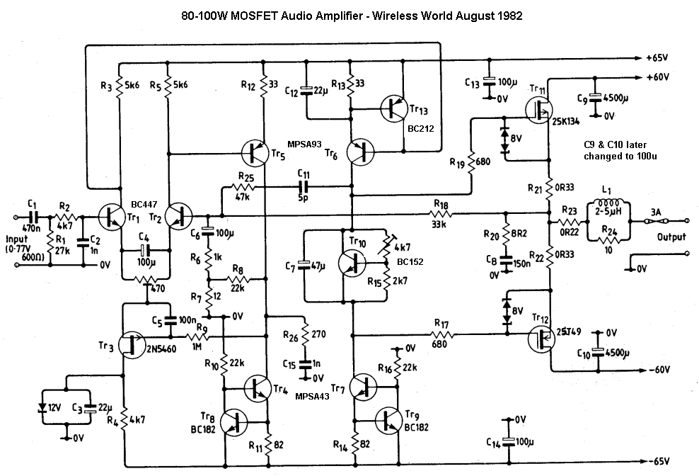

I just think you proved my point, you have limited the bandwidth of your amp. Try driving the amp with a square wave into 8ohms in parallel with 2uF and you will see what I mean.
My criteria for a good design is to apply minimum compensation to a completed design to achive your goal rather than applying a lot of compensation to an oscillator to achive the same ideal. Which is the better approach?

True that personnaly, i did follow the first path, that is,
autocompensated circuit, i.e, no external compensation caps at
all, the only ones being those intrinsical to the components.
Not sure that this is the best for hifi since it was designed
as a concert stage monitoring amp....
the MOSFETS were point to point wired.
With Lateral MOSFETs, how adventurous.

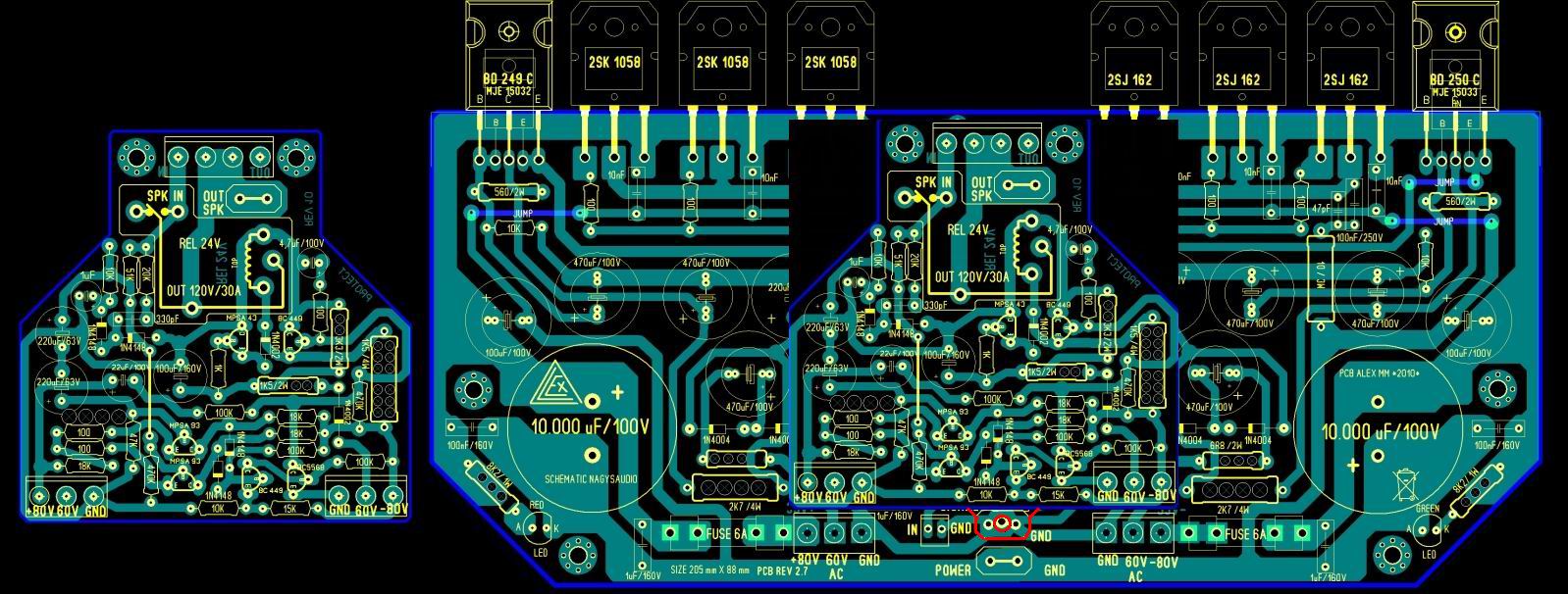

Hi Alex,
Schematic :
should it be C/T3-->B/T7 ; C/T4-->B/T8 ???
pcb :
if you can make a projection from the daughter board (as in red lines) with a M3 hole you can have a mechanical support for the DB (it is tripod now) Just make sure it align with the M3 hole (which you have to add) on the mother board (centre of your signal ground ) .
In post#261 there are 2 pairs of thermal coupled to-92, would that be BC546+546 ; BC182+182. If it is then if you swap your 2 BC182 (and some associate components) we may make them coupled as in Post#261. But for the BC546, we might have to wait for a double side pcb.
Starting to worried about the L1. With a limited spaced like what we have, we might have a hard time implementing it. I have done something like 1.2mm wire, 1cm core dia., 15 turns, pitch (~coil length)= ~20mm. Wonder if a 22T coil can fit into there.

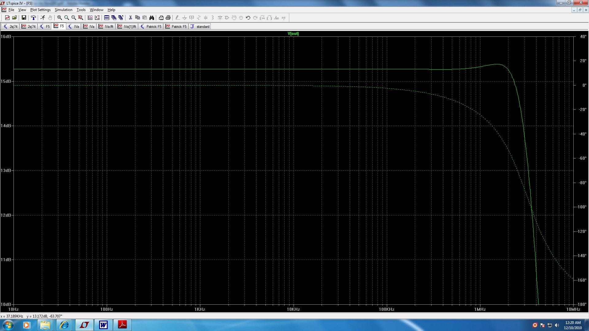

Just for people who have not been acquainted with F5, here is the frequency response.
My point is F5 is quite high bandwidth without any output inductor or compensation to keep it stable. On top of that there are no capacitors at all in the circuit.
Where as, this circuit seems to be held together by compensation caps etc to try and keep it under control.
F5 is using VFET which has higher transconductance than LFET. It is not easy to design a fast amp with LFET, so compensation is necessary. Even in many similar two-stage designs, LFET has similar problem.
