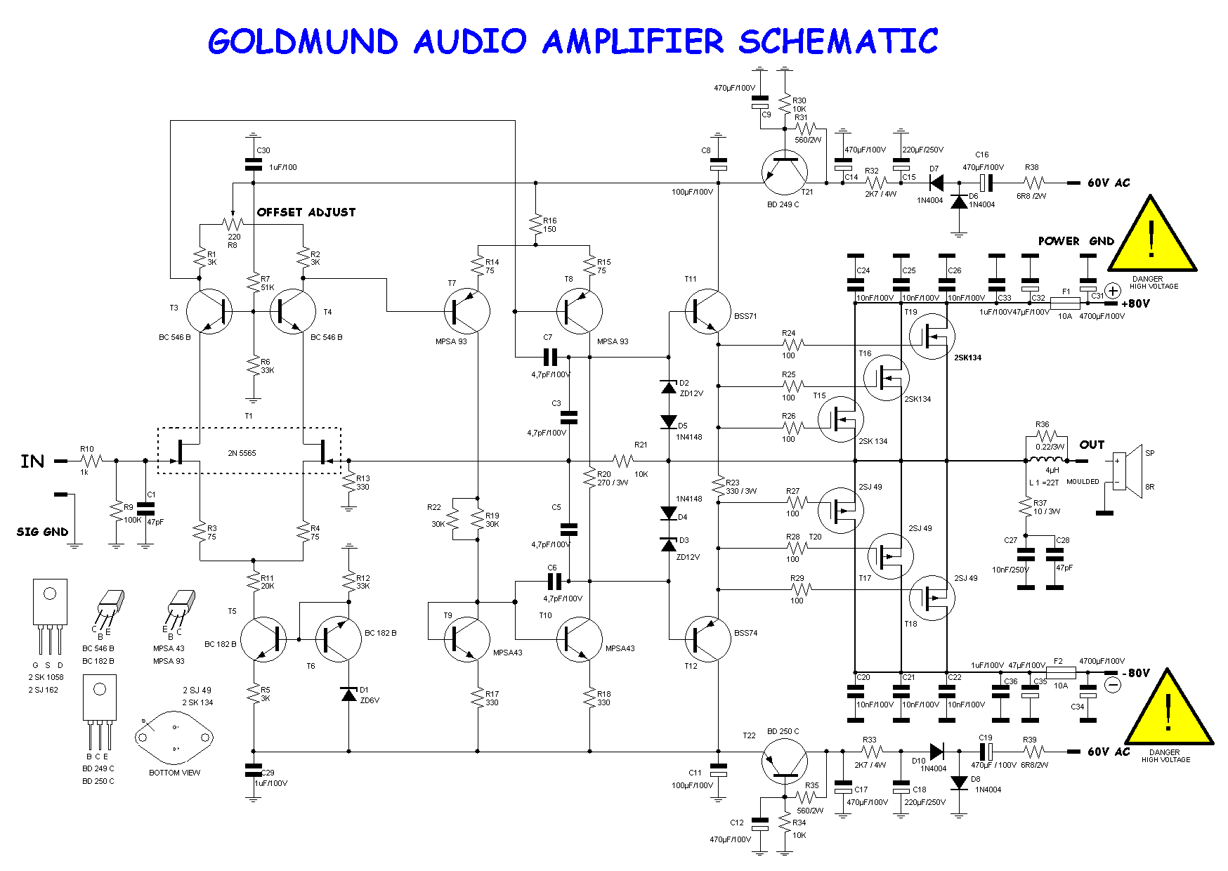

NagysAudio, is seems there is a temperture sensing device (NTC) mounted on the heatsink in the pictures of the 9.x amp. Can you check the schematic you have been sketching from to see if there is somthing more missing?

tommy1000 - Nothing is missing from the original Goldmund schematic. I've seen some Goldmund amps with the heat sensing device and some without. The schematic that I have is without. This is something that would have to be decided on by each individual builder, if they want to include it, or not.

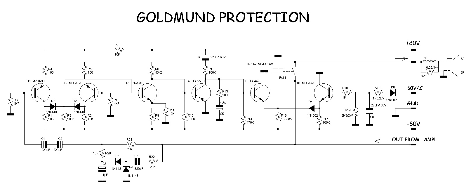

I started new thread: http://www.diyaudio.com/forums/solid-state/175192-mosfet-bjt-quasi-amplifier-protect.html with 'Zeck' amp, use HITACHI laterals mosfets and MOTOROLA bjts in output stage.
QUOTE=NagysAudio
T6(BC182B) is connected wrong/reversed. D1(ZD6V) should connect to the Collector. R12(33K) should connect to the Emitter.

........i think there is a difference between schematic post 1 and the actual schematic..........perhaps somebody should have a look at this.

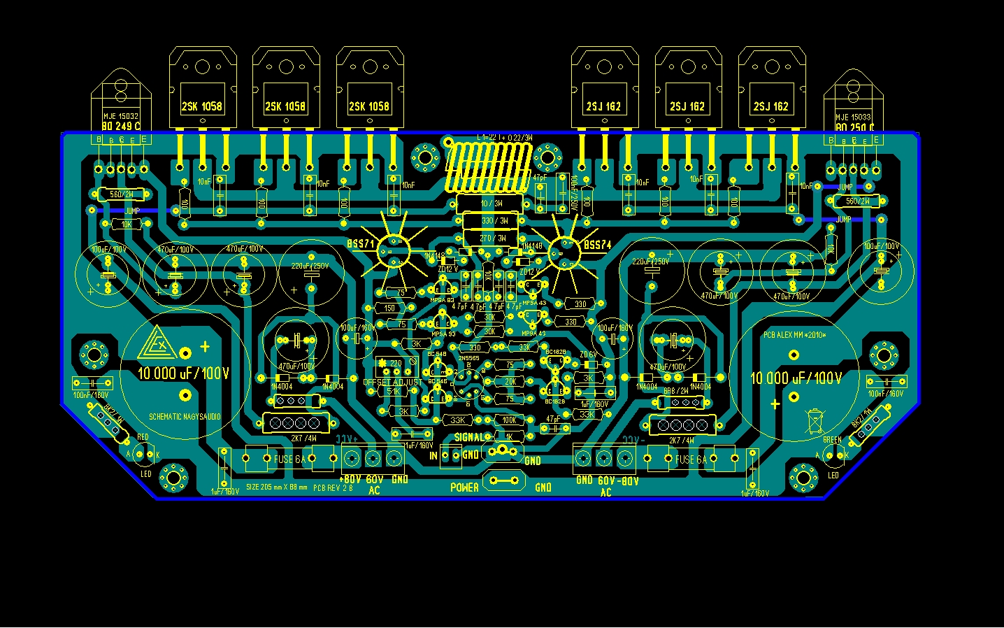

Revised again .....schematic and pcb ..
.....I have made correction in schematic and PCB , now it seams to be correct .

Nags,
would you be kind enough to put together a BOM for the finished design when it is approved.
I would like to get my parts sorted out.
