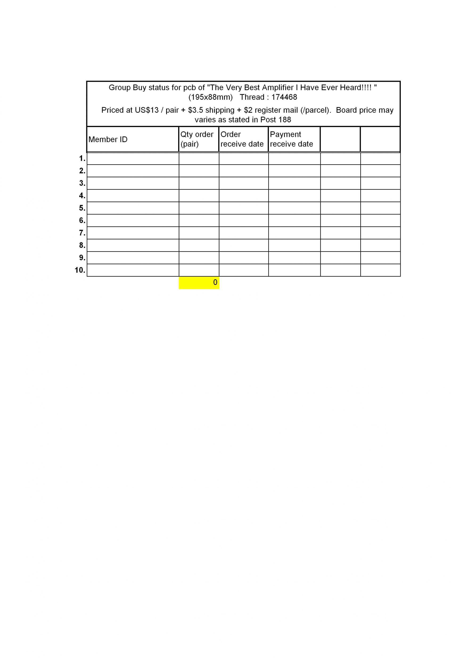

I had my running shoes ready except :
1. the slight variation in board size and if 205 x 88 is the final, I would say the ceiling price is us$14 / pair. See post 94, 187, 188 for previous approach.
2. I still have to see Alex's gerber files (top_silk, bottom, soldering mask, drill) for the boards.
BTW, the price is for the main board only. Any more info I should include on my status report? Never organized any GB before. (or unsuccessful)

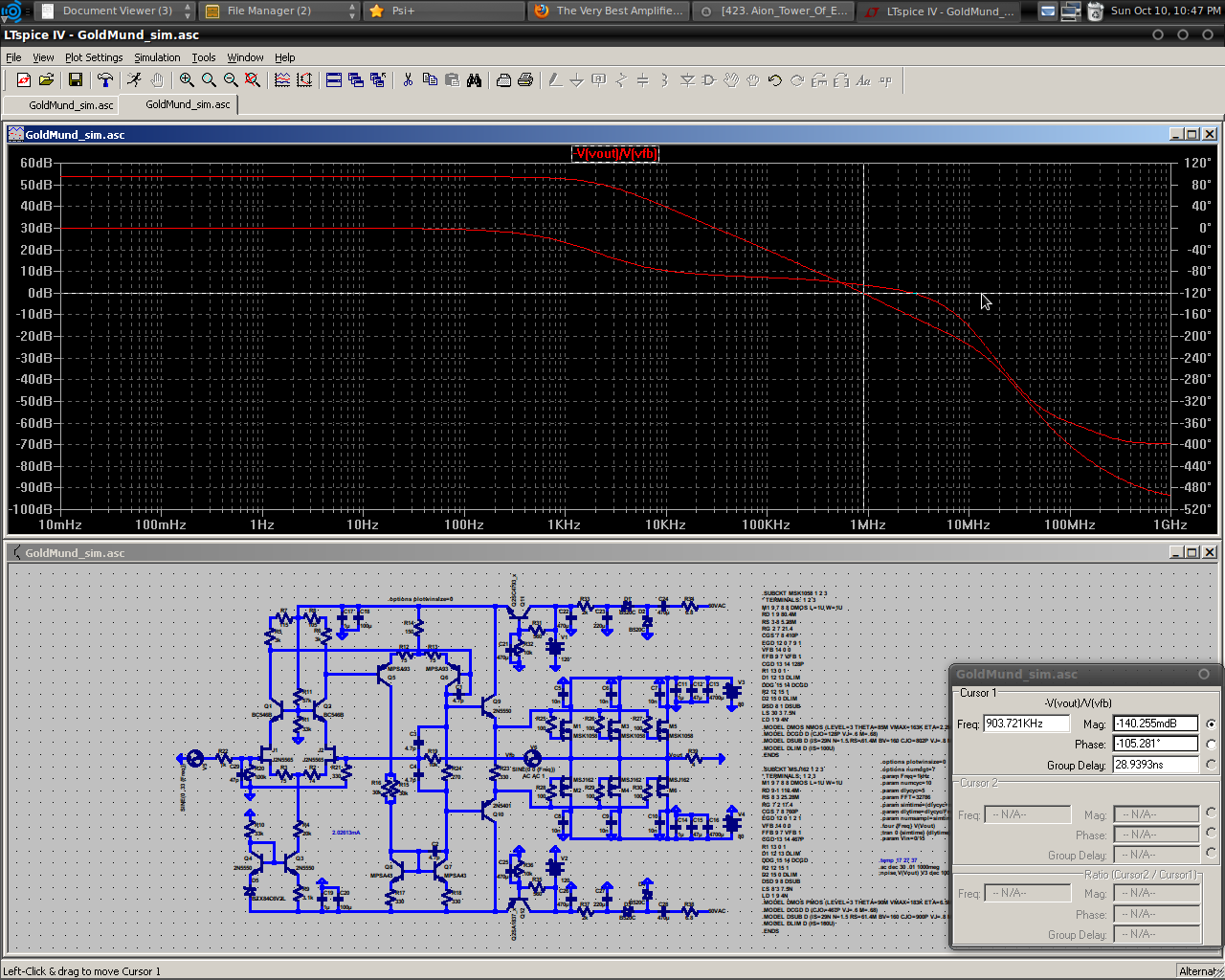

This circuit is also not unstable, barring any disastrous layout choices.
Open loop gain is a conservative 53db, with impressively well-defined HF behavior, thanks to the heavy degeneration. Phase margin is 75 degrees, which is not bad at all.
- keantoken
Oh yes, and the original CCS contributes hardly any distortion at normal listening levels, and at higher levels crossover distortion swamps it. So I opted for it instead of the "better" CCS, to stay truer to the original.
Here is the simulation package, as close as I could get it to the original. If you want the .model statements to go away you can right-click on them and select "invisible" from the drop down menu. They will reappear the next time you open the schematic.
V1 and V2 were used instead of a 60VAC source to simplify operating point solution and eliminate drift from SPICE results.
- keantoken
  • GoldMund_sim.asc.zip
