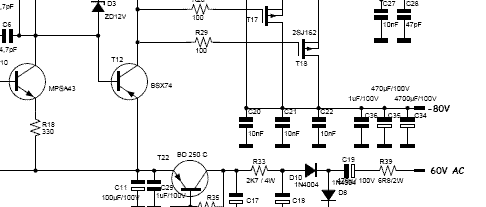

Look at the emiter of Q12

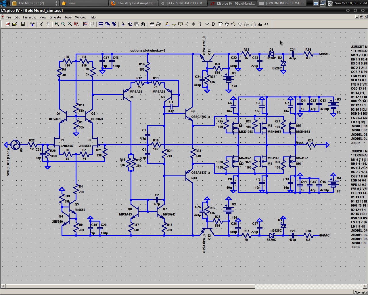

I'm going to simulate this. I SOMEHOW, it was fate I guess, managed to get the 1058/162 models working.
I am still working with the simulation, and will post what I have when I'm finished.
First, since there are no BSX71/74 or BD249C/250C models, I substituted the 2SC4793/A1837. For the BC182B, I substituted 2N5550 which seemed similar enough. I was lucky to have models for the input FETs, though I can't say if they're any good. If you know of any better substitutions and have models for them, please post.
What should the bias be for the outputs? Simulation currently shows 300mA/device, is this normal?

keantoken - The original transistors are BSS71/BSS74, NOT BSX71/BSX74. If you're ging to substitute all of these parts, then what's the point of the simulation really? Especially the input stage's dual jfets, 2N5565s. Just saying...
Simulation can only tell you basic things about how a circuit will sound, and it's been stated repeatedly that the circuit should be built exactly as the schematic. Even if we had all the right models, most of them probably wouldn't be very accurate except for basic behavior. Even the MOSFET models themselves cannot model crossover right.
So, it is almost a lost cause. But I did read someone a few pages back wanting a simulation so they could see the operating points. Simulation helps with basic design and knowing whether or not the circuit is operating normally.

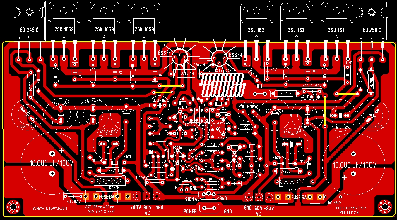

Ok everyone... Alex's PCBs look terrific in post #377. Alex, can you please post the printable .pdf files of these boards? I checked them over and don't see any mistakes. I also can't think of anything to change/recommend. Can you guys also check them over to see if you can find anything wrong? Please compare it with my original Goldmund schematic that I posted on page one. And also, any last minute changes/requests?
If everything looks good, lets move on with the group buy. Who is willing to organize this and take everyone's order?
Rudi_Ratlos might be able to organize one via PCBCART who would supply the requested and superior Electroless Nickel boards.
bigpanda can also supply the boards. Not sure about the Electroless Nickel boards.
A rough estimate of the pricing is approximately $25-$30 for a pair of these boards.
Please correct me if I'm wrong on anything and please share your thoughts.

gaborbela - Alex's PCB in post #377 is the better version. You don't have to use the protection circuit if you don't want to. The amplifier will function properly. However, if something went wrong, your speakers could be damaged.

Even if a board "looks" flawless should it still not be tested? I've seen plenty of times where a board looked good but then a flaw was found after the batch was ordered and received.
Dougie085 - This is a fairly simple amplifier, I think as long as people use original parts, there shouldn't be anything to worry about. If people use different transistors and need to change resistors for example, they can still do so without modifying the boards. If someone changes the circuit so much that they need to add new parts, then they'll have to do it in creative ways and it's up to each individual builder at that time. What problems do you think one can anticipate from this design and using Alex's board? If all original parts are used?

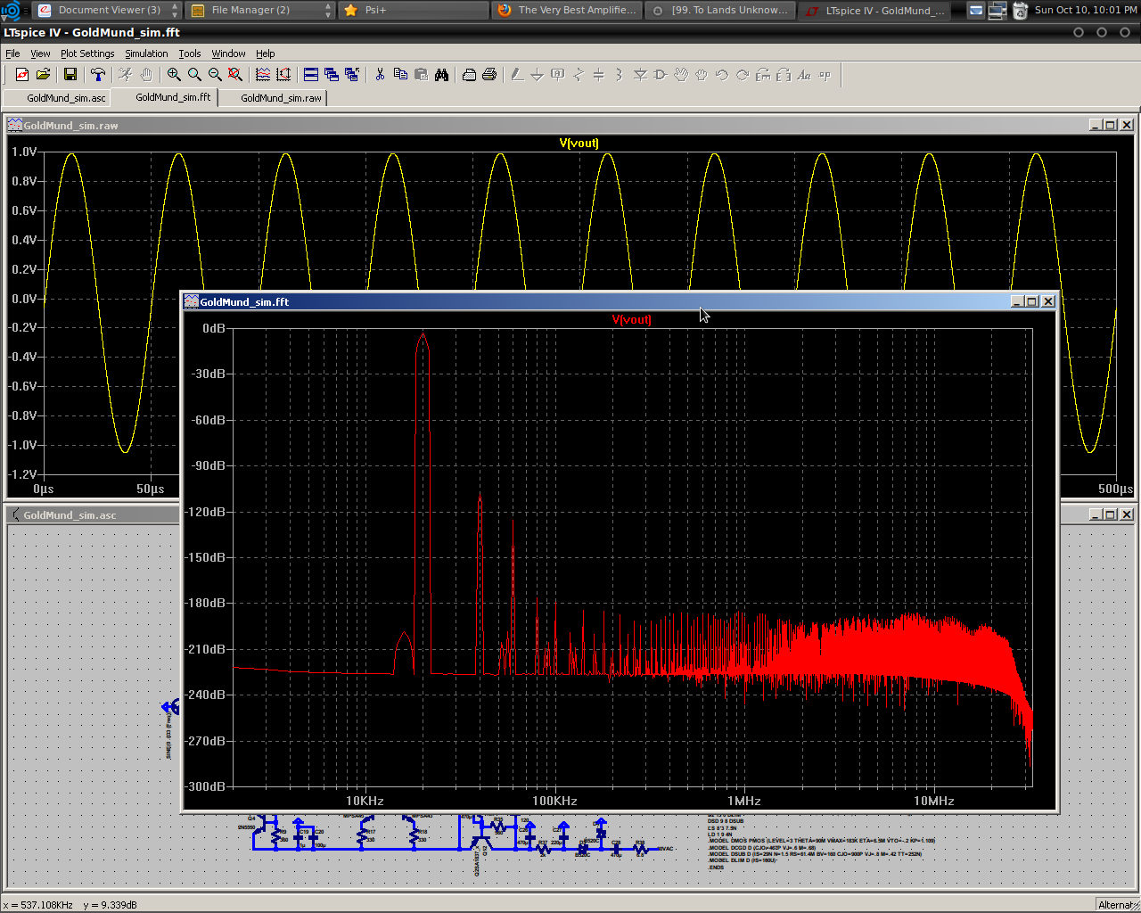

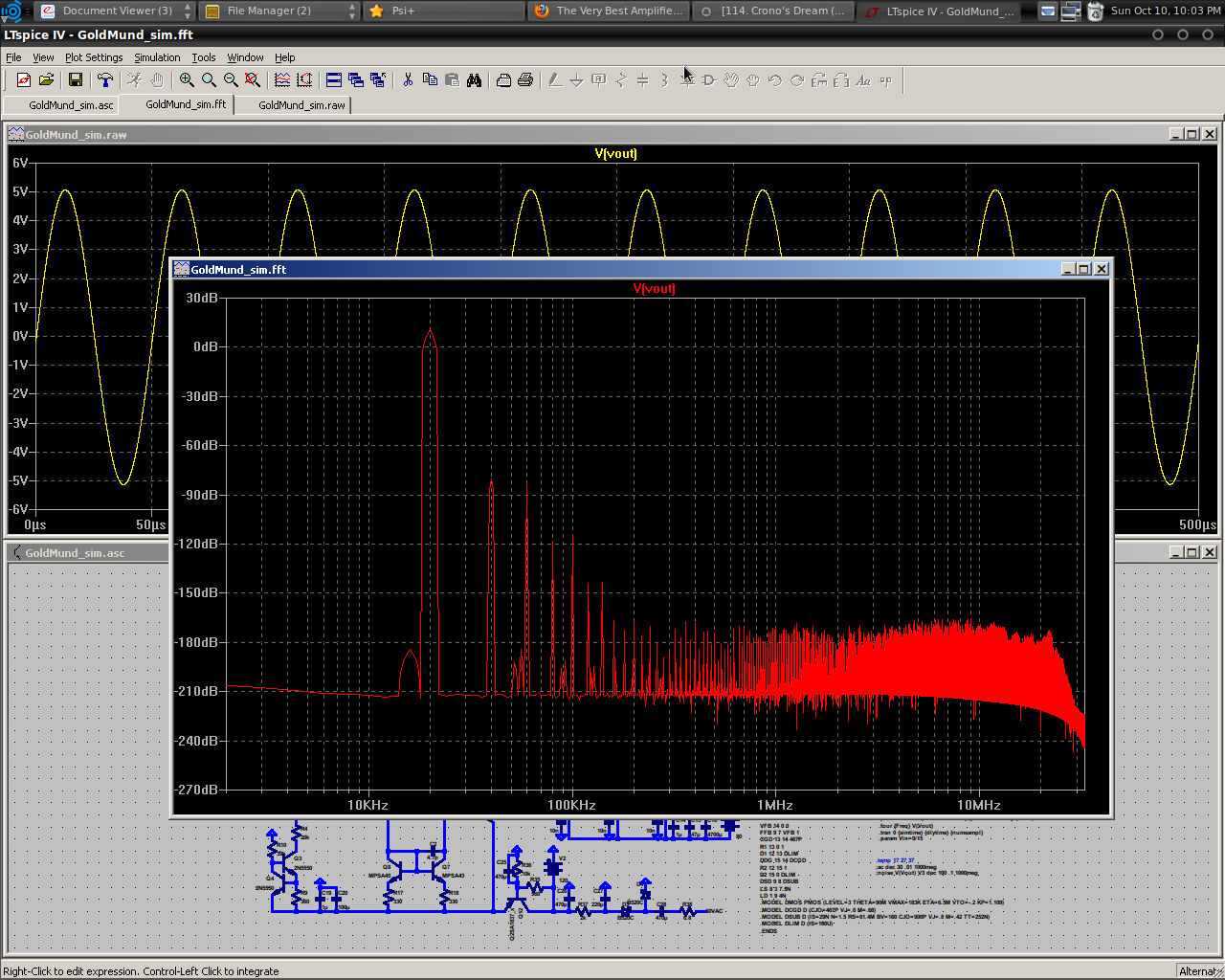

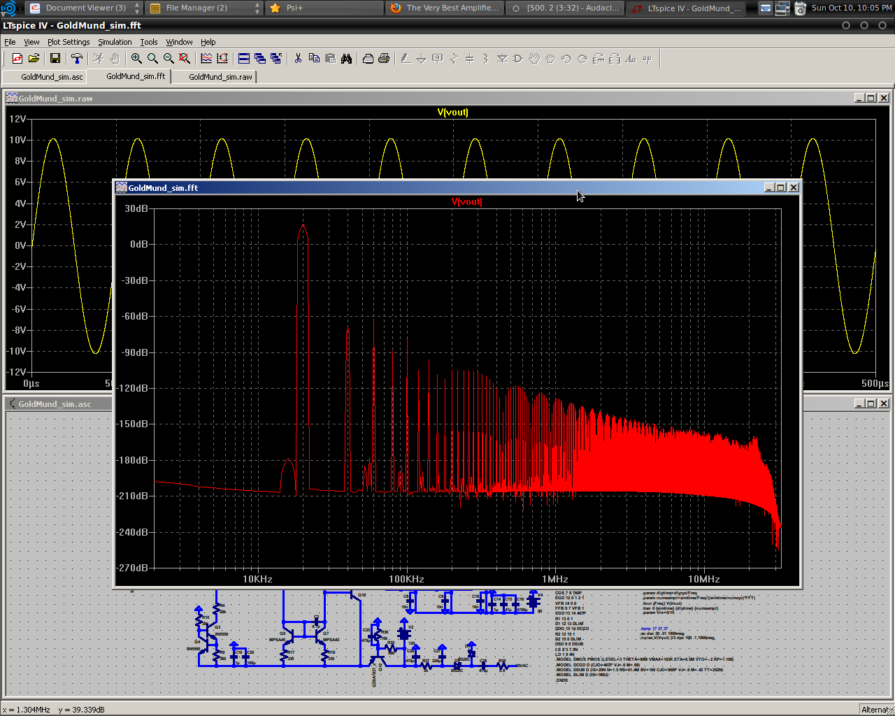

This circuit has excellent THD specs, if you don't drive it to crossover. This is one situation where testing THD at highest power won't tell you anything about how it will perform at normal listening levels.
This seems to be the difference between BJTs and FETs. BJTs perform worst at low power levels at the crossover region, and better at higher powers where the contribution of the crossover region is small. MOSFETs perform their best during crossover, giving gross spikes only if a certain power level is surpassed.
While FET's have lower transconductance, this is offset by the fact they require little drive. This way, if you can isolate the VAS output voltage from important signal areas, you will have an excellent amp.
I have no doubt this has to do with the excellent sonics. Here is the simulated spectrum at 20KHz, 1V into 4ohms. Next is 5V, then 10V. See how the higher harmonics smoothly overtake the lower ones...
(BTW, someone please tell me if I'm terribly wrong)
