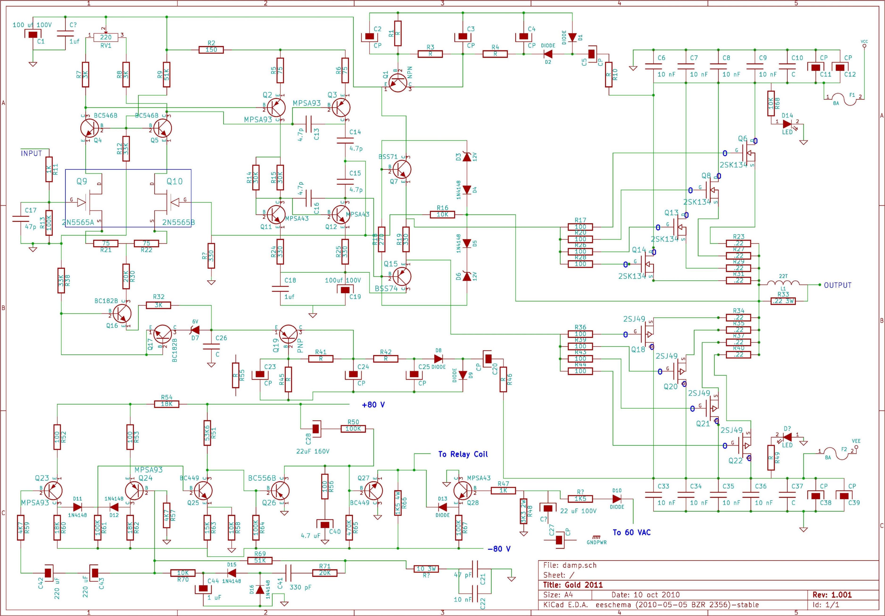

Hi Krisfr,
I can view the file much clearer now but there seems to be still some error in the content.
I have enclosed the op-amp module with a red rect. Kindly turn D7 +90deg so it joins R32 before 'leaving' the 'module'. Cannot find C26 in the original schematic.
Also add connection between 7 of module to C18, R24
Still trying to check other stuff. I will also try to make a BOM of it.

Hold on I can gen a BOM
Do you have KiCad?
I can send you the schematic and you can edit it as you like, add and or remove as to what ever the consensus is...I am willing to share this with ANYONE...
I know I don't know everything about this amp and I am willing to learn and share.
I don't know if I will take the schematic to the board layout portion of the KICAD. My brain is still stinging from the schematic layout assault.
Suggestions are wanted and welcome.

The more I look at the Goldmund schematic and the others (e.g. HMA-7500mkII), the more I like this Goldmund... I'll bet I will like it 😎
If anyone has the LTSpice file, please share it, I want to see the operating voltages and currents...

I had NO intentions of thread "hijacking" , or telling people not to build this design , I just did not feel this particular design was too DIY "friendly". Jay stated he would use parts "he had around" , but this design is much more picky than that. Speaking of this design , I did simulate it and with 22pF compensation, it was still fast and a LOT more stable. Also, there are 3 sourcings for these devices (MPSA92/42 -ON semi ,fairchild , and central semi) , all are different "creatures" with different Cob's , gains , and fab processes. This would also present a problem in cloning the original Goldmund. 🙁 The available models for the MPSA92/42 are dubious at best and might not fully reflect the final performance. This holds true for the whole Goldmund circuit's sourcing ... VERY critical.
One might say "he just simulated it" ... I would agree, but by actually producing many things I simulate , I at least can come to a close approximation. Also , (in simulation) , the FFT of the original goldmund is very close to the symasym type high order harmonics reflecting the similarities in topology.
I was thinking of creating a output board to do both laterals and verticals , so everyone could actually use "what they had around". 🙂 At that point , the voltage stage could be independently refined. Speaking of voltage stages , I have subjectively auditioned ALL the variants of the hitachi scheme ranging from the simplest (goldmund/diode based VAS CM) to a cascoded emitter follower based topology with a gain of 110db. There is no "merlin magic" , just matching the part with it's best compensation to bring forth the best sound ... all just time and patience ... and more time ... (ascertain reliability , stability) this is diy , we don't have to rush a design out the door to the market in a timeframe. 🙂
