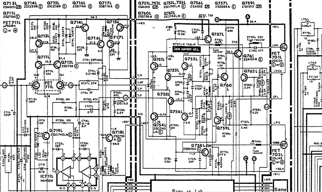

I know that.. My point is that you can take any already great sounding BJT voltage stage like luxman's hawksford cascode or your Goldmund , drive Laterals with it and it will sound all that much better.

I'm never sure where to start when I consider designing an FET amp. Only special amps can drive hundreds of nF's of capacitance gracefully (the amplifier sees hundreds of nF if the capacitance is moved up to the driver stage as in an FET amp), plus there's a bunch of self-resonance and oscillation gotchas to watch out for. It must be hard for a simulator to accurately predict the behavior of a real FET amp.
The high degeneration on the differentials means very low phase distortion, which really helps stability when there is minimal compensation. That is, if you can account for the FETs' nonlinear capacitance. But I have no experience in this realm.

'Goldmund' is HITACHI HMA-7500 from 1978 with 'improvements', my F100 (with HITACHI MOSFETs) also, you can use old HITACHI design
Thanks Apex. I think what you mean with the improvement is the "driver" for the MOSFET. I haven't built the HMA-7500 but I think I will not "like" the sound. I have built many of similar circuit arrangement, the last one is boraomega's Sigma.

Hi Os, I like your CX input and VAS stage but I'm not sure that it will be that simple to modify it for a lateral MOSFET. I'm having that "plan" to start designing my own (by first modifying existing amps such as the Stochino) but I'm afraid of burning my laterals... Or at least, I believe that it will not be that easy to get what I want to get, somebody with outstanding qualification should do it for me... Somebody with good ears, or at least similar preference...
Why 100V/us you asked? Well, tube amps don't have such slew rate but they are musical. Many modern designs are "better" (according to your criteria I believe) but not as musical. I want a musical yet "quick" amplifier... Why that much of a slew rate you will ask? Well, I know what explanantion the theorists will say but I still want it that way...
You say you have that good sounding class-A MOSFET amp? Can you make similar sounding amp in class-B? Is it not possible?
Your goldmund circuit pushes those old high Cob mpsa92/42 VAS devices to their fastest slew rate by undercompensating them. A modern voltage stage with fairchild devices (like all of mine) do not need to be "pushed to the edge" like this to achieve fast performance.
This is why the schematic posted by Nagysaudio is interesting to me (and can sound good). If you know what I mean...

Yes, I like the driver for the MOSFET in the HMA-7500mkII compared to the previous version. The front end, tho many will prefer such front end, are not important for me.
Thanks for your F100, I think I will build it. But I don't understand what kind of "improvement" you have done with the circuit. The DC servo, that's "standard". The Q7-Q8, that's interesting (I don't know why they are there), I want to know how it will affect the sound...
Add:
Actually I have tried to "clean up" the schematic for the HMA-7500mkII after somebody posted it here before (was it you?). I haven't finished and I'm not sure whether I can "clean it up" to have a "clear" schematic that I can build.

'Goldmund' compare with HITACHI look's like DIY amplifier. I share projects for DIY. F100 use classic topology, Q7-Q8 is for protect it will no affect the sound. Wahab post schematic for the HMA-7500mkII before. You can use F100 as start point to build 'clean' HITACHI.

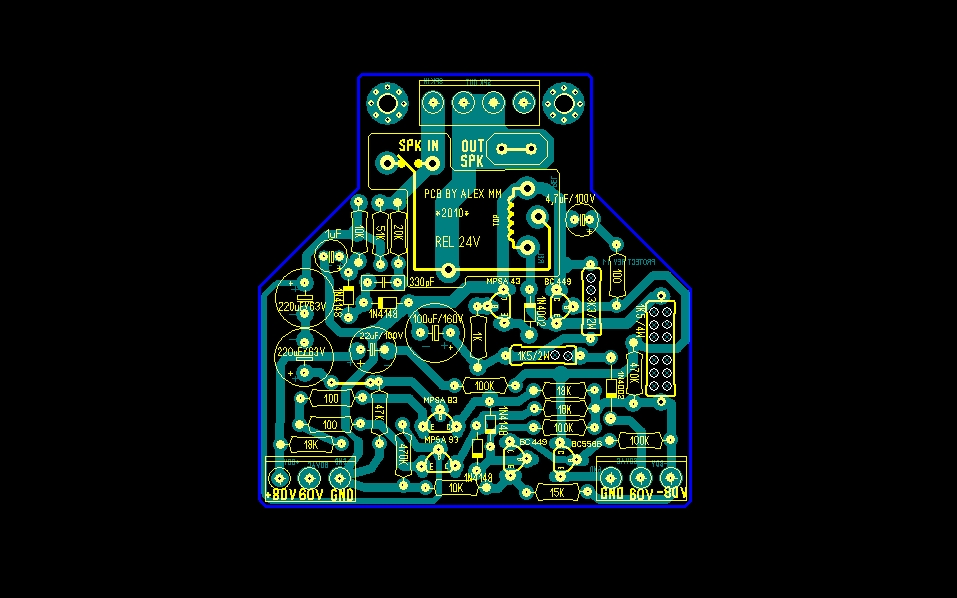

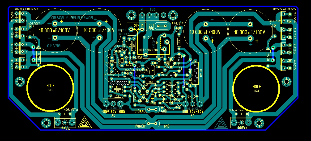

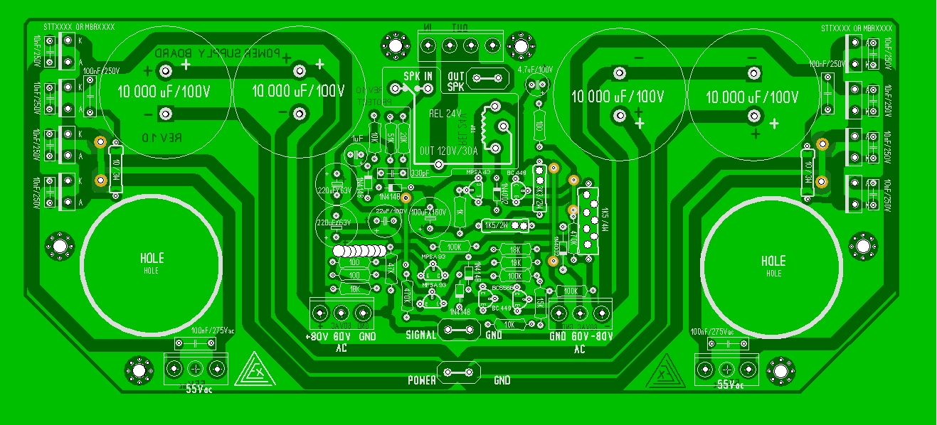

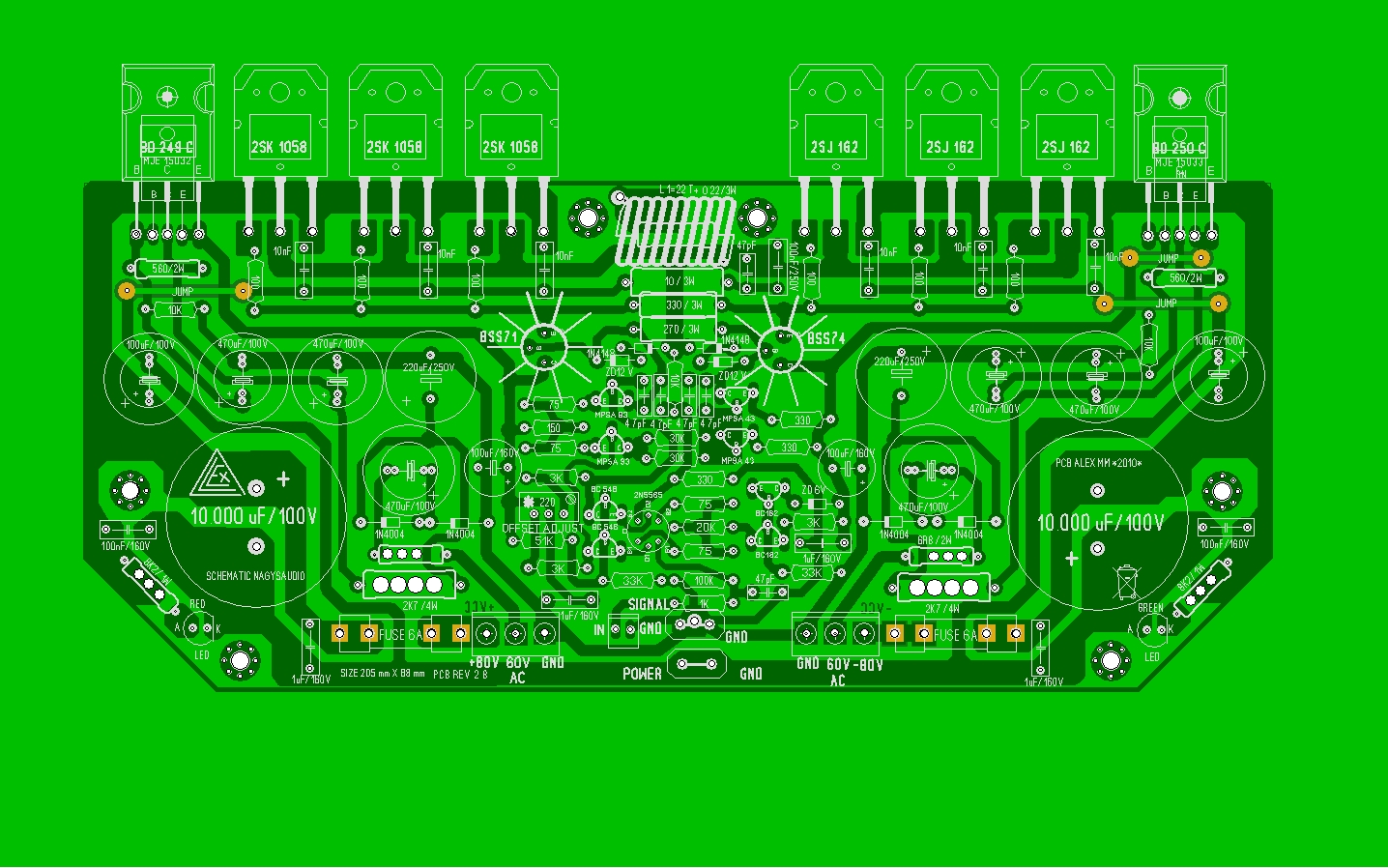

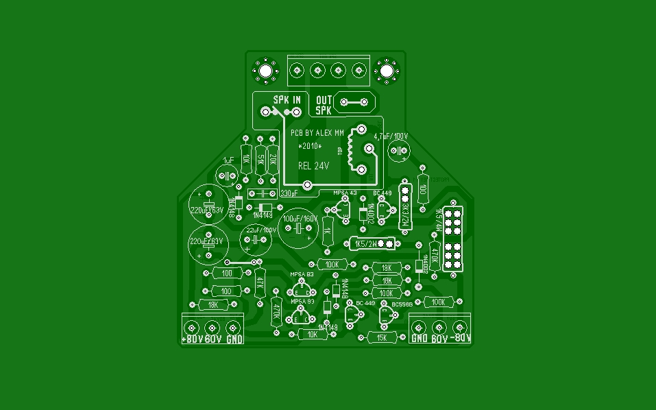

Final work PCB ....
....I think I will stop now to prepare others PCB's, because I have not much support from you , only one detailed picture would be great to have it , to make an
better layout . Until now are 3 boards , main board amplifier one , second an smal protection board and the last one PSU combined with protection board .
I doo my best , learn a lot from posted messages and means a lot for me like a
diy-er . Please dont laff about my poor english . Here is the PCB's . I have all time good intention ....
Regards Alex.
Regards Alex.
If Q7-Q8 works like a VI limiter then it is optional, and then I have built many of similar designs in the past.
