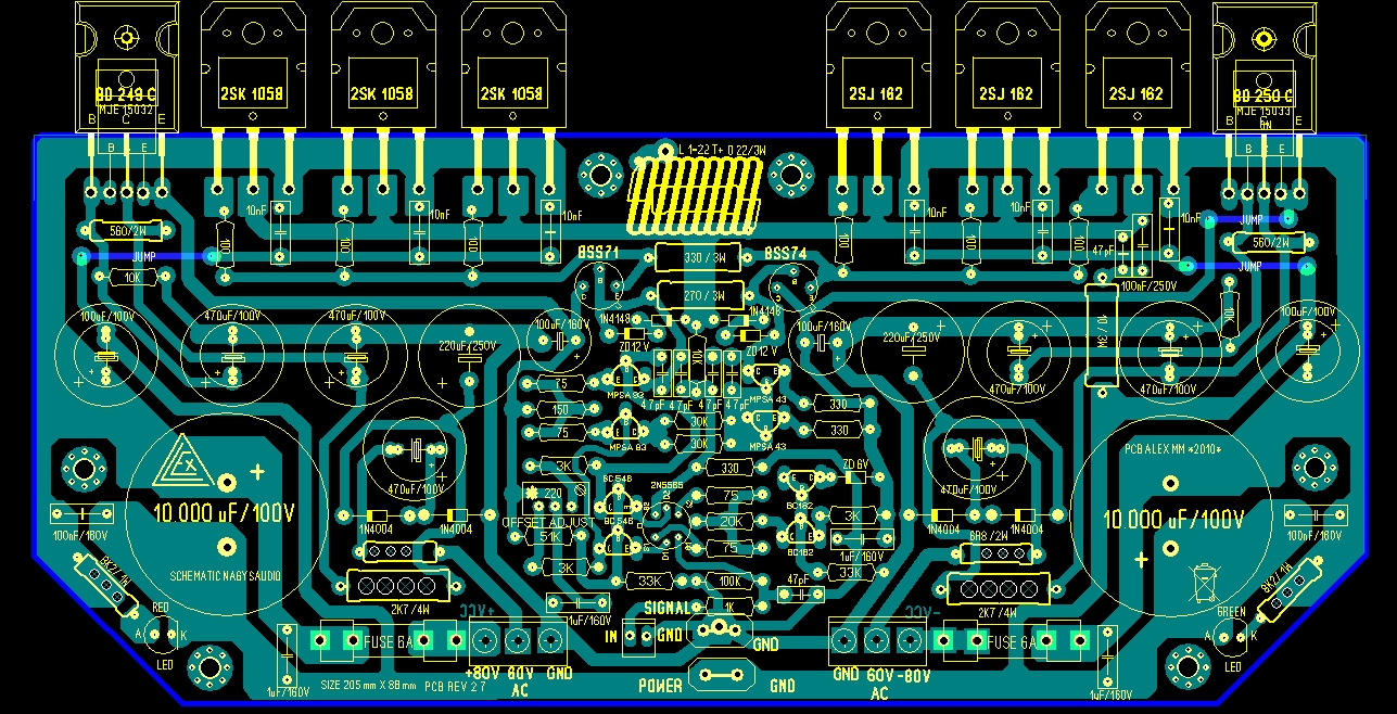

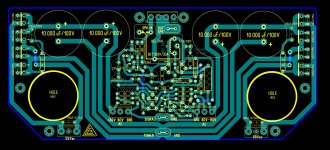

.......PSU and Protection on same PCB , may be it's missing something ......please comment as usual .I'm agree for improvements.....

Alex go to post #327, and look at 'Goldmund' pcbs.
Regards

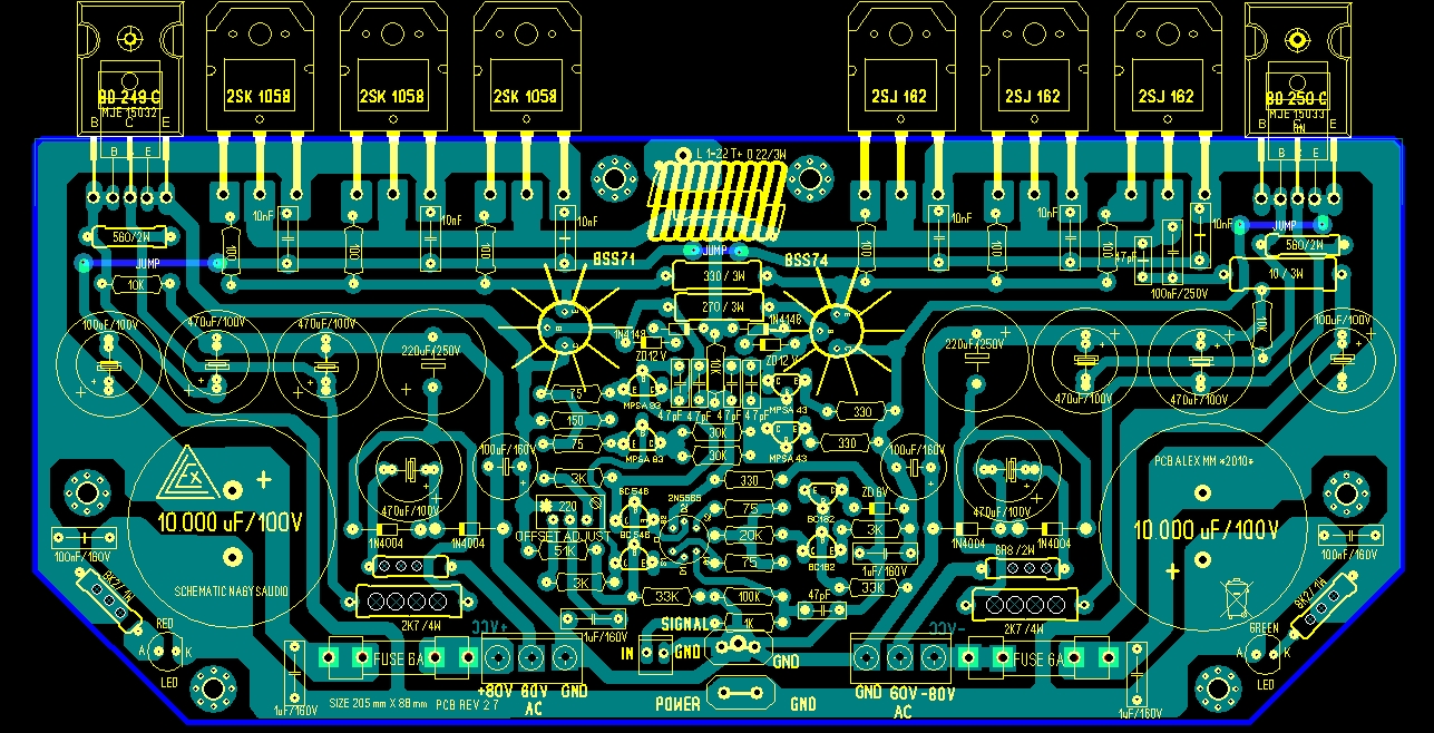

Hi Alex,
1. Can you pls rotate the BSS74, 71 +90deg and move it up so they can be further away from the 100u/160v so as to cater for heatsinks if necessary. I had some 'sunflower' shaped heatsink that takes a lot less space than the 'star' you had some time ago.
2. The ground trace was squashed by the mounting holes which can be further apart by like 1-1.5". If you do that, the ground trace can be broaden. They can be moved apart and #3 can be done.
3. If you rotate the 10000uf on the right +90, while the one on the left -90, you should be able to broaden the -ve and +ve power traces too (with the ground moved already in #2).
4. Include some voids along the power and output rails just in case you might have to reinforce them.
5. The trace after the L1 seems to be way too thin. Also can you align the 2 (1 on main, 1 on daugther, well we don't know which is which, they are about the same size now) pads.
6. Can the trace from the Source to output rail be 'unsquashed' ?
Just my 2 cents opinion.

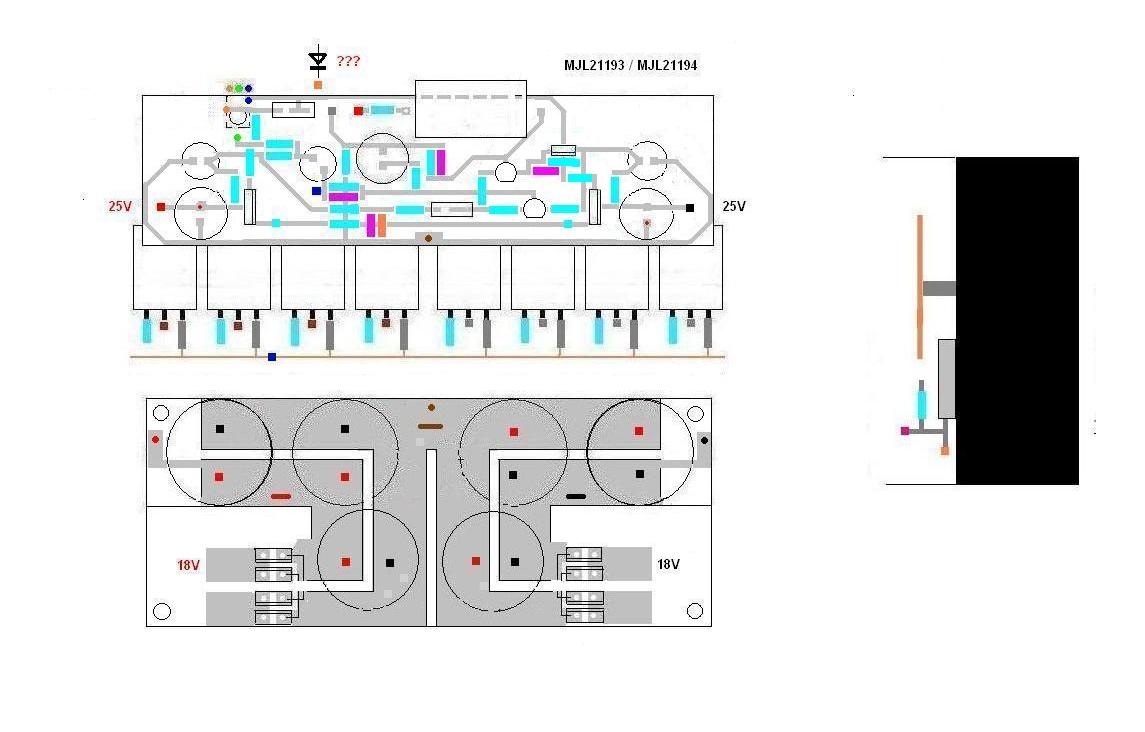

Alex you do GREAT work, I have a design I would like to have you work on TOO.
"The Very Best Amplifier I Have Ever Heard!!!!"
Im by far not so smart and experienced as you are
and its a much much simpler curcuit
I moved outputs away from board, which means hardwired
turned everything on board upside down
And it did seem to make a few things much simpler
noteworthy is that the board doesnt need any high power rails
a ground lines are very simple
well, as said, its a simple design
one other option could be yet another simple board for the output devices only
a bit like Nelson's Burning amp designs
With his FirstWatt design he has also shown how a long slim board makes a neat and practial design
if nothing else, at least it wouldnt need very "high"(long) heatsinks
much easier to find a standard sized box with heatsinks, and cheaper
in other words, think more about final mounting, and the needed box design

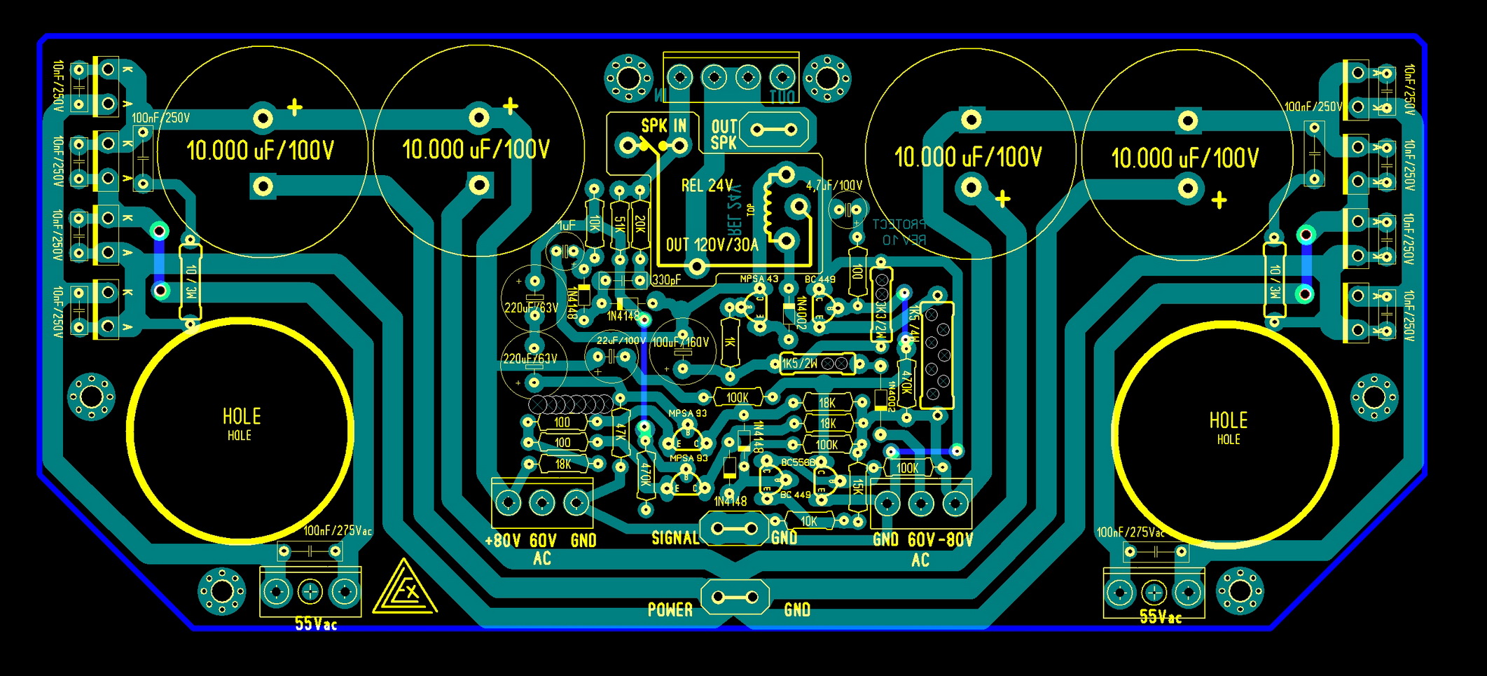

....Hi , Mile -the picture it's too small and not clear to copy the layout .
Bigpanda - correction of layers done , picture posted 🙂
Alex

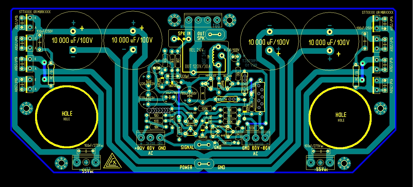

One more thought... What do you guys think of the Zobel's location on this board? I think it should be right next to the series inductor on the output. Also, one wire will go from where the series inductor is to the + speaker terminal and then the - speaker terminal will connect to the ground, which is located on the other side of the board. I personally would prefer that these 2 connections were right next to each other. Just small nitpicks, but never the less would be nice. Not sure how difficult it would be to incorporate this into the PCB's design.
Alex's PCB is the one I like the most by FAR because the power supply should be on the same PCB, just like in Alex's design and the MOSFETS should also be mounted on the main PCB. 🙂
For alex mm,
You need to stream current to filter capacitor pin, not around them, like this ==>pin<==
