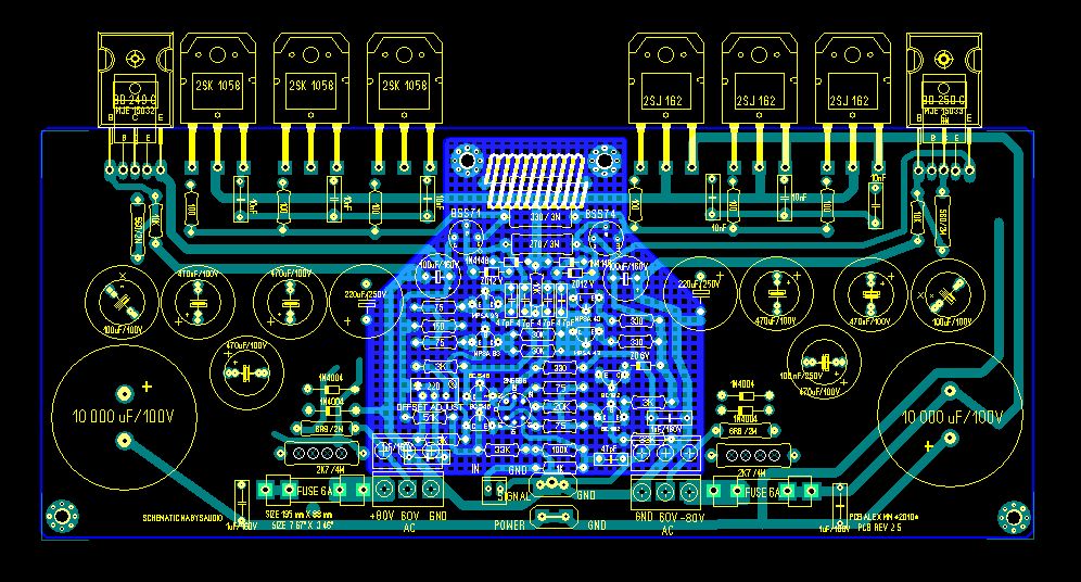

gaborbela's Renesas/Hitachi 2SK1058s were not fake. Looked real to me in his picture and probably were. Why would they be fake? They're available everywhere from official distributors and are affordable. Why such a long discussion about them?
But the Chinese Goldmund clone kit from eBay is a POS. Simplified schematic, updated with new parts, etc. It's actually a half pieced together clone of the following Goldmund amps: SRP, mixed with SRM, SRM2, JOB 500, JOB Mono, JOB 300, JOB 150, JOB Stereo, SR2, SR3 and a few others that I can't remember now.
This clone is in no way or shape a clone of Mimesis 29, 29+, Telos, etc. These amps have serious power supplies and all kinds of other upgrades.
This clone I would personally stay away from, especially when I posted the REAL Goldmund schematic.

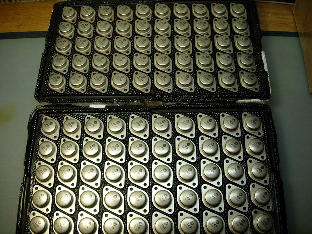

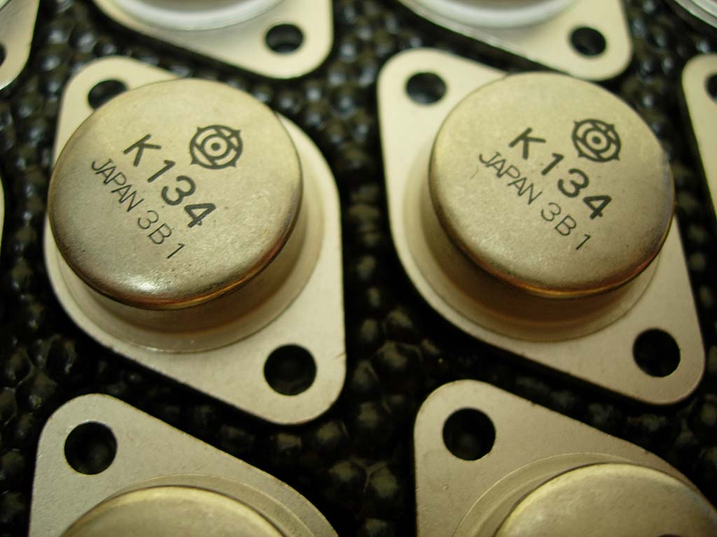

NagysAudio Get hundred new and used Hitachi transistors TO3, TO220 etc and no one is write Japan . All is 10years and older. May be the latest one are?

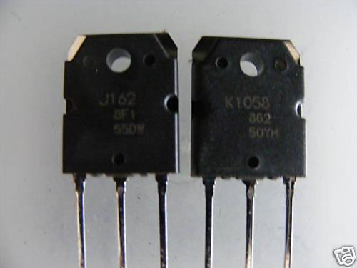

I don't know why so hard to believe for some people.
When I clearly stated it was tested , com pared with Renesans , laser marked Hitachi .
All I can say I prefer the Hitachi.
I do not say Renesans are fake! But there are many fake laterals made under Renesans name. At least I see many on the Ebay!
There is no Goldmund on Ebay , just a preamp.
Lets make it clear , I do not care about the amp name , or how old design. I care about only the sound and to be safe to use it!
Nagy you right, I sow many Hitachi marked Japan .
I did some work to a TV repair man 5 years , (actually he repair everything) there I sow some Japan marked Hitachi! Yes it exist!Praudio he just want to sell his TO3 can Hitachi device to me!! HA HA HA!
But I'm not a buyer.. I prefer flat package...

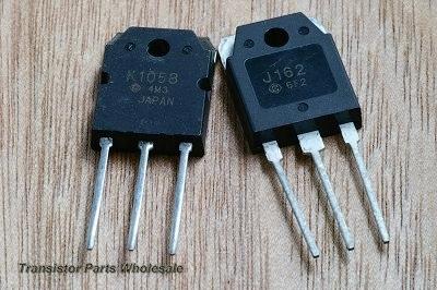

I attach two more picture , one laser marked 2SK1058 Japan Hitachi, the 2SJ162 probably fake! Because the case how it look (but not sure)
Another picture fake Renesans, I would not buy those not for a dime!
You can find more test on the ESP site about fake (Chinese) Renesans .
I do not say the orig Renesans fake , but there are many counterfeit device , Hitachi, Toshiba , Sanken and so on!
I try to avoid Ebay semis.
Also I com pared EXICON laterals and in a simple schematic like ProFet , Zenotron I prefer those. Somehow the JFet drive them better!
Many guy tried F5 with Renesans laterals with little success!
With these I van to close these nonsense topic!!!Please guys!

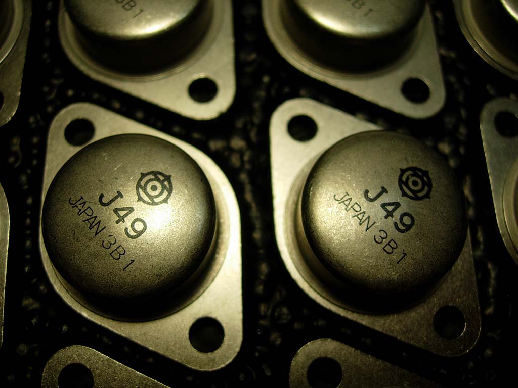

Antique collection is my religion.
They all say "Japan", "3B1".

Holi Gezus, are those the original ones ? 😱
(hard to believe those are Geneva made)

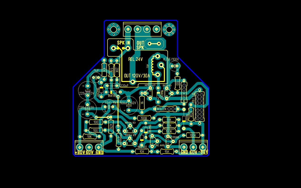

Protection board for Gouldmund amp.
.....It seams ,to be complicated ,ading protection circuit ,in main PCB , so will be an PCB protection mounted , top side of the main board ,in central position .🙂

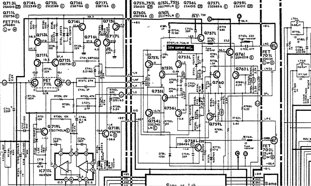

My FIRST diy back in 92' used those. VAS was hitachi inspired with 47pF CDOM's. Did not have to ground heatsink and laterals were run to PCB with WIRES. No squirrely "on the edge" circuit here , just absolute stability and beautiful sound all around. 🙂
If I remember right it was very similar to my CX/symasym without the VAS cascode (18K resistor instead). They ran the VAS real "hot" (20+ mA) like otala did with large heatsinks for all 4 voltage stage trannies (4 X MJE15030/31 ??).
OS

Are you making use of the 2 "3 pin power posts" as mechanical support? what about the 2 mounting holes on the protect pcb? where will they go onto the main board?

The idea to add the protection circuit as a separate board is brilliant. If you do not need it or want it you can use something else. I try to use a little common sense with this area to somewhat simplifiy assemblies.

Protection board position ...
Hi Bigpanda ,
Will bee something like in the picture , the blue hached PCB , with 2 holes on main board and in front with two 3 pins power connector .Main board it's not ready , I'm working on it. ......

Surprising, isn t it ?......This date back end of 70s, very early 80s..
Nice big 68pF (c712l) ... I guess what works ... works ?? Japanese deserve much respect , good practical , reliable designs. NO "false gods" ..voodoo mumbo jumbo , same for the luxman .. not a "hawksford cascode" , but a "luxman cascode". A world full of shameless IT "pirates". 🙁
OS
Going Japanese by adding a proper output stage bias thingus might be the wiser.
The output stage devices in the Mimesis do far less than 100mA quiescent current. Some like that, some really don't.
