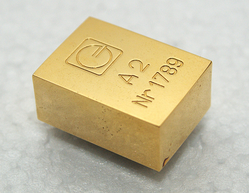

tommy1000 - A2 module is identical to the older A1 module. The only difference is that Goldmund uses surface mount resistors on the A2, they're on the bottom of the board, you can't see them in the picture. While the A1 module is all point to point soldered, no circuit board inside. I took apart both modules, I can post a picture of the A1's internals if anyone's interested.

I would appreciate a nice close up of the A1 module you so nicely chose to offer.

tryonziess - I have built and sold 2 of these amplifiers. Both with cheap circuit boards, nowhere near what Alex has created. I also personally own Goldmund Mimesis 3 and Mimesis 6 amplifiers.
I will post a picture tonight, when I get home from the office of the A1 module.

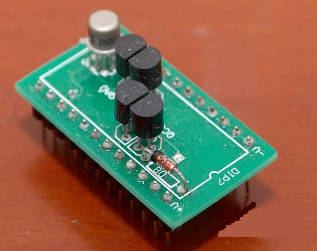

Would not a dual jfet be a better choice for the discrete OP amp than two separate jfets.
A DIP8 NPD556* is significantly better than a TO71 2N556*.
A-Because the NPD are monolithic dual JFETs, the 2N5564/5/6 are two JFETs in a can.
B-Because plastic is better than metal hats. Don't trust me, ask the RF-headrooms Phred and/or Jocko on the beach.

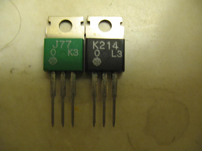

Gaborbela; your K1058 is really a fake one. Get some from different source(15 years ago) and nothing look like this.
Hello
I'm very happy with those fake mosfets.😀
They sound better than the original Renesans!! Thank God!
I meet several Hitachi device marked white , even black on the green plastic case.
I do not want to argue over these! I have no time for that.😀
I know what I purchased ,I have laser marked Hitachi , Renesans . These was tested and com pared with them!
I do not feel I have to prove the originality to anyone!!!!
But I like people who think because they never sow something that not exist or fake!!
Please do not take it personally!

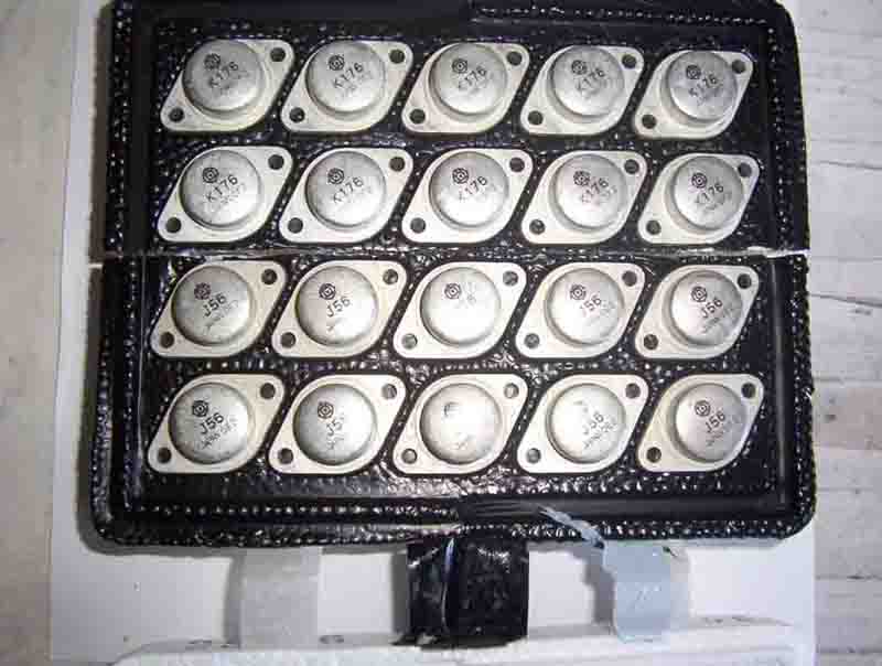

Some more fake Hitachi.🙂

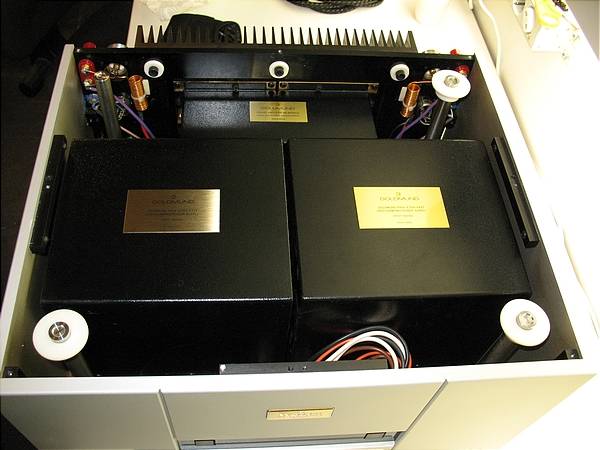

Some detailed info from the Goldmund 29M .
GOLDMUND MIMESIS 29 et 29M
The pictures I received from Mr. Wathara similar like these but that was the mono block verizon!
That had only one transformer , at least had one transformer cover.

Tomorrow I will buy more , actually I need one more 2SJ162 to have all the matched pairs I have a need
Also my fried use it in a Class A amp 20 or 22 rail voltage 1.2A...Just sound fantastic, even tube amp fanatics agree on that.
