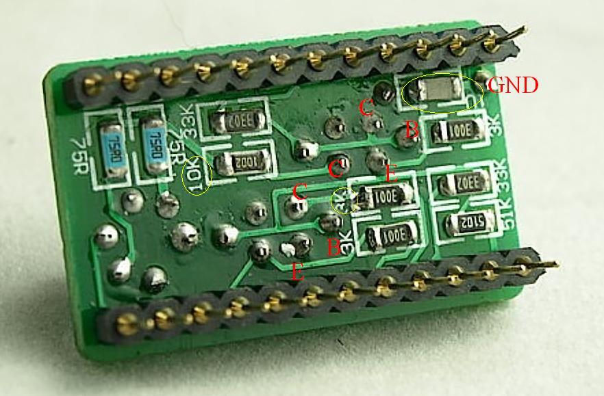

tommy1000 - False, as you can clearly see in that picture. You mislabeled the transistor's legs. BC182B only comes in the following configuration and always has: Leg1=Collector, Leg2=Base, and Leg3=Emitter.
I don't understand why this is still up for a debate. If you would like to short Collector/Base instead of Emitter/Base, please by all means go ahead an do so. The PCB does not need to be changed. Just rotate the transistor 180 degrees and solder it in backwards. And then possibly watch your project fail.
Looking at the other two transistors in that picture, maybe Goldmund is using MPSA42s. They have the reverse leg configuration. They have used MPSA42s in some of their newer modules. I don't have it on had, so I can't double check. Maybe if they're using the MPSA42s they short the Base/Collector instead of Base/Emitter.
In the original A1 modules, like the ones in the schematic on page one, BC182s Base/Emitter was shorted 100%. I'm holding this module in my hand right now and it's plain as day. I have three different modules for comparison. The transistors are all Motorola.
I would only recommend building this amp like in the original schematic. Of course each and every builder can experiment both ways and post your results. But can we just put this argument to rest? Everyone can build it as they choose. But the original schematic and PCB board labeling should remain the Goldmund way.
Those could also be the Goldmund A2 modules. A2 modules did use updated MPSA42 transistors. If anyone builds this amp and uses the newer MPSA42 transistors and shorts the Base/Collector, please CHANGE THE BIAS RESISTOR!

I think that they have used the BC182L instead. The pin configuration fits the board and it has twice as much Ib as the B version, this may explains why they have a lower the valu on R11 to 10k. They have also added a 1u ceramic capacitor across the zener diode in this module. If anyone is interested they can simulate this.

This would make sense and tie in with the fact that it's totally pointless to short base to emitter, but to short base to collector makes a useful temperature sensing diode.
