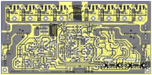

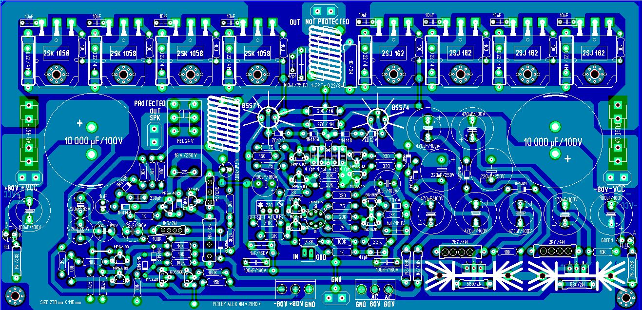

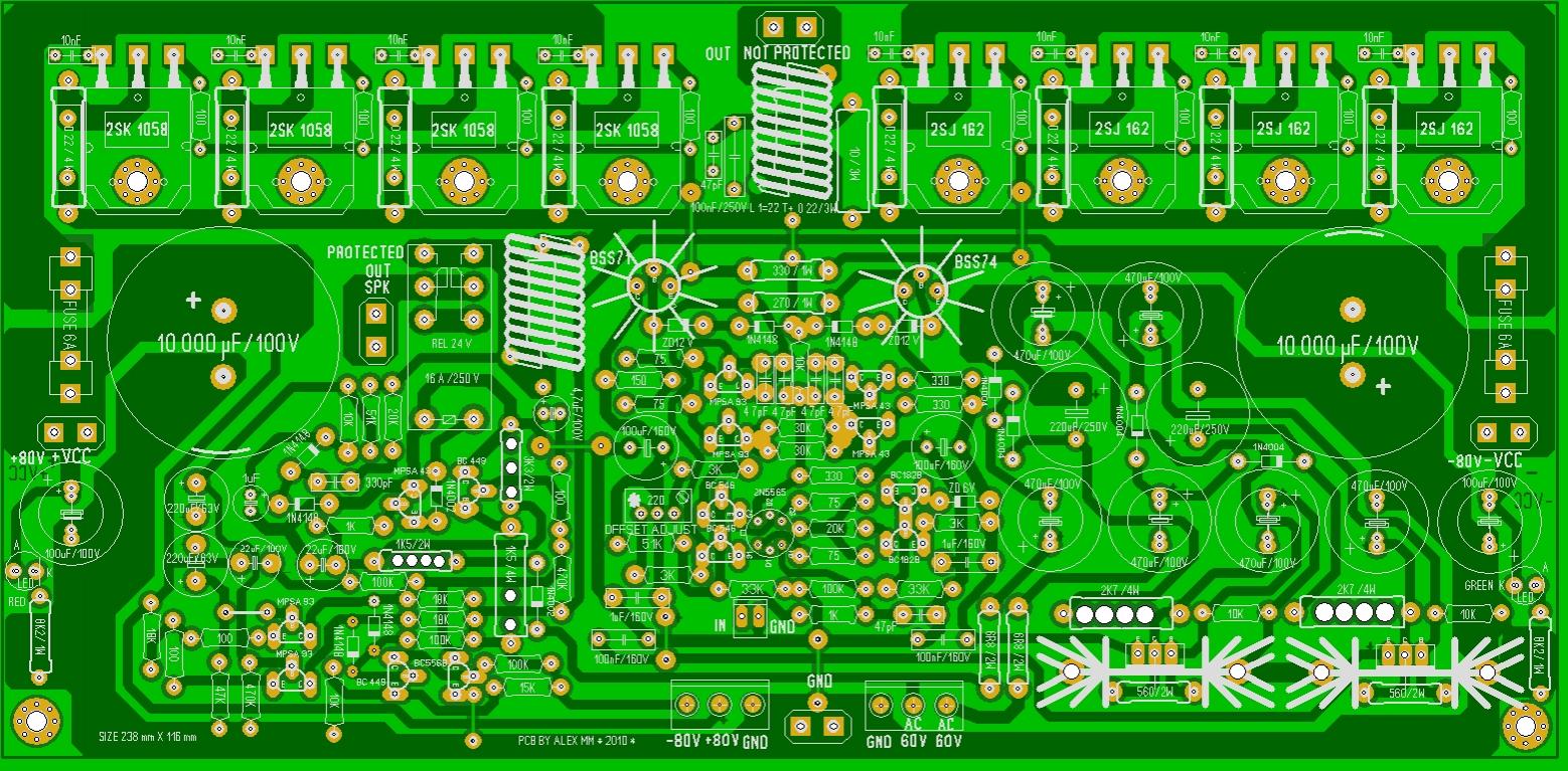

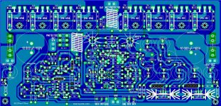

PCB main amplifier + PROT + PSU
Hi, as I say few post ago , PCB with PROT and PSU so , here I am 🙂 glad to share another bad design full of errors .Somes comments are welcome to make necessary corrections until final PCB . I'm sure you do not like the location of the final transistors , and not only this . I'm ready to draw again , in other way if you don't like how it looks my PCB .
Alex.

Eye candy is right..............
Keep up the good work Alex, you have talent. :hypno2::hypno2::hypno2::hypno2::hypno2:
Jam
P.S. If I were to build this board I would keep ac away from it, let rectificion and voltage doubling occur somewhere else. My :2c:
what's there not to like 🙄
with spacers between board and transistors to releave the stress it should work nicely
and the board could easily be turned around with transister at lower half of heatsink
looks perfect, exstreme 😉
any ideas about the lowest possible voltage that will work 😕
Alex, the board is looking good! I see you have provided two different places for the speaker output, one protected and one not protected, I like that. I'm assuming that most builders will use the protected output. In addition to the series inductor, can you also please locate the output Zobel next to it? They really should be together in the same place. If possible, can you please update the following few things?
1.) Is there any way that you can make the tracks for the 60VAC larger? Especially the points where the power supply connects to?
2.) Can you make it so that the original parts, BD249C/BD250C will also fit?
3.) The fuses should be between the 100uF and 10,000uF capacitors.
4.) Any way to run the -80VDC to the protection circuit, the other way? Maybe first going down and around the circuit board. I don't know if it's good to run it straight across the input stage circuit and right over the negative feedback trace.
5.) And lastly, can you please make the +/-80VDC connection points next to each other (so they're not on the opposite sides of the board) and closer to the bottom, where the 60VAC connection is? This way, power supply wires wont have to be run to different sides of the board and right over the circuit.
Thanks!
