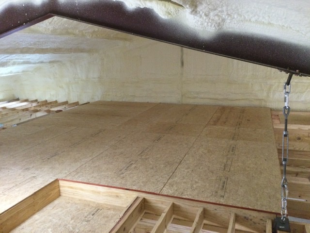

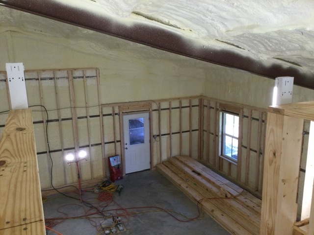

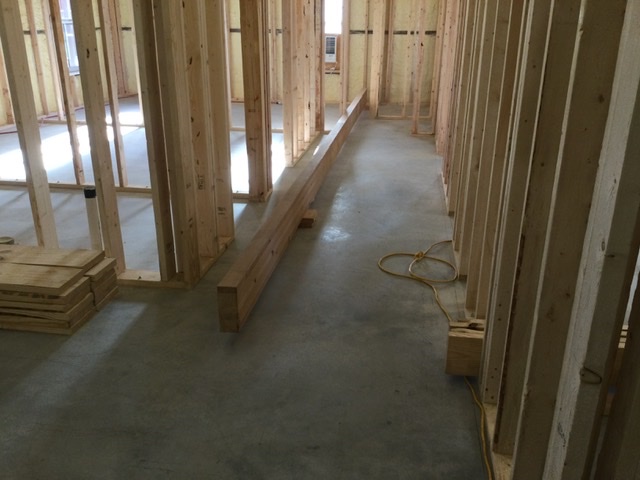

Now beginning to look like something. And hey, I didn’t have an 11-1/2 foot tall 2x6 wall pin me underneath it yet. Now to get the ceiling joists, decking, and two engineered beams ordered and in here before the flooding rains soften up the driveway too much for an 18 wheeler.
It WAS raining this morning when they dropped the batch off. The lam beams are coming early next week. They can bring those in on the smaller truck. The stack of PT is for another project - just made sense to get it all at once.

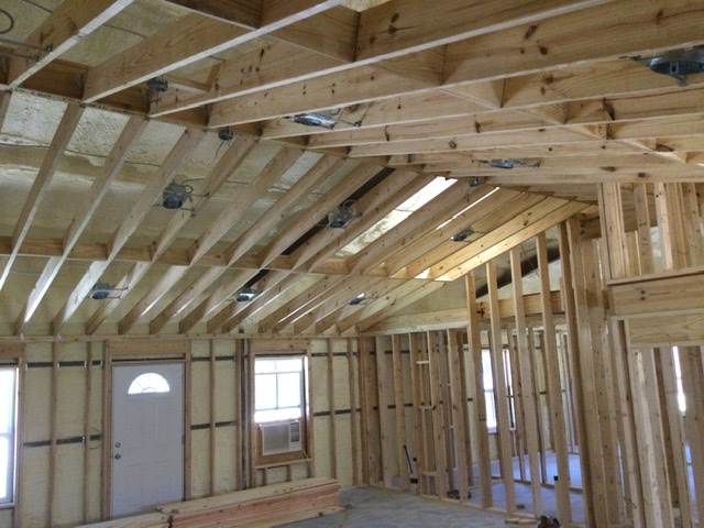

Got this milestone out of the way today. Had to walk that sucker up on speaker cabs, with some safety rigging in place. Now I can finish the beams for all the flat ceiling, and floor of the attic storage room.

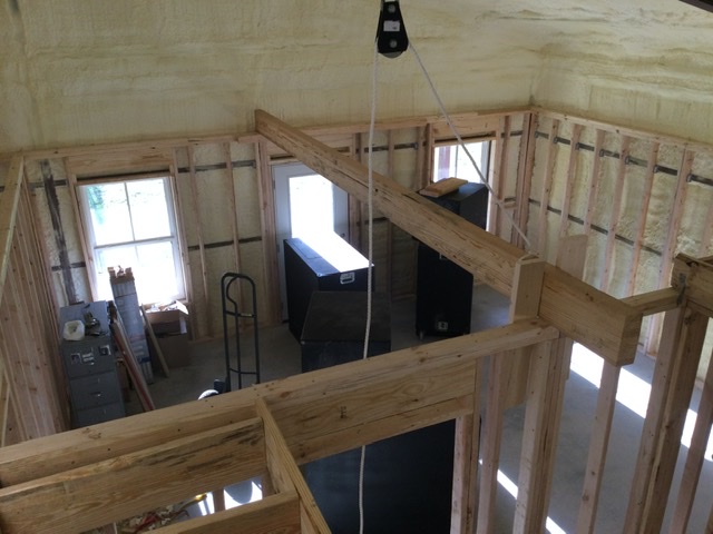

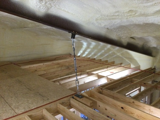

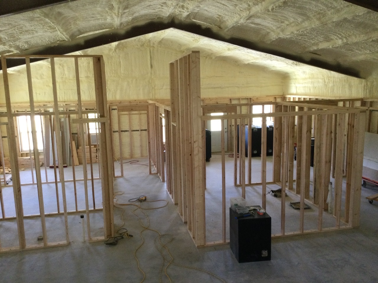

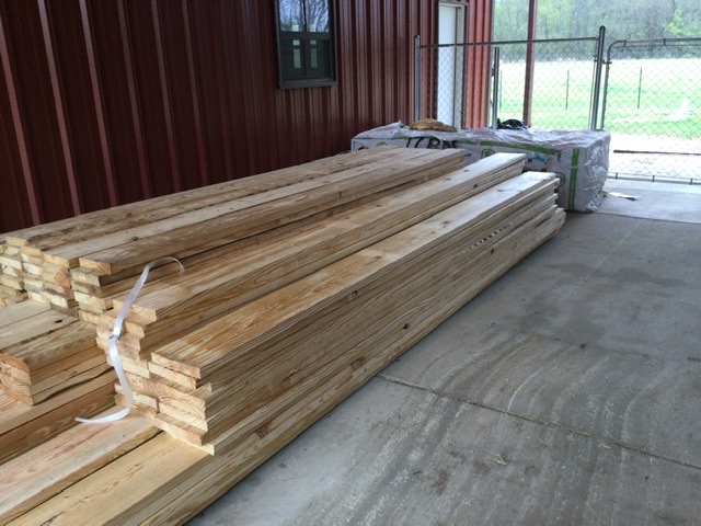

The bigger one (26 ft) at the center of the vaulted ceiling is going to take some rental equipment. Got 2 grand in the budget for the rent. Need some hydraulics. Plenty of work to do in the meantime.

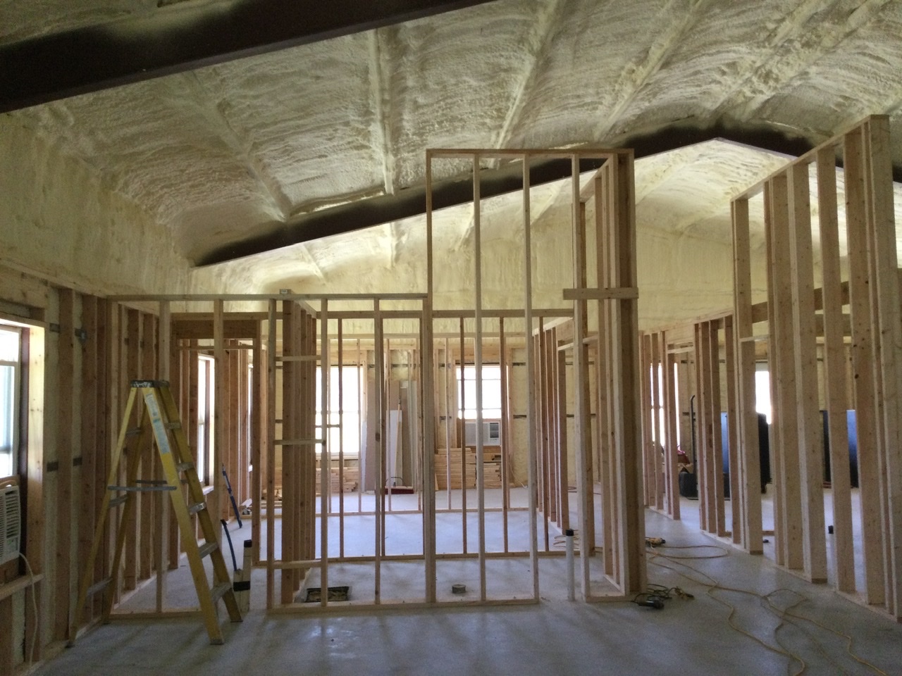

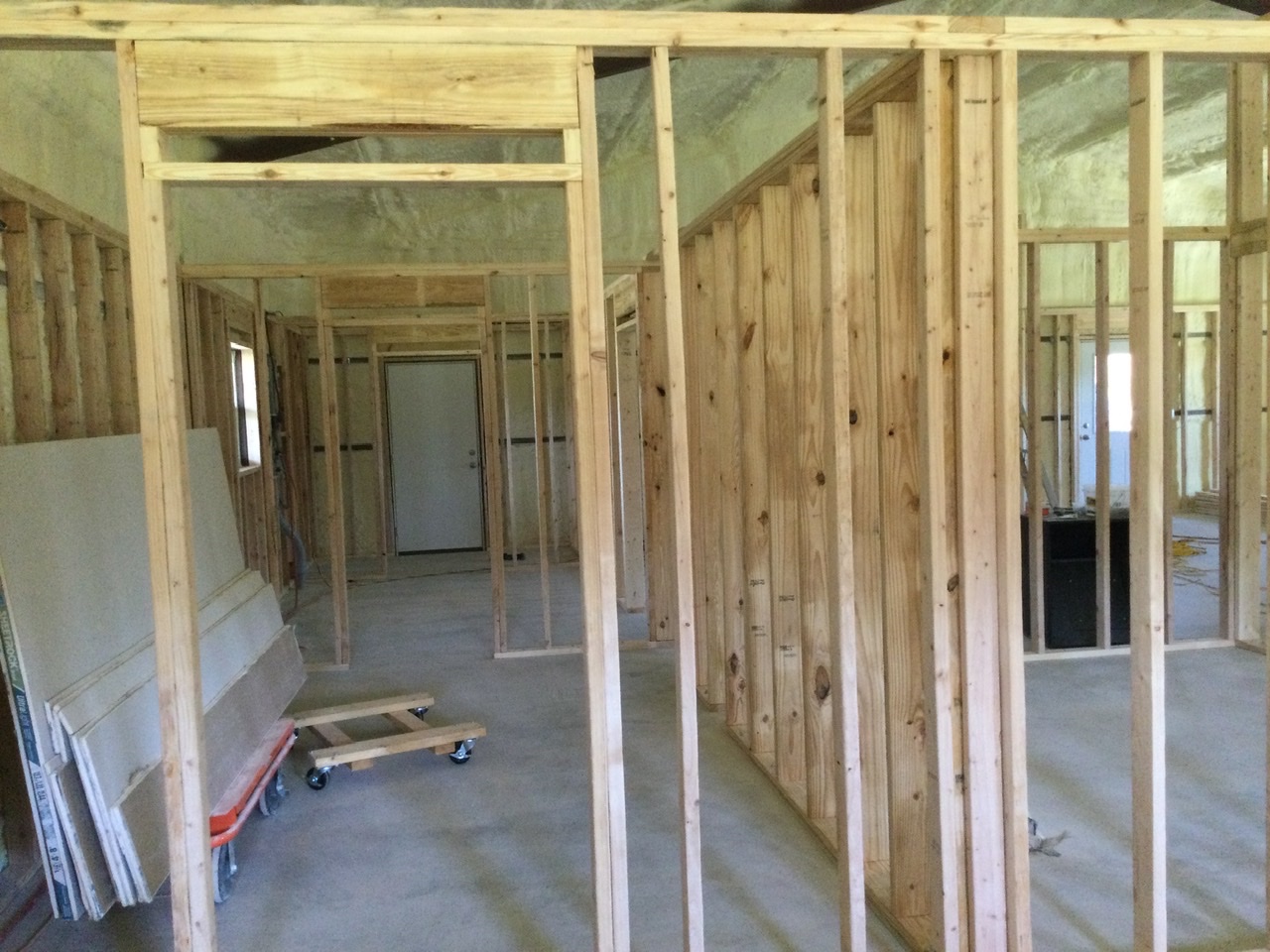

Now the rest of the 2x8’s are up. Put in the can lights and a couple of ceiling fan boxes while I had the scissor lift. Structural part of the staircase is done now too. The only framing left is the 13x16 attic room with a low ceiling, and the open part of the hallway ceiling that the AC unit has to go up through. The opening is bigger than the stairwell, which should make it easier to send up an air handler and furnace. While I was at it, added additional support for the bedroom ceiling. Gets some of the weight off the bathroom wall. The big lam beam at the center of the vaulted ceiling is now completely supported by the two big steel I-beams - pulling UP slightly on the walls.

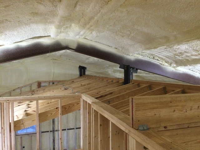

So you have a cathedral ceiling under the attic, huh?
And, I've never seen a chain used like that. Normally that would be a solid piece of wood or metal. How will that allow flex? During a high wind?
I thought you were doing post and beam for the inside walls, supporting the laminated beams?
Nice layout, btw, the metal bldg means few worries about termites and have a building within a building should make it quite quiet inside, huh?
Since the insulation is on the inside of the roof, not on the ceiling, your attic will be heated/cooled too? Is it tall enough to use as a room or only as mechanical room and storage?

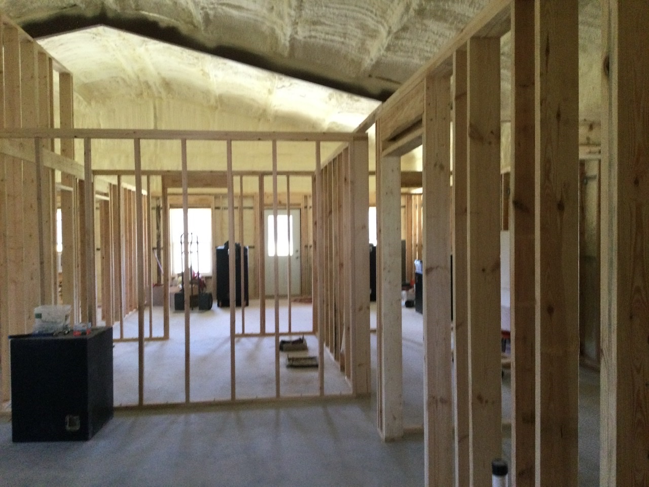

Glad to see your coming along with framing etc. Interesting construction methods.

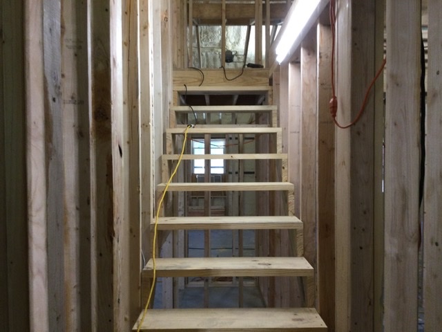

The stairs look interesting. How do you plan to finish the walls? drywall, wood? If so, it will be fun doing all those cutouts around the treads.

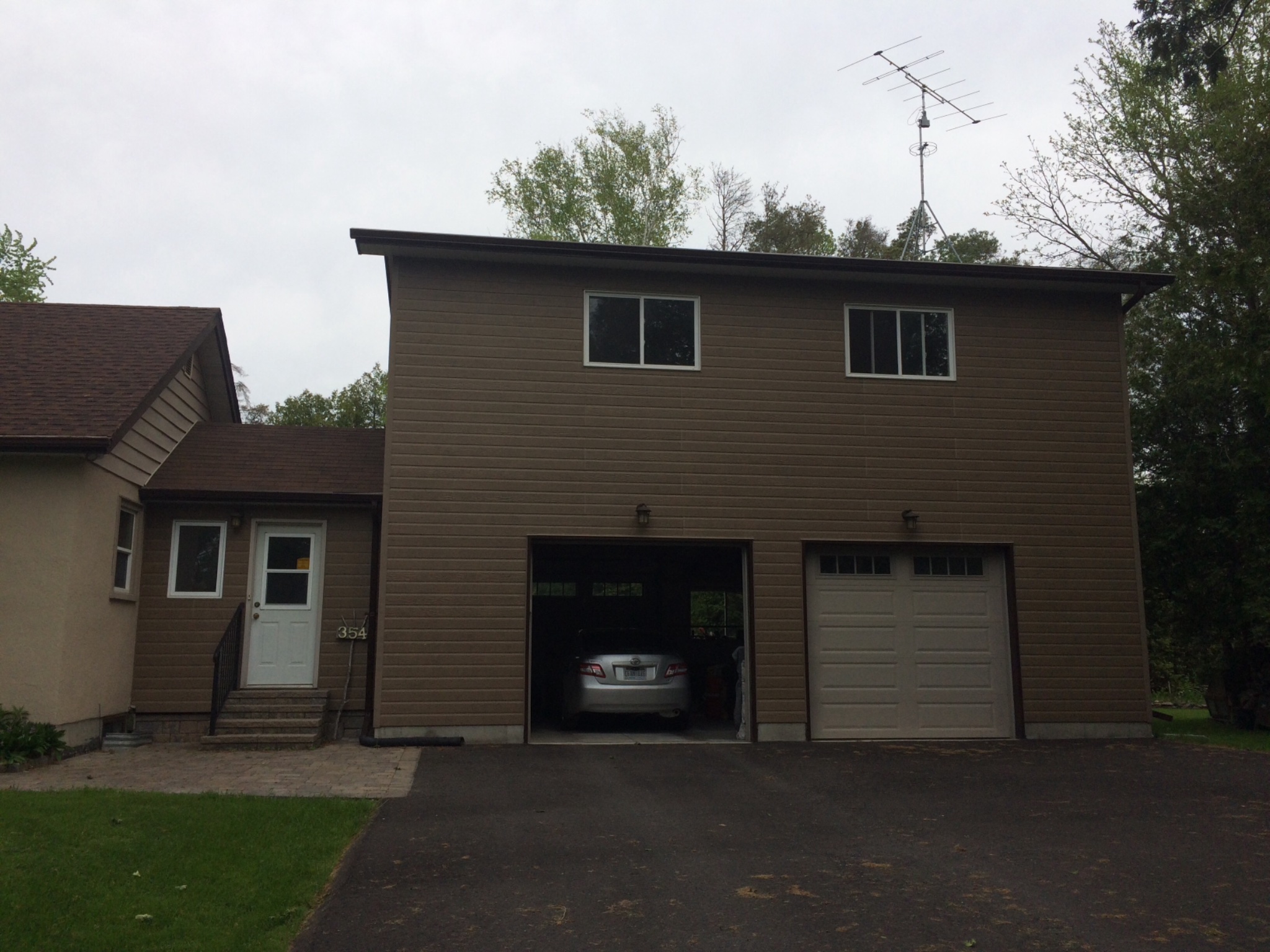

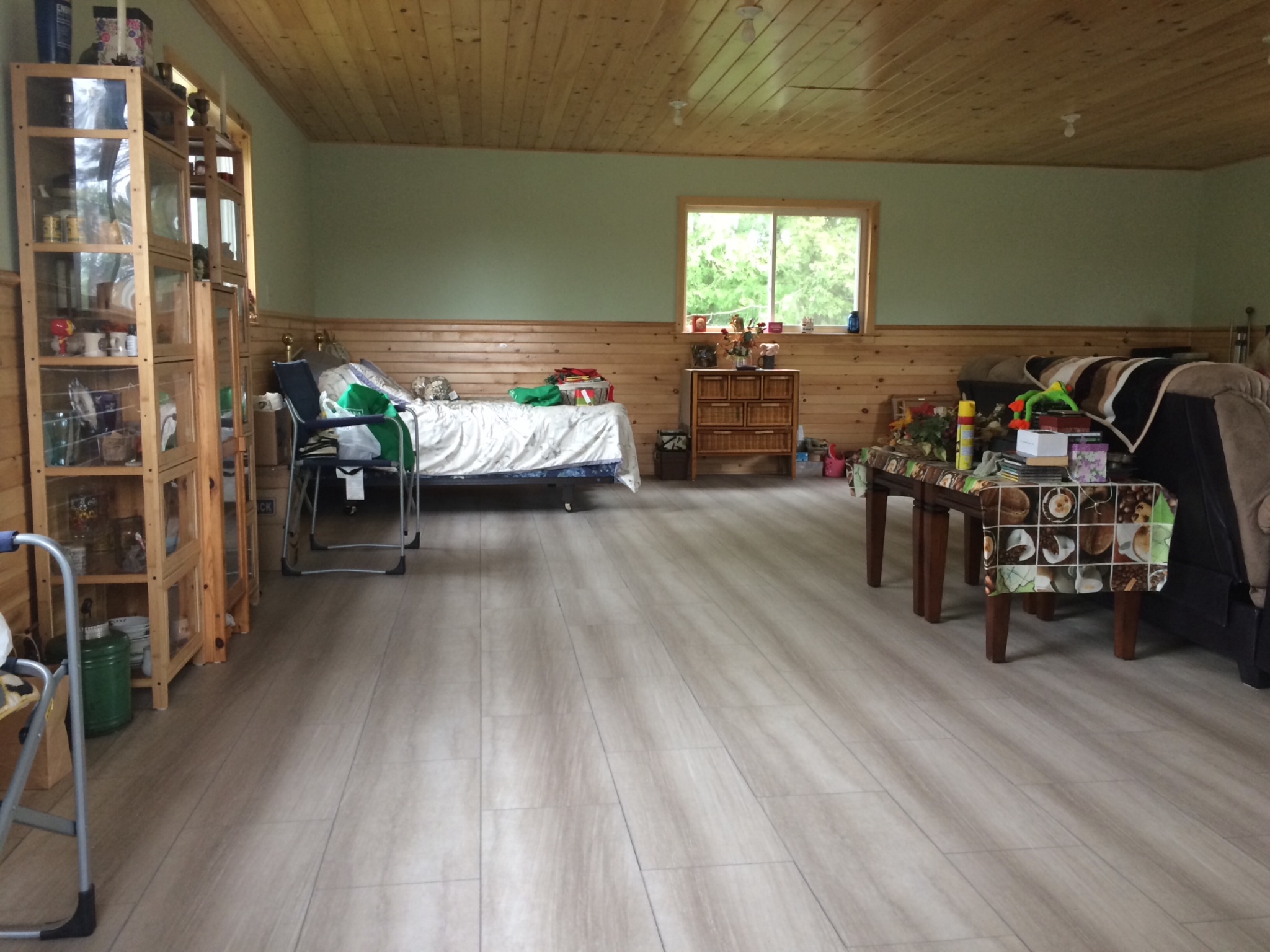

On our two story garage build, we installed the R22 rock-wool insulation(2x6), vapour barrier (continuous), (green/mould resistant))drywall first before we installed the 3 stringers, then the treads there after. I think I see foam insulation, I assume that counts as a vapour barrier? Not sure if our local code allows that.
Just wondering, do you have a building permit? I would think it is mandatory to get a building permit almost everywhere these days esp occupancy.
Plans were submitted to your local authority for approval/permits? using these construction methods and they had no issues?
Building permits for our build required, footing (pre-pour), framing, grading, final.
Electrical is a separate entity, ESA. Since our build was no-occupancy, (garage/storage) thus no plumbing, drain, septic etc inspections

If the stairs are fully inside the structure then they don't need insulation.
His home looks like a metal building, right? That construction method is rather typical... in essence he's got a building within a building. I've seen that done often. I figure the codes reflect that.

Our stairs at home have an external interface to spaces that are not heated or cooled- so we just had to put insulation on the walls and under the steps. The entire staircases were done before insulation. Also, in SoCal we don't need to do much in the way of vapor barriers. We just do stucco, an outer wrap, and then plain fiberglass insulation... we get away with R15 on the walls and R22 on cathedral ceilings ( although we have a 20% sun reflecting roof ).

What did surprise me was that he didn't pour a slab before erecting the metal structure. You can see that in some of the pictures ( the garage? ). My BiL is planning on building a metal garage... I think he said he was gonna pour the slab up front. In his area the frost line is 18 inches deep.

Above my ceiling is 18" of blow in insulation. because I am me, I had the underside of the roof foamed and would do it again. Attic is much cooler while not having to be cooled in any way. Have an attic fan that comes on at 85 degrees. Would do it all again in a heartbeat. listening to my neighbors bitch about their energy bills and noise from outside is enough reason for me.

Are you asking me how we did our 2-story garage? Lots of details but a standard frame structure on a poured concrete foundation
I could answer but it’s not my thread. Will respond only if OP says it’s okay to respond in his thread.
I did not realize it’s framing inside an exiting structure so permits won’t apply

Now, do the wiring for your networks. Every room needs one drop minimum... and add dedicated homeruns for the stereo, TV and data closet. At this time, it's cheap. You'll never regret having too many Romex circuits and network wiring. And also try to have as many heating and cooling zones as the budget allows.

We insulated the interior walls and we did double drywall.... normal drywall and acoustic on one side, and normal and 1/2" plywood on the other. On the den and living room walls we did drywall over plywood, that way I can put shelves anywhere I want. The bedrooms all have at least one plywood and drywall wall as well.. Figure out where you will need shelves and cabinets and act accordingly. Tall kitchen cabinets work very well in bedrooms. The best LP and bookcases you can imagine!
Use solid doors everywhere.
The quietness in each room becomes palpable.

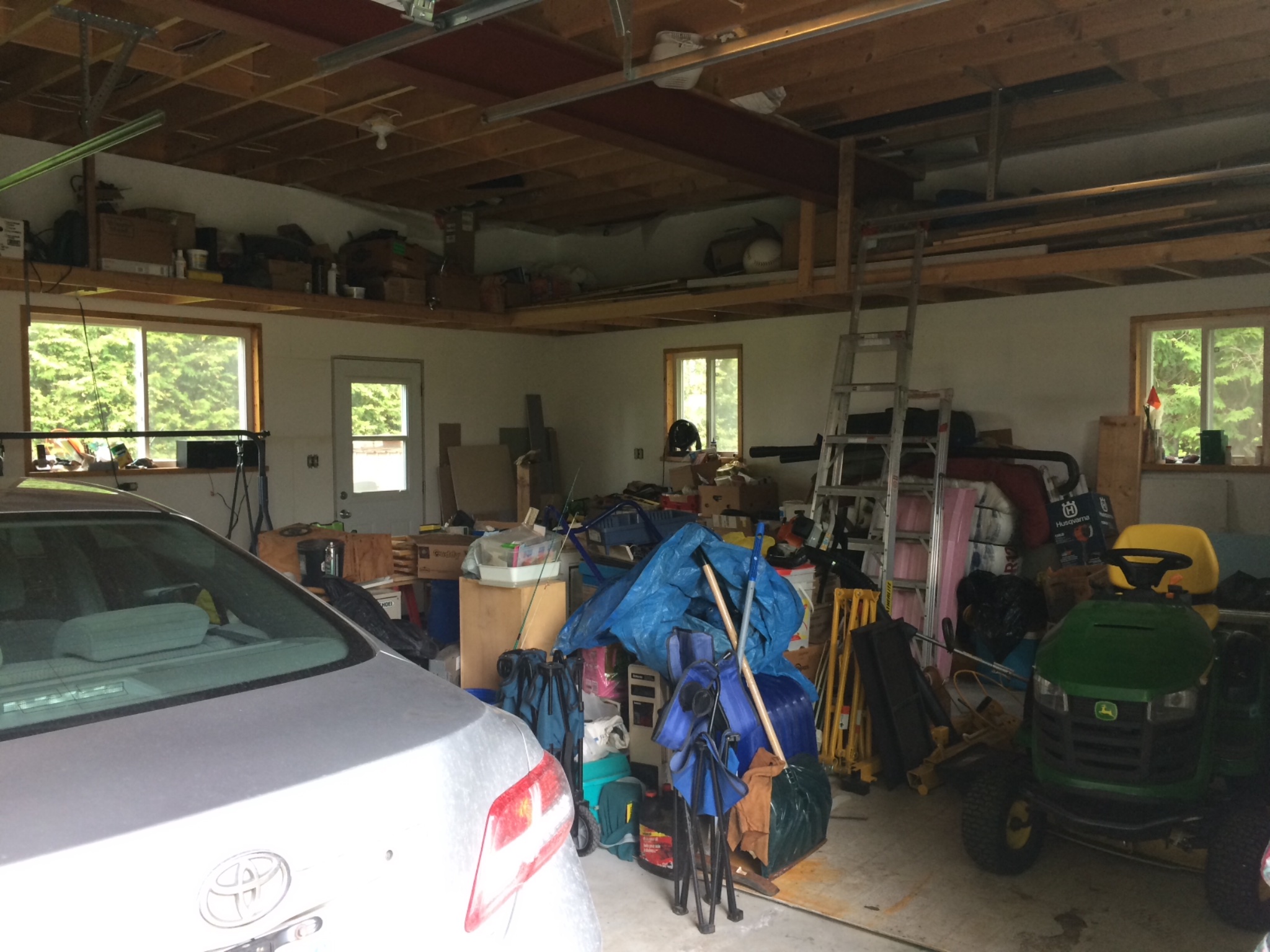

So up at 1AM pulling out the generator from the shed, trying to start it after 10 years of storage. It was traded for the Yamaha SX-1100. Saved our a$$es from flooded basement. Managed to get the Champion generator going, spark plug cleaning etc.
I’ll post some pics of the garage/loft, still a bit of work to do, more shelves, get stuff off the ground from moving in the new wife and all her stuff.

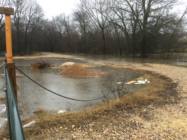

We have a creek in our back yard that empties into the Ohio River. We also had to dance the flood plain dance, pay surveyors and still could not get a mortgage on anything to be constructed here without flood insurance which costs $4000 per year because of the "flood plain." That's why we had to stay in a rental house until the house in Florida sold to pay for building this one. The main floor of the house had to be at 661 feet above sea level, so half of our basement is above ground. Who came up with, and how that 661 foot number was derived still remains a mystery after 10 years. We have never had any water intrusion, but there are days when the twin sump pumps work overtime.
Looking back now we had our house built parallel to the creek. That forces the natural underground water flow from the hills east of us to the creek on the west side to go under or around the basement. We should have angled it a bit.
Not so sure if house orientation matters when it comes to underground water, it does strange things. Wow $4k for insurance. I dropped water damage insurance after they raised rates to be ridiculous amounts to cover claims from the city getting flooded out a few years back.

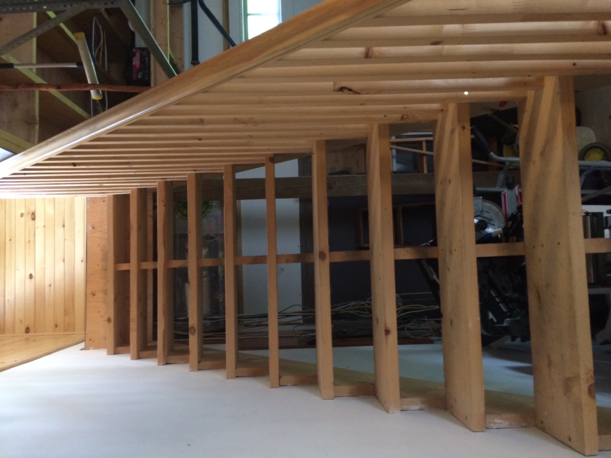

Pics of the garage/loft

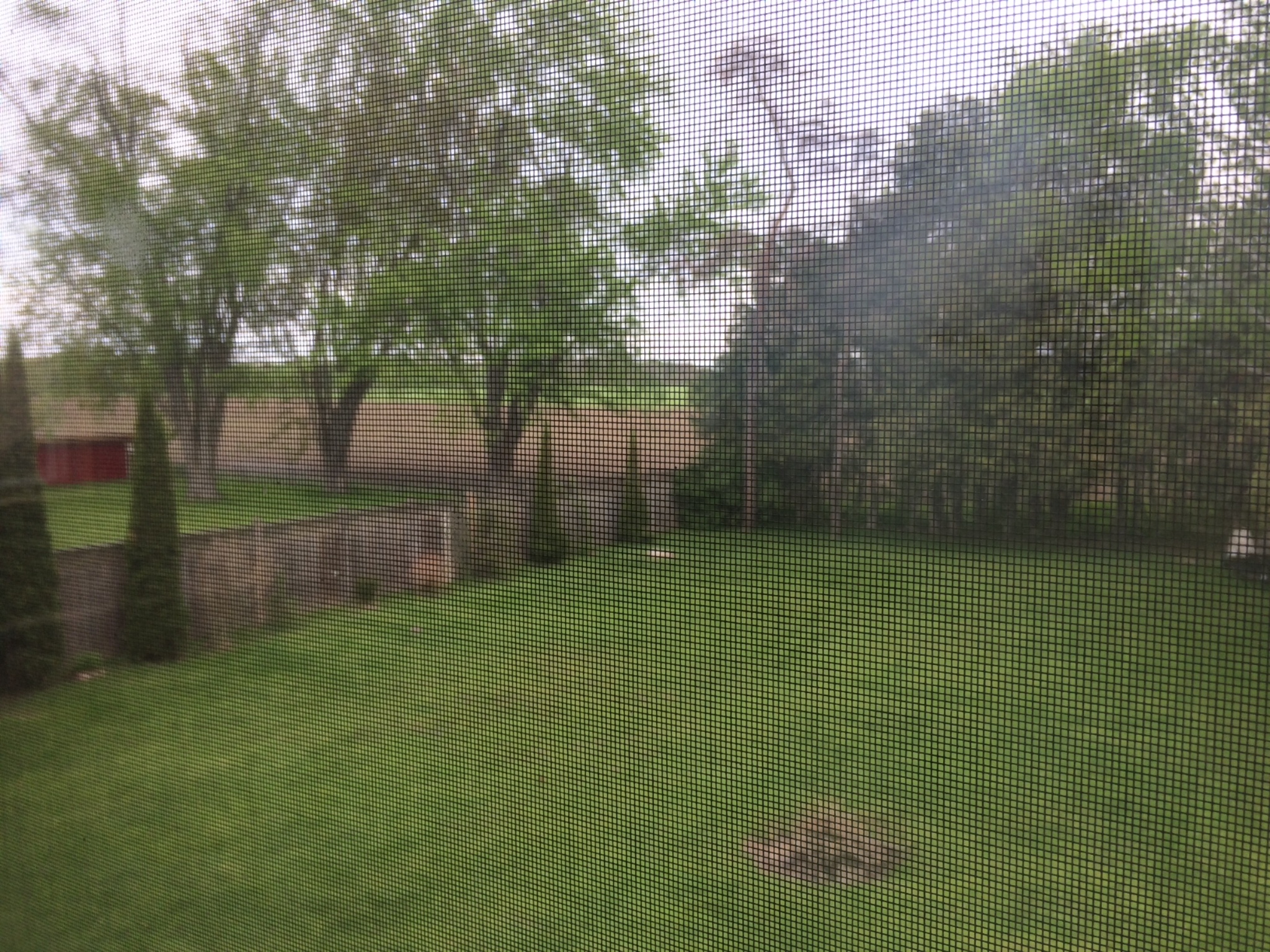

Pos from above of the farm field in the back and river across the street

This place is considered “flood plain” too. According to the survey, the house is right at the edge of it, and the shop squarely in it. But it’s actually the HIGH spot on the property. The whole pasture between the site and the highway, er, buffer zone between us and civilization, floods the worst. We came out here to check it out during a 100 year flood about 8 or 9 years ago and the build site had no standing water. A foot deep in the other pasture. This was when TX 78 between Lavon and Wylie East was under water (and they were in the middle of construction which was massively delayed it again). We get a 5 inch per hour rain and it will get ankle deep out by the driveway but be gone completely 2 hours after it stops. Flooding problems were by far worse at the old house, because it would take a week to go away.
