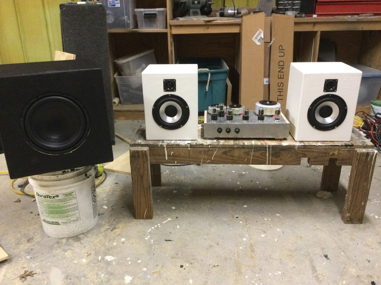

There won’t be much room in the mobile home to set up any “real” speakers so I‘m going to set up my first serious experiment with a “small” speaker system. I added a sub out to my 14 watt per channel 10EM7 amp. Another 12SL7 with degeneration to get the effective mu down to about 20, passive mix and 200 Hz low pass (to get rid of unneeded HF voltage swing). Speakers are the little brother to my 3 way 10” shop background system - 2” mid/tweet and 7” midbass. Powered sub is a sealed 10” GRS and 150W class H home brew. Linkwitz- transformed to be anechoic to 22.5 (In theory). Crossover is at 60, right where the mains cut off naturally (Dip switch adjustable). I don’t mind the sound of a little room gain - been living with and enjoying my 2x10 flat to 23 monkey coffins for almost 2 decades now.

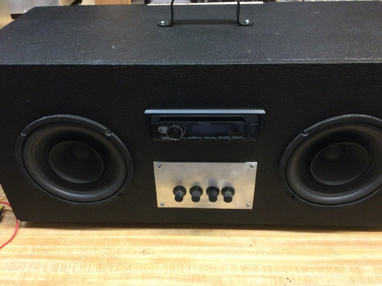

Oh yeah, and “BOX 2” is coming with me out to the site tomorrow, while I work on decking in above the back room and getting the rest of the 2X10’s up. 60 watts per channel feeding a pair of BOFUs. The car stereo head is only the media player - I don’t believe any 50 watt x 4 power rating, since I only measured 6 volts peak to ground on each side of the BTL, as one would expect. I needed to use speaker out instead of line out because thats what comes up in factory default. No backup battery (yet). Forcing it into limited-output class A with resistor to ground, of course. I hate the high crossover distortion inherent to 12V chip amps.

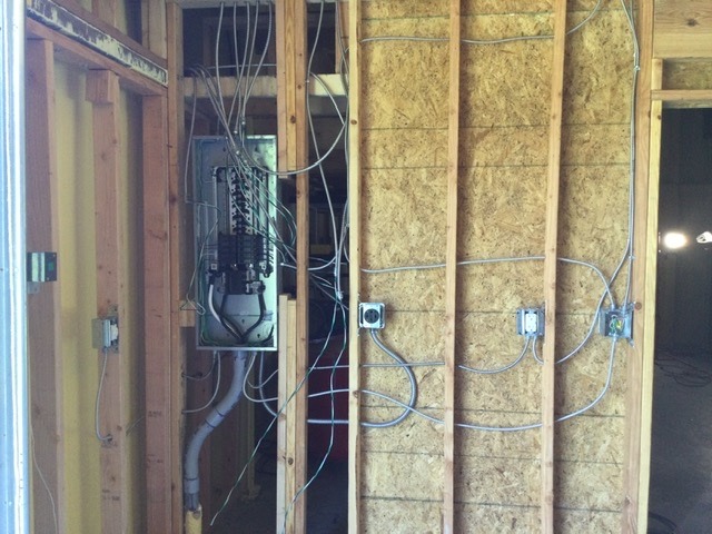

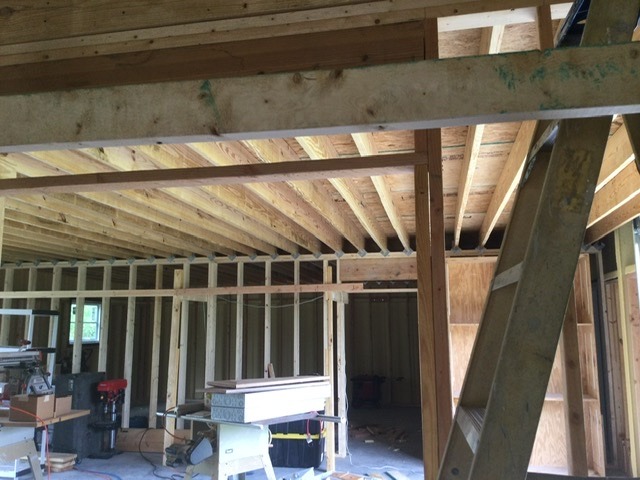

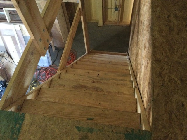

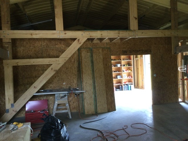

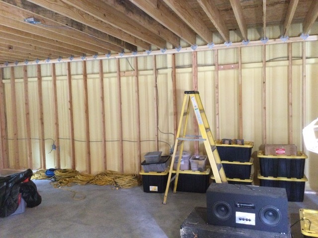

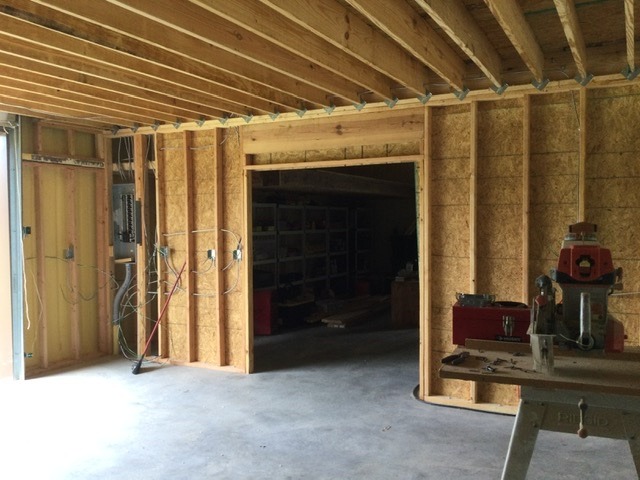

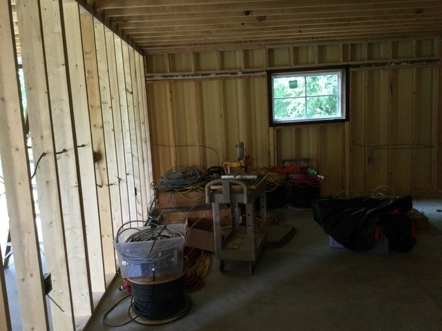

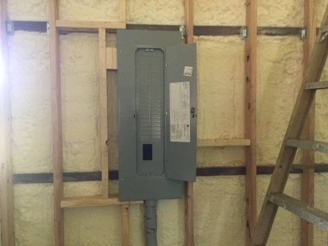

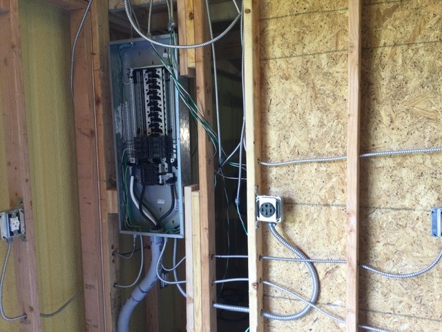

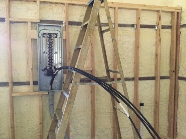

Finally back to work on this. Been a busy bee the past 3 weeks. Hung the staircase and landing, both catwalks, and took a big bite out of all the electrical. Ran through 3 250 fT rolls of 12/2, a 125 ft roll of 10/2, and more than 125 ft roll of 12/3 - and I haven’t even figured out which light fixtures I’m going to buy yet - so there goes at least another 250 ft of 12/2. Ready to pull the big stuff for the shop panel here, but I need to go frame the laundry room wall in the big house, so I can mount that panel and pull both runs on the same day. That requires an extra pair of hands to feed the cable and keep it from binding - and those days are few and far between.

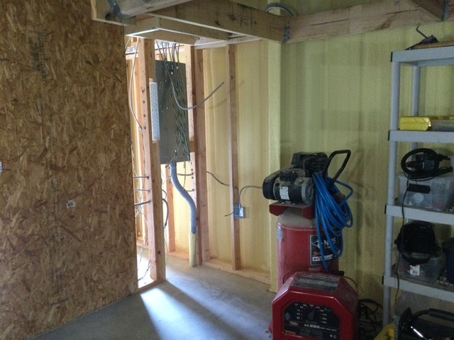

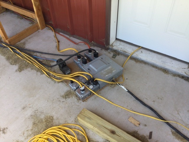

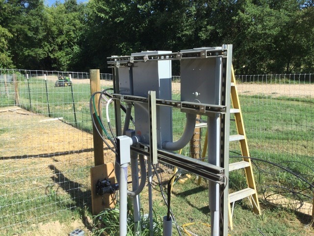

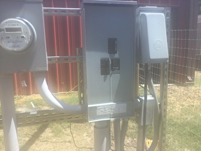

Only managed to get myself 60 Hertzed twice today, getting the feeds for both buildings tied in. Did the pulls earlier this week - on the hottest day of the year. No, I didn’t try to hook up the main lugs hot - killed the feed for that. But that only took like two minutes to do both hots. Did the ground and neutral live. Things only started getting difficult wrestling the 2/0’s into the 125A breaker. Finally ended up connecting to the breaker first, then wrestling it onto the bus. Was taking so long that i left it live so the AC’s would keep running. Wrestle with things, hot and sweaty, hands slip…. ZZAP!. At least no actual fireworks.

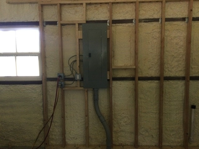

Both buildings are now on permanent underground power. Just had to re-set every GFCI in the shop, they come pre-tripped out of the box. Rained all day yesterday so I had to delay cutting over the shop. Arico’s in the house are at least plugged in inside now, with #10. Now I get to replace the cord on that distro - the one that’s been driven over for a year. Two hundred bucks for a 50 foot roll of 6/3 NM-B these days…..And I thought 100 was outrageous when I built that distro.

Had a GFCI that wanted to nuisance trip occasionally. Finally it wouldn’t stay Re-set this morning. Black wire infinite ohms to ground, even on meg ohm setting. Pulled the white off the load side - and sure enough, short ground to neutral. At least the GFCI did what it was supposed to. Pulled the wire nut and separated the two feeds and one box downstream was the culprit. Pulled the cover off and the short clears. But damned if I can find any place where the insulation is worn through, scraped, or anything. I’m shortening up all the pigtails to the outlets it feeds to make room in the box, and I may as well replace the 7 foot section of incoming cable to tomorrow when I can see. I used the red plastic anti short bushings like youre supposed to (a 250 foot roll of Armorlite comes with a pack of 25 so there is no excuse) and I can’t get it to short moving the white wire around.

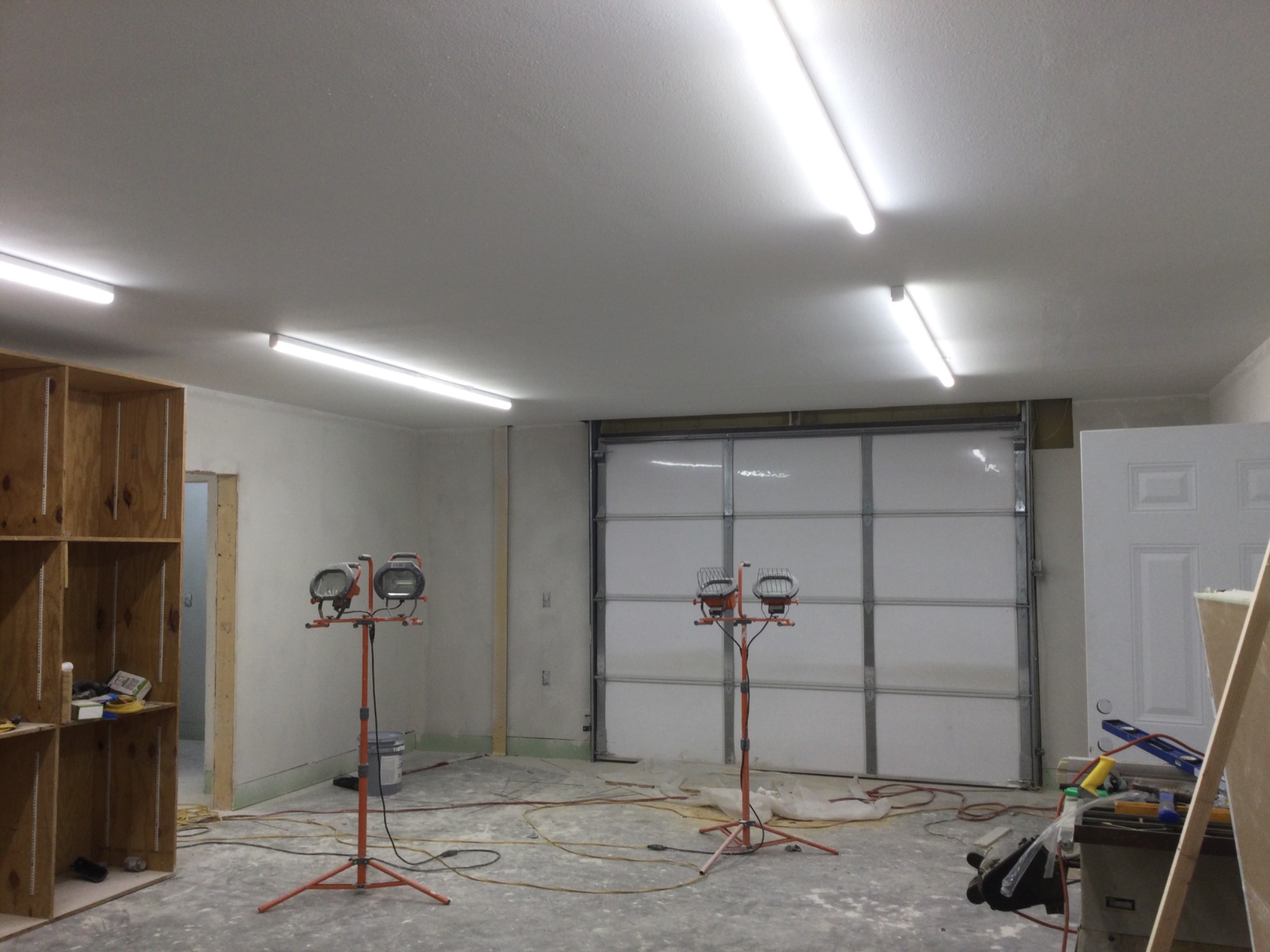

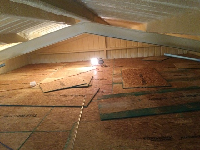

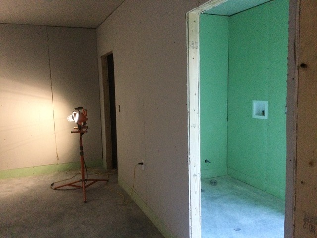

The light fixtures came yesterday afternoon but so far all I’ve done is unpack. I’m going to put cheater cords on the two 105W LED flat panel high bays that are going to light the 14’ high warehouse section and use them for work lights while doing insulation and Sheetrock.

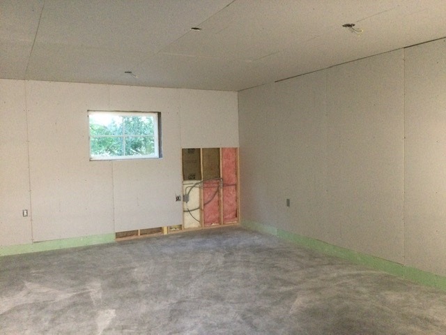

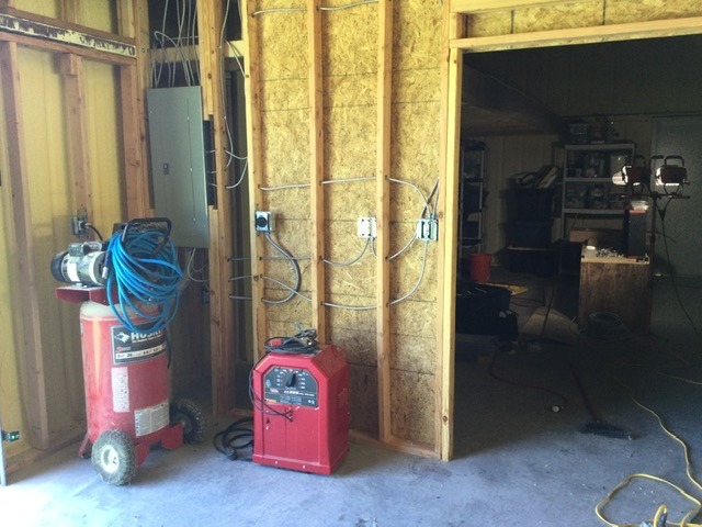

Electronics shop and mud room almost done putting up the rock. Just need to do the panel under the where air handler goes. Still need to mount it and run the refrigerant lines, but the upper panel needs to be primed and painted first. Need to get a tube of liquid nails to do the window casement - that part of the frame is steel. In the meantime moving on to the wood shop…

Those things were almost too bright in confined space. Just what the doctor ordered for the warehouse with a 15 foot ceiling, though. Ive got 14 4 foot LED strips going up in the finished areas - six in the electronics shop and 8 in the wood shop (which is larger). There’s 4 ceiling boxes in that room - the center one is a 20A twist lock receptacle to plug in the 2-sided work bench (from above), which goes in the center of the room. The mud room and closet just get fluorescent retrofits (which are only 1800 lumens per tube instead of the 2850 that the 32W are supposed to be). They are working fine in the upstairs loft.
When I start framing out the inside of the house, I may hang two of those 105W units from the rafters, to light the whole 2000 sq ft area - at least till the ceiling joists and decking go in.

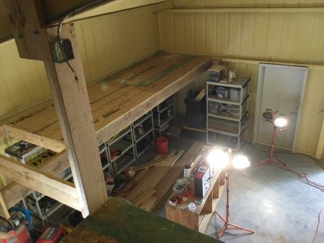

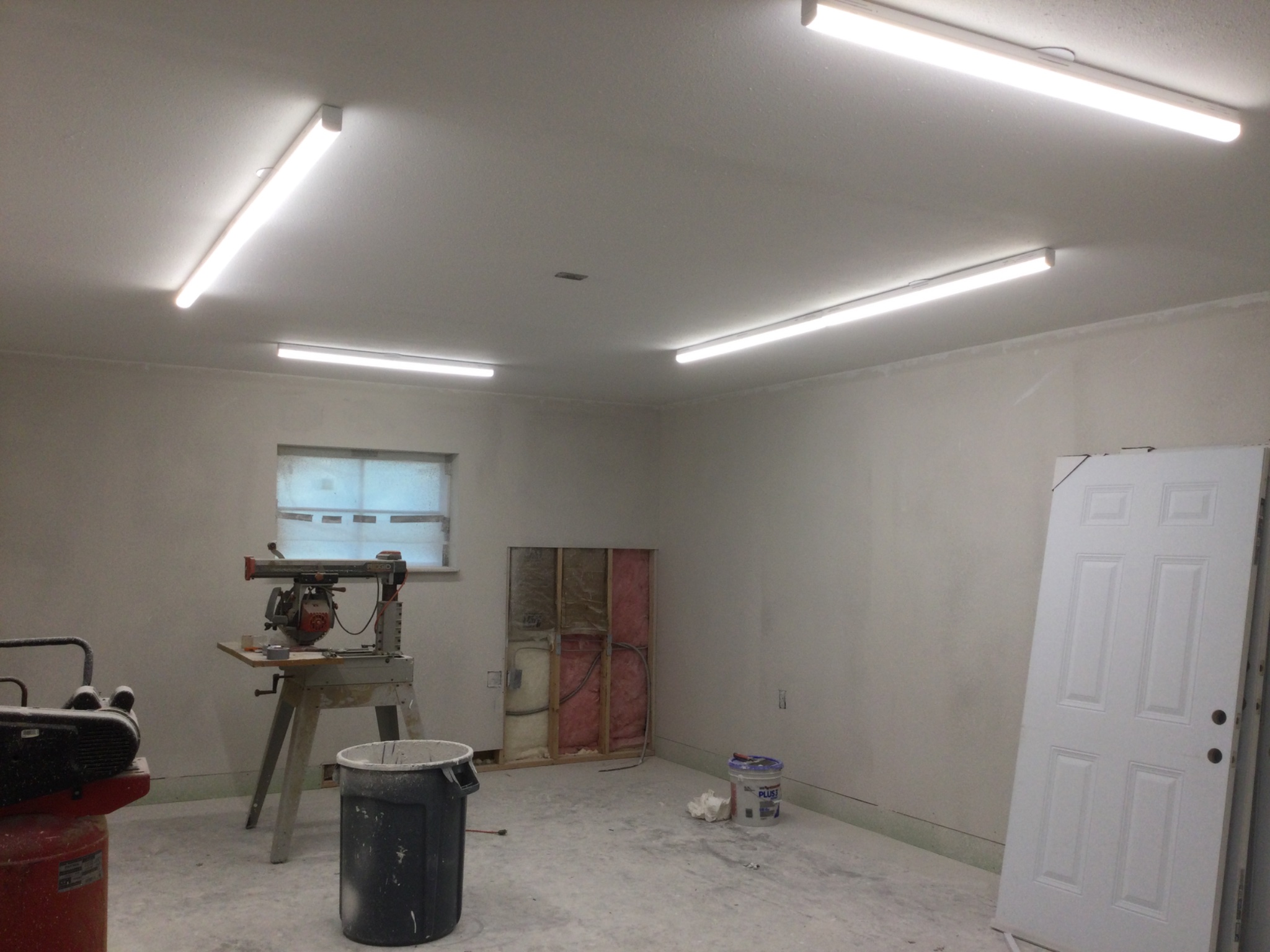

Got the ceilings painted, walls are ready for paint. Lights went up this weekend. Damn that’s bright. The photos don’t do it justice. I WILL be able to read the color bands on the resistors.
