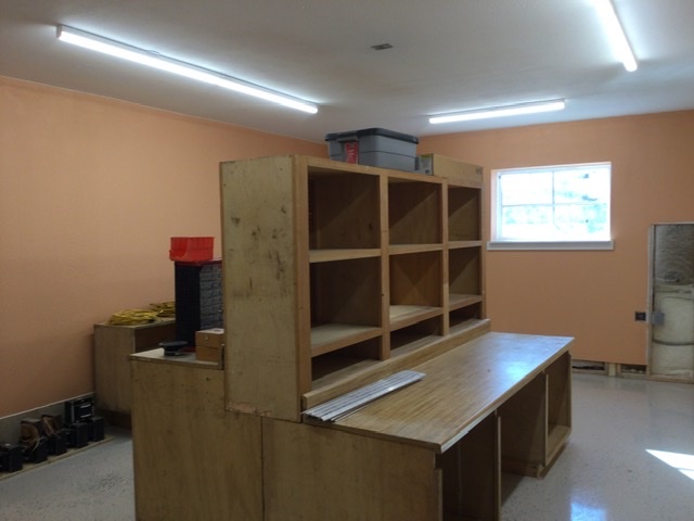

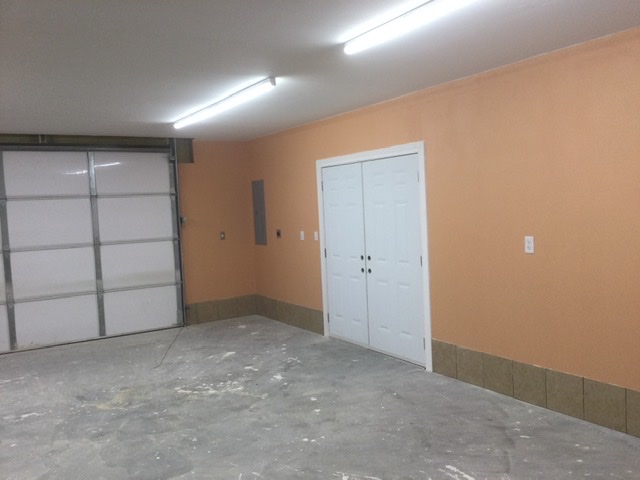

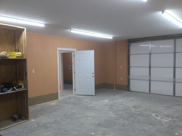

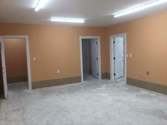

Assuming those are LEDs? I have been replacing fluorescent tubes with LED and find them both better on color balance and even better on the light dispersion. (And they use a lot less power - my power company says we use a lot more power than our neighbors.. I wonder why... 🤣
I am jealous, what a nice space for hobby purposes. Plenty of room for equipment and parts storage. Maybe an audio system?

The light fixtures came yesterday afternoon but so far all I’ve done is unpack. I’m going to put cheater cords on the two 105W LED flat panel high bays that are going to light the 14’ high warehouse section and use them for work lights while doing insulation and Sheetrock.

Yep - all LED. Each 4 foot strip is 45 watts and supposed to do 5900 lumens - the equivalent of two F32T8. I’ve got the regular T8 LED tubes in the closet, bathroom, and upstairs since those areas don’t need that kind of brightness. I’ve got the color temp set to 4k.
Much of the equipment and inventory storage is in the front room and upstairs, which won’t be fully finished out. That’s where the big PA systems normally live. The electronics bench will contain one of my tube based systems, and the bigger one goes in the wood shop. And of course those doors open, so the rest of the universe can hear it occasionally….

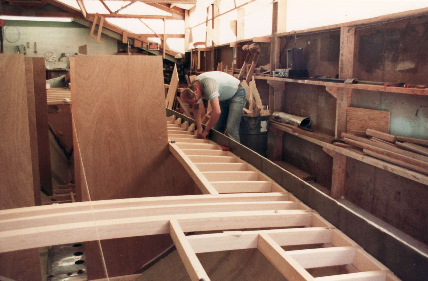

I appreciate those that have tackled building structures and I'm jealous of many of these presented. I'd like to have that shop space or even just a garage. I rebuilt my cabin/house stripping the original down to frame sticks and back. Inside to outside. A small livable space.

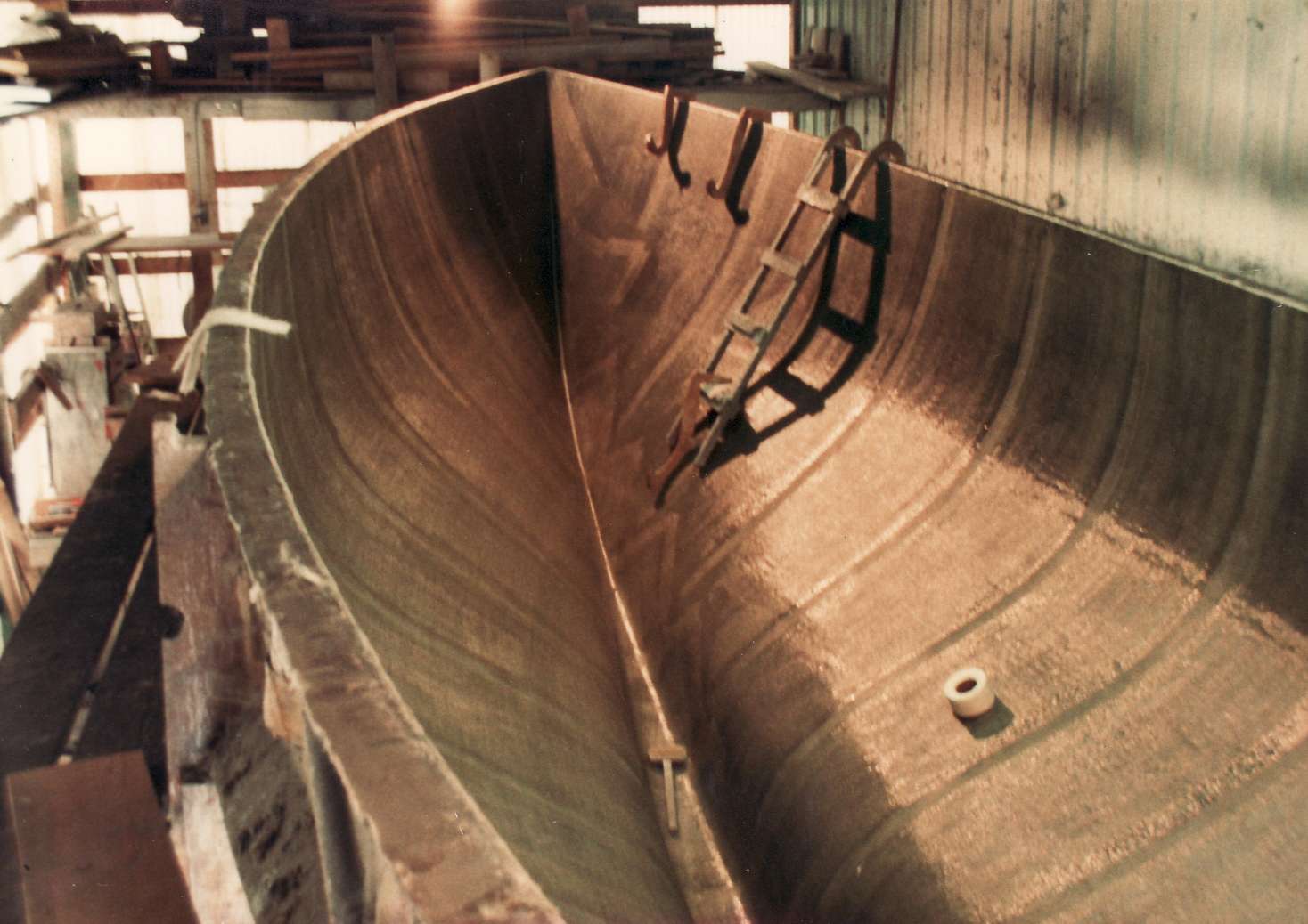

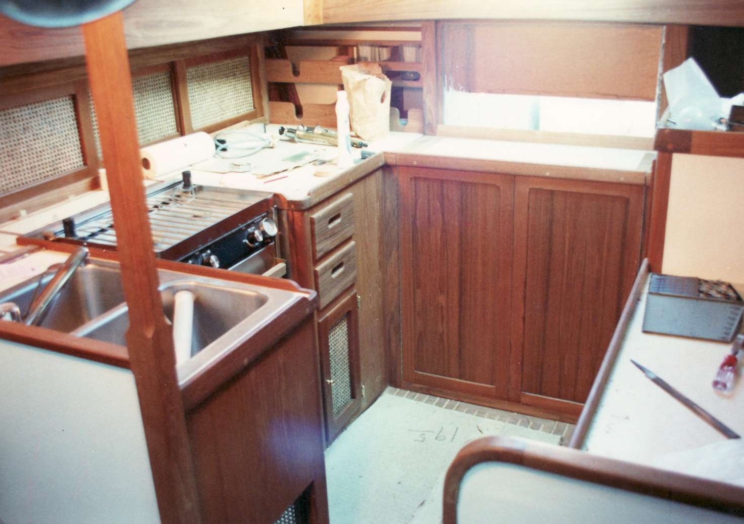

I'm contributing a different build project. One that uses similar skills and materials and requires total completion before one can "move in" and utilize. The materials come in barrels, eight quarter timbers, fasteners by the pound. You fabricate all the parts custom by machining, shaping/gluing, and making the parts before assembling the structure twice. Once to fit the fabricated parts, then remove, glue joints and refasten them again using screws and bolts, mostly bronze. These fabricated parts all have compound curve shapes, all requiring fitted notched joints. No parts are square or straight. You start with 2 sheets of plans, selected tools and materials and factor in a huge amount of motivation. It required years of after daily work and weekends of countless hours. Here's where the works starts and finishes in gross steps.
thumbnail
After making custom parts,
thumbnail
Finish carpentry,
thumbnail
Persistence over 4 years, completed.
thumbnail

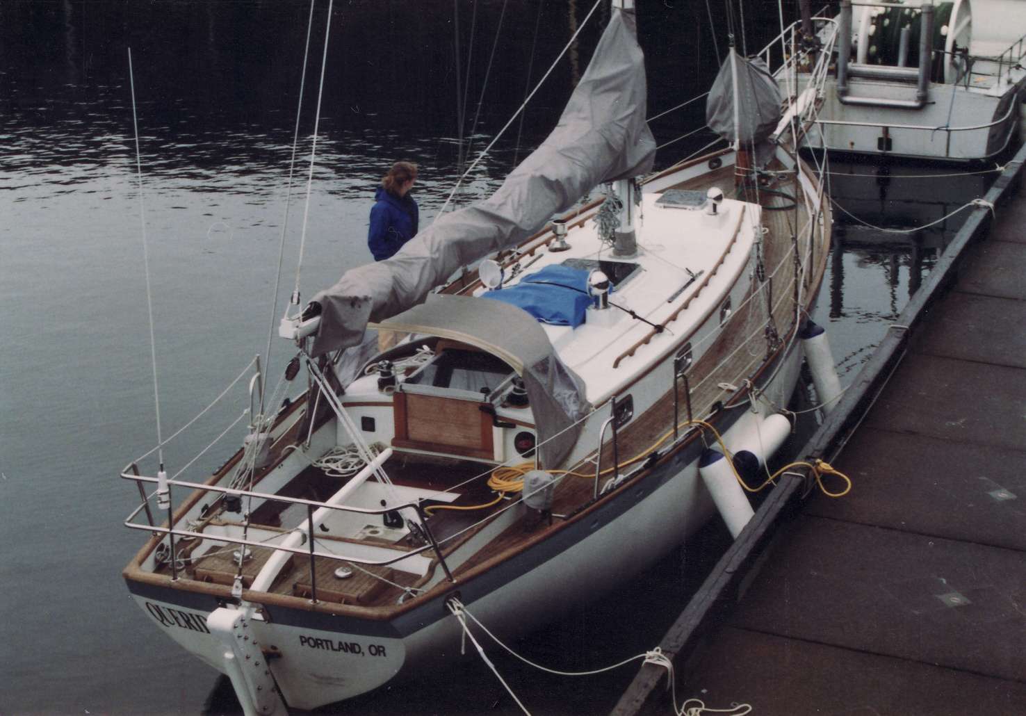

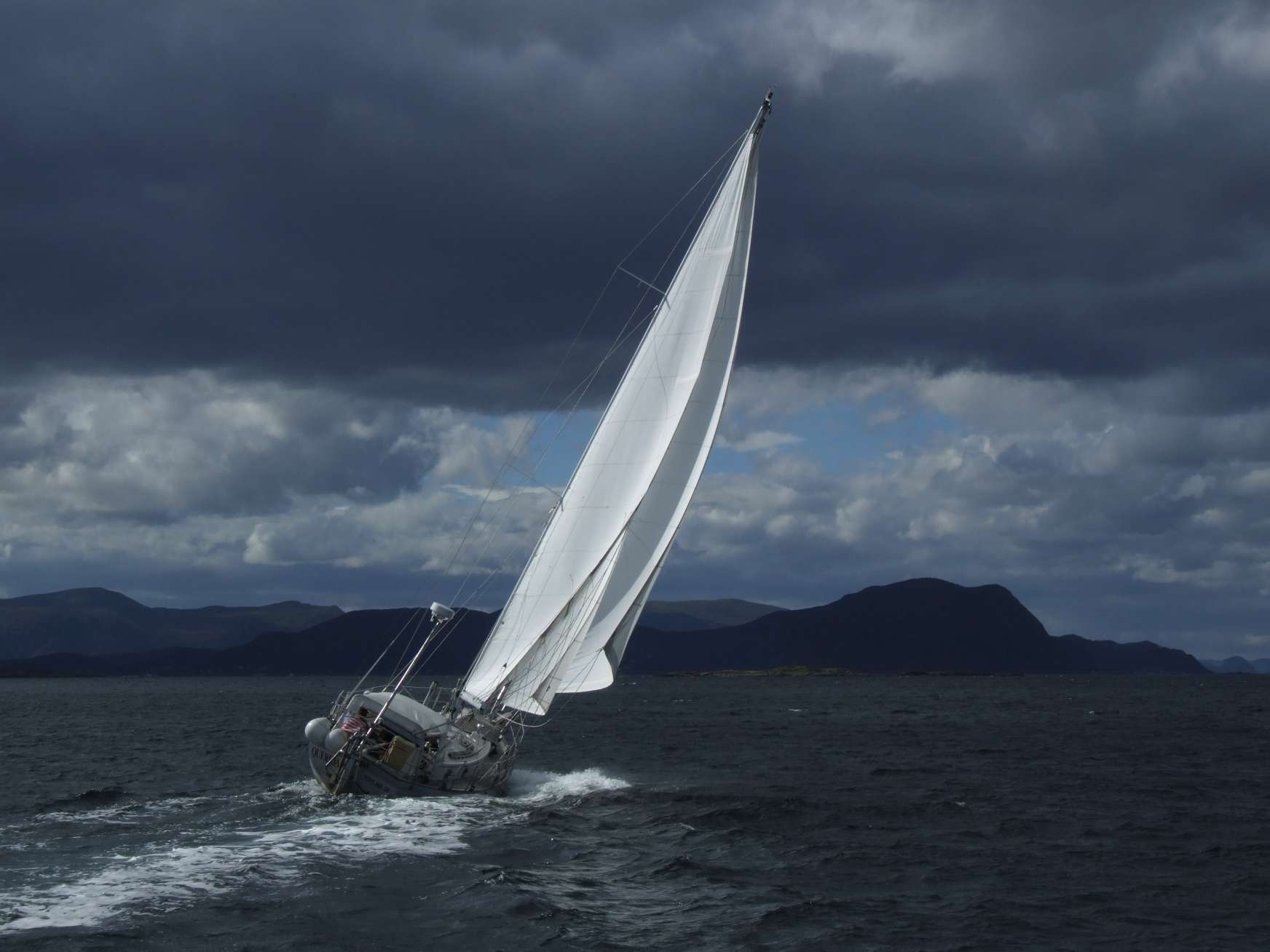

And the payback,
thumbnail
The 100K mile voyage thru 32 years, mostly sunmers with winters at home. This World wide voyage continues successfully with the same boat, same wife who is a total half and full partner of this total endeavor.

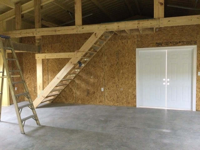

This phase is getting closer (and closer, and closer….). It may look like it’s almost done, but when it is there’s the entire house to do.

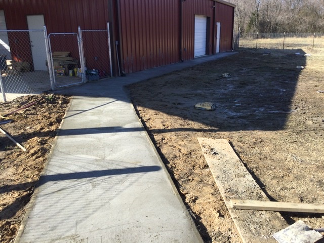

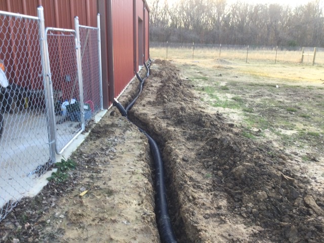

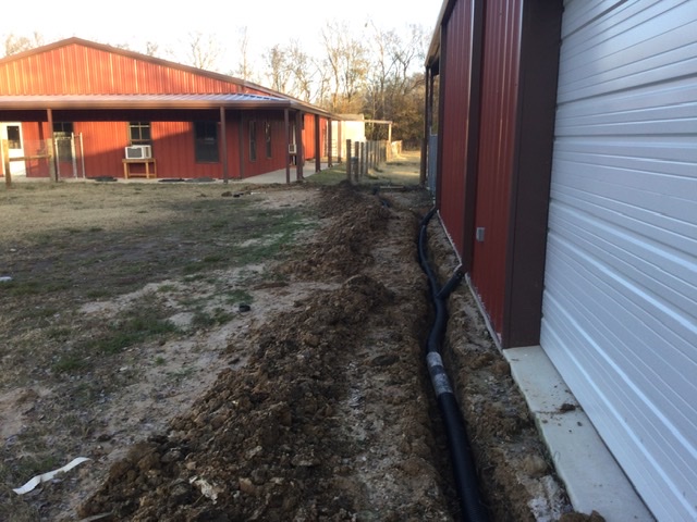

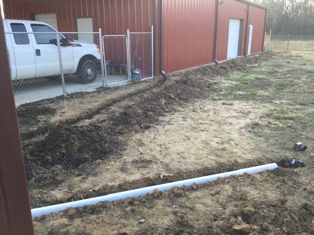

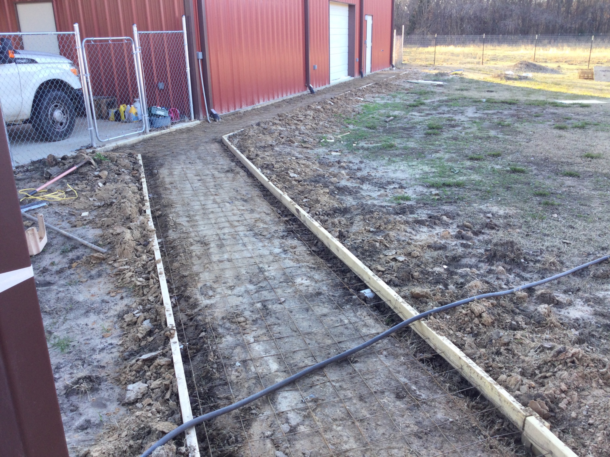

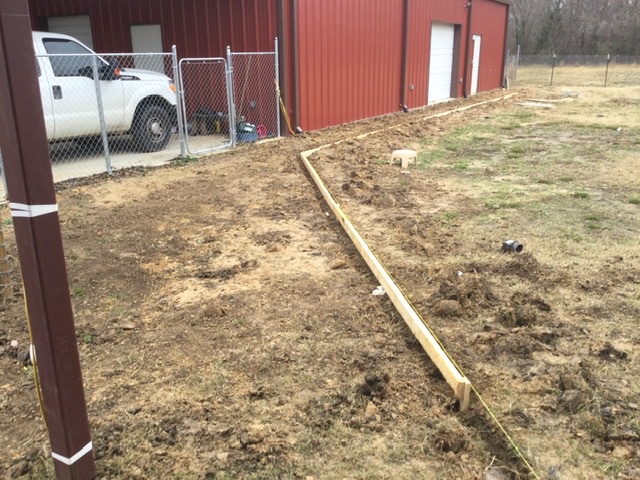

The ground was finally the right consistency to dig for the drain pipe. Not to gooshy on top and not brick hard on the original grade. This is as far as I got on the concrete forms before being chased off by rain this AM. It will be 4 days after the rain event before that can be finished up. The epoxy paint for the floor inside is en route, hopefully will be here on the 26th.

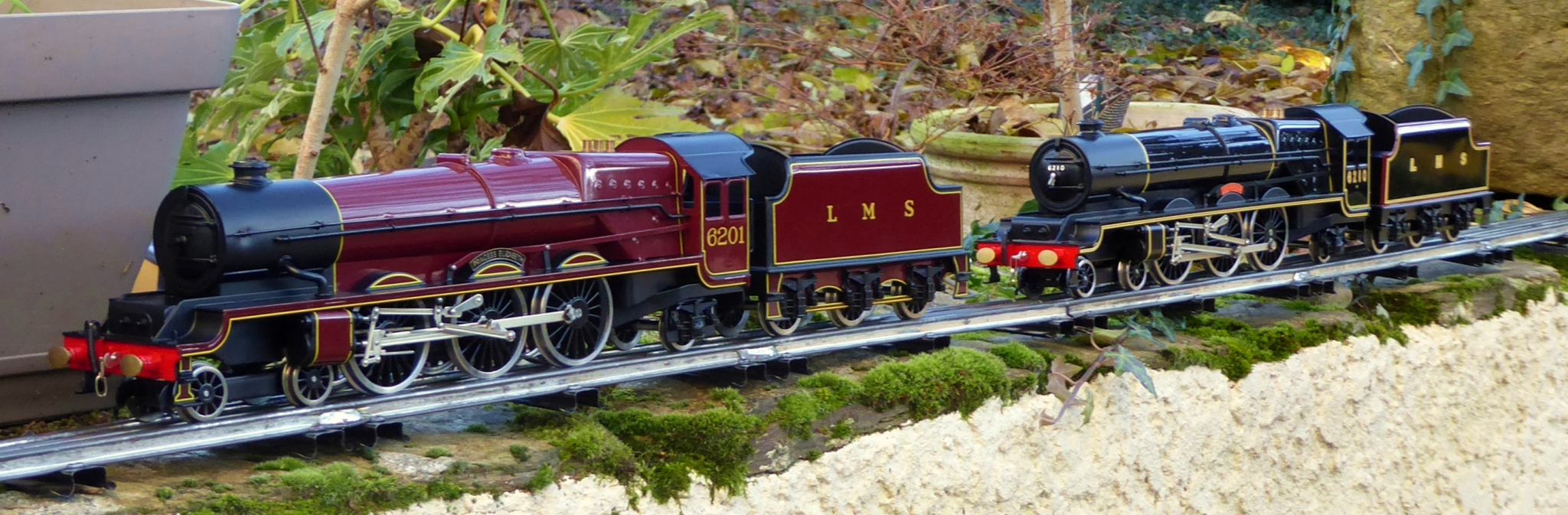

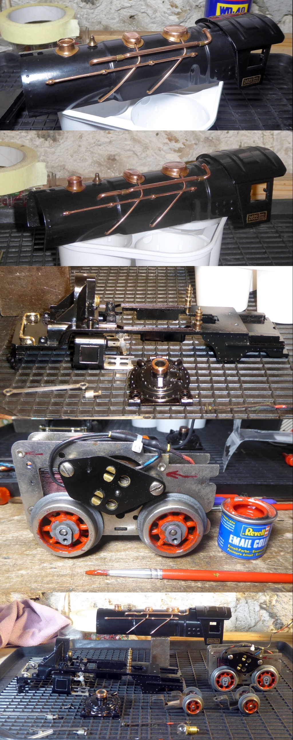

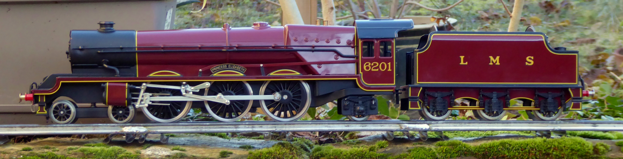

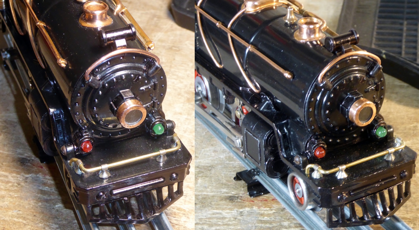

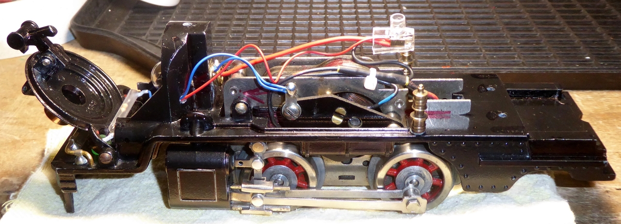

My last non-audio restoration / rebuild : Princess Elizabeth...
... Pictured alog with her sister Lady Patricia...

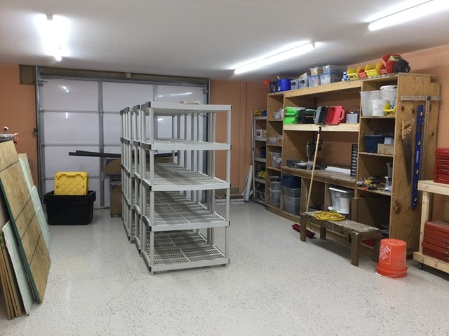

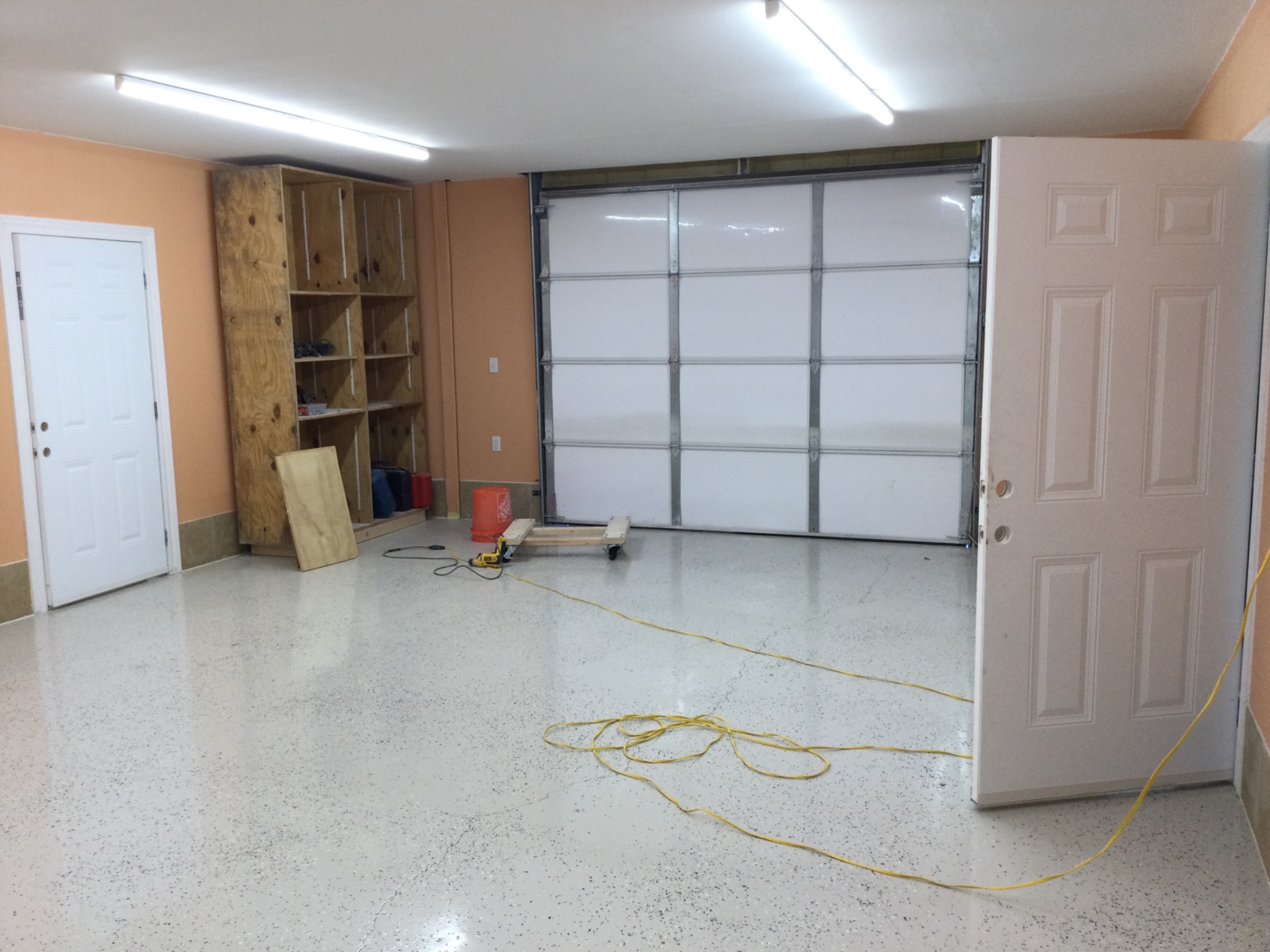

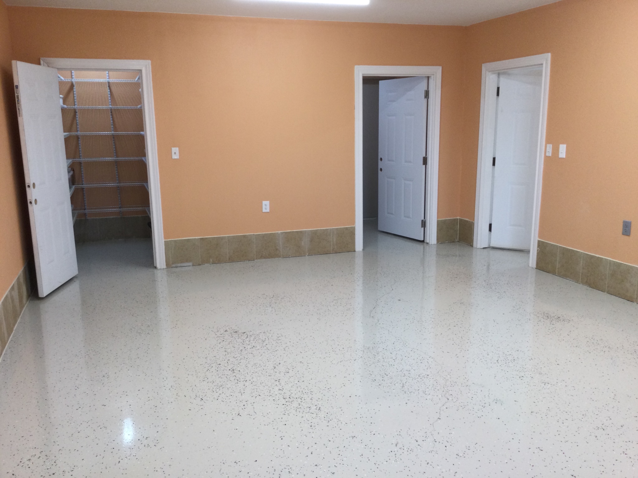

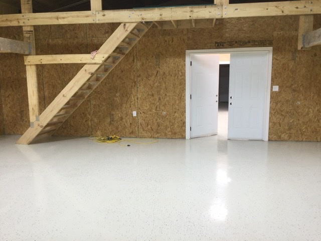

The floor paint came on the 26th. 2 days to acid wash and clean it back up (it all doesn’t come up in the first rinse), then 2 days to wait for the epoxy to cure. Clear coat was quick, then wait another 3 days. Finally starting to clear the cabinets and work benches out of the front half. Got the walkway ready for the concrete, but now it’s too damn cold. When the nights get into the 30’s again that can be done. Cold is ok for concrete but freezing is not. By then the front half of the shop will be empty. Maybe we’ll get a week in the 50’s in February for the rest of the epoxy.
thumbnail
thumbnail
Finish carpentry,
thumbnail
thumbnail
And the payback,
thumbnail
I salute you. What a journey! 👍👍👍
Building a boat is a HUGE undertaking. I remember seeing concrete hulls all over the place about 40 yrs ago. People started them, and rarely finished them. The real money and sustained effort was in the decking, masts, sails and outfitting so most of them were abandoned.

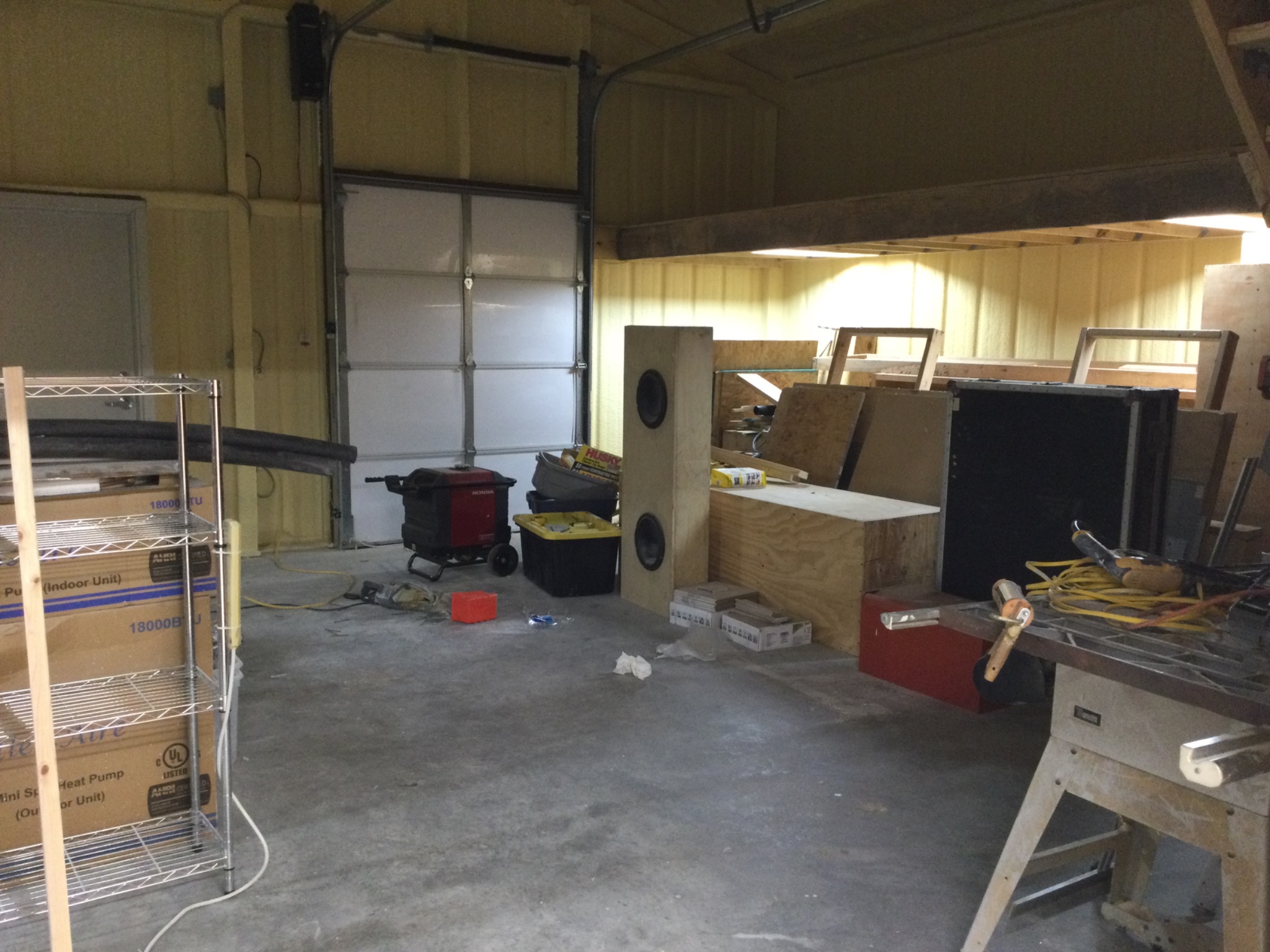

During that latest hard freeze I managed to get the warehouse cleared. It hasn’t been that clean since it was built. Got to get it prepped for floor epoxy, when we get the next 3 days of 50 degree weather. Had 2 days above freezing at night, so I played hooky from work to get that concrete down. Cold this AM, and supposed to plummet again tonight.

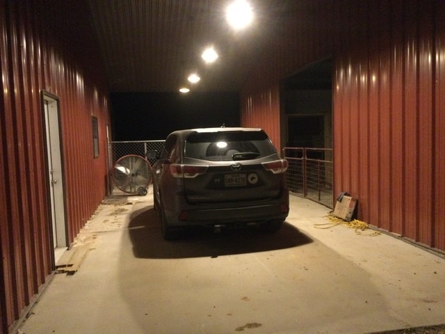

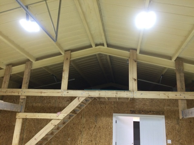

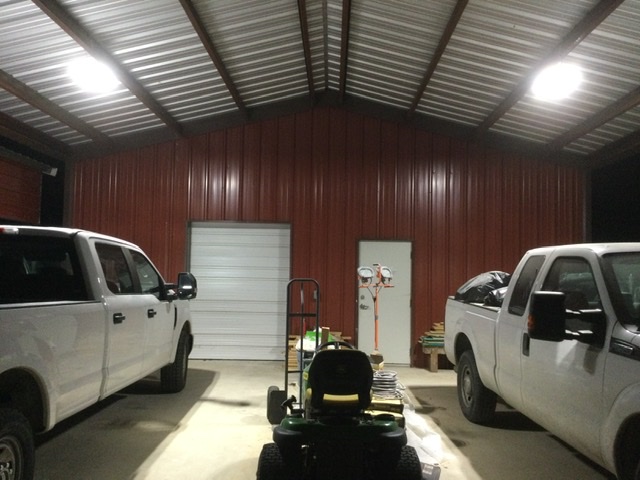

Never feed them after midnight. Bright light! Bright light! I’ll be able to see when coming home at night for sure. Rented that scissor lift over the weekend and got most of the overhead lights installed and wired. Floor epoxy was ready in the warehouse. Unfortunately, didn’t get the two in barn done. The damn machine refused to lift over about six feet on the surface. It’s packed decomposed granite, 6” thick, with the rubber stall mats on top. Pretty solid, drive through it all the time - and it’s still easy on unshod horse feet. Darn thing’s “pothole detection” mechanism went off and stopped lifting before I got to the ceiling. Just too much give for it. Everything else was on concrete, so no issues.
I’ll end up having to erect scaffolding on top of the horse stalls to finish those. Isn’t going to be any safer. Maybe I’ll get the neighbor to lift me in his front end loader. At least the tools and supplies wint fall out of that.

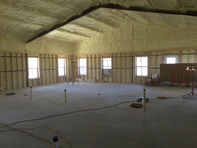

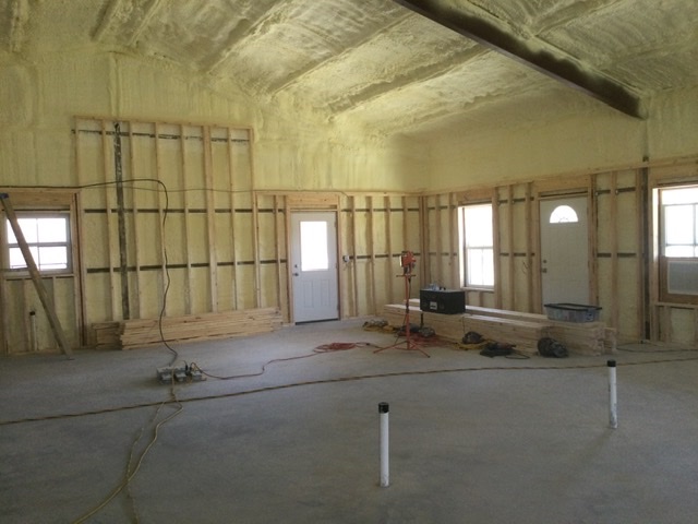

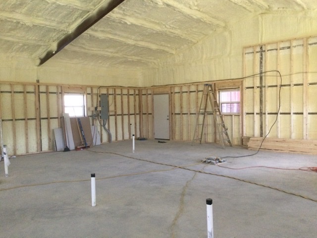

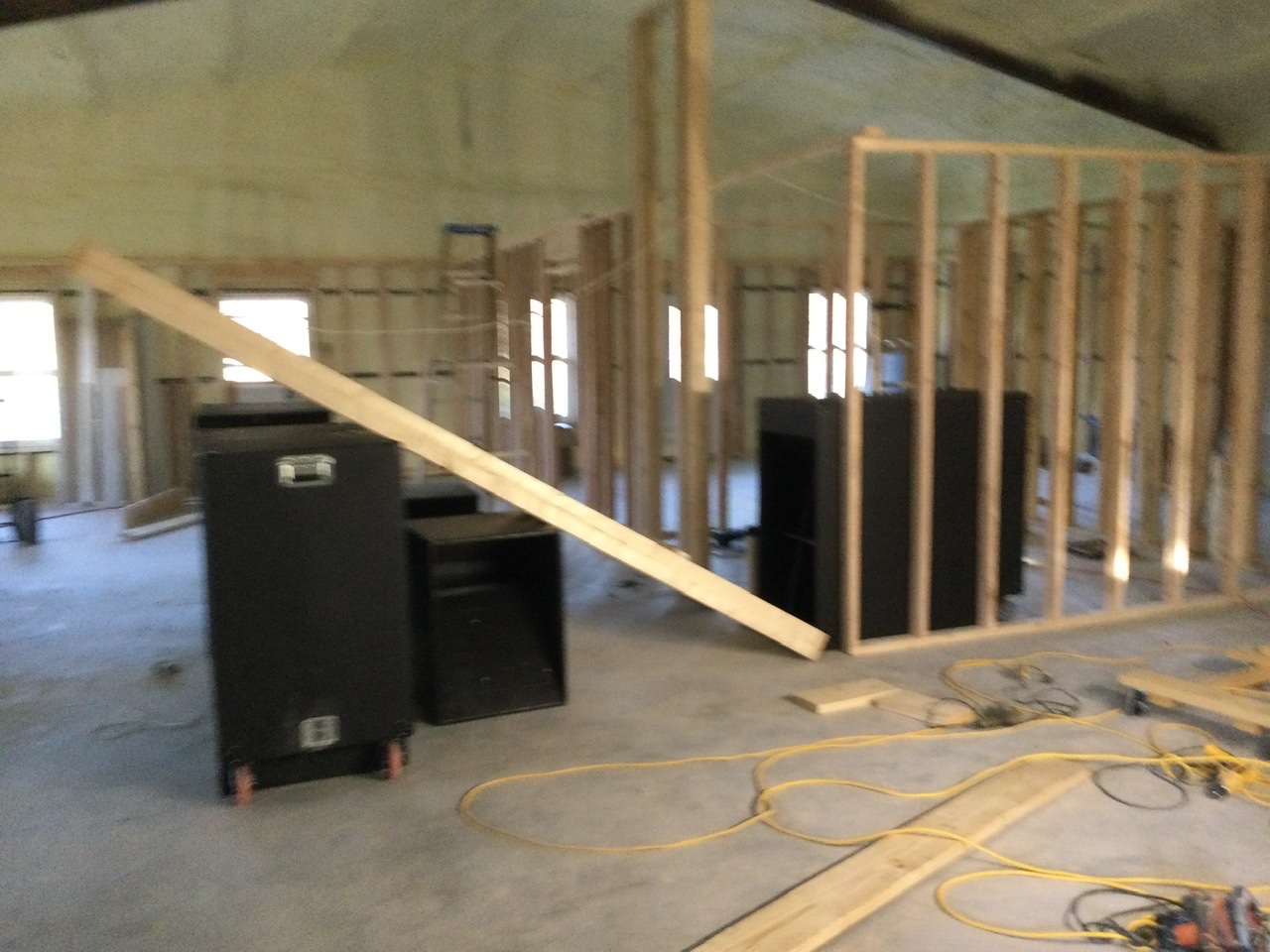

Well, I’m no longer working on the shop. Inside the house started a couple weeks ago. Just got done cleaning and rearranging, starting the interior wall framing later this week. The shop is now packed to the rafters with all the speakers and electronics (which are supposed to live there) and all the household goods….
