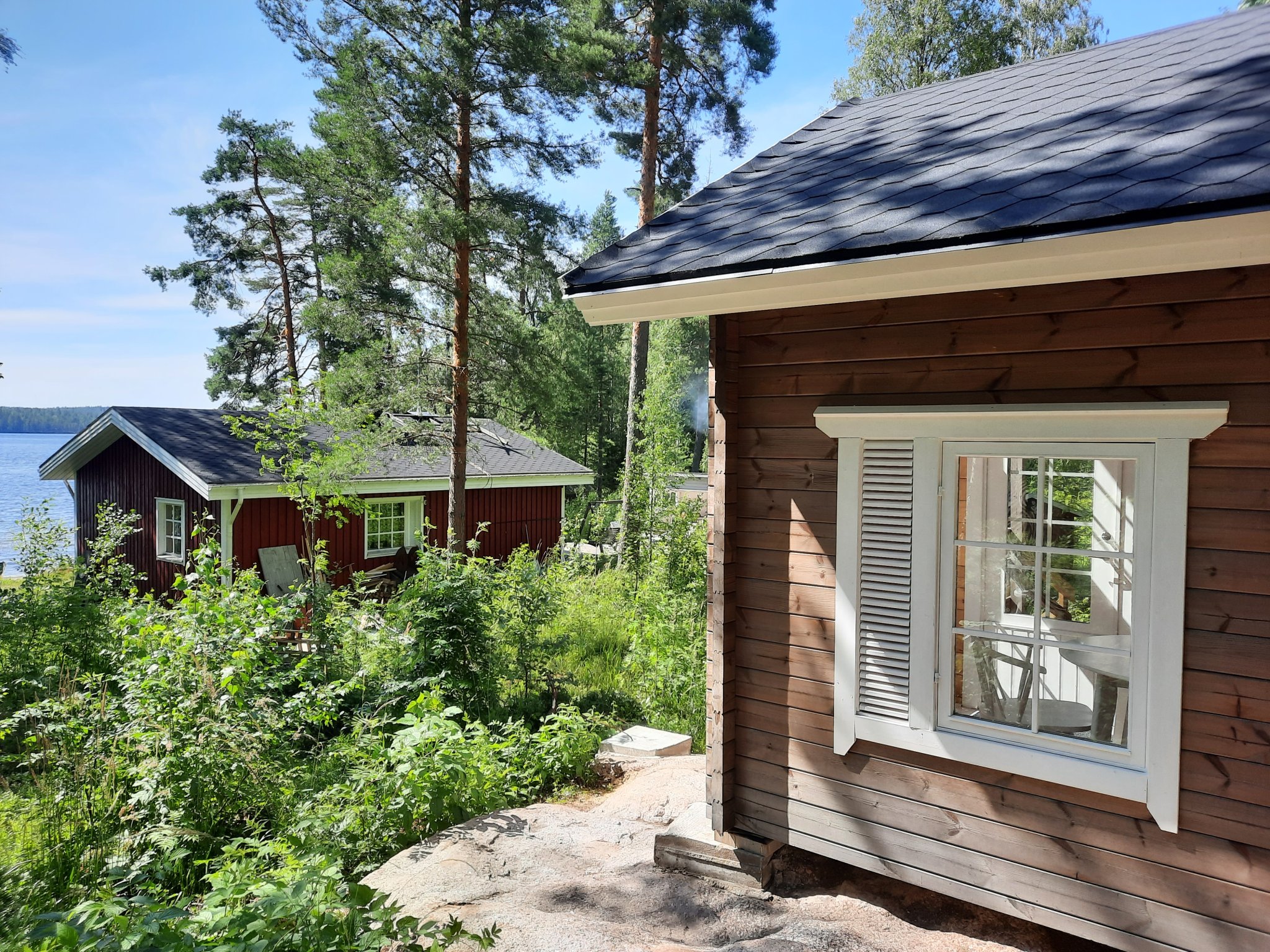

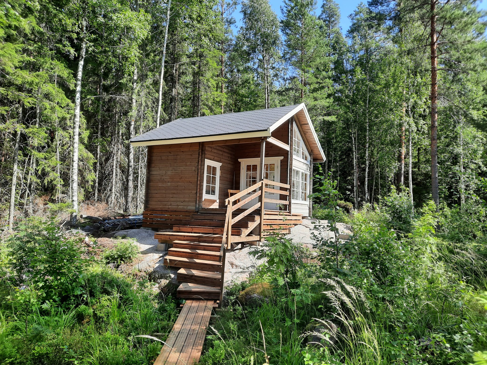

Guest house is ready now!
Reactions: 1 user
I see you are surrounded by trees, is that why you are using metal to build your house? Like a lot of Europeans I couldn't believe that virtually all the houses built in heavily wooded land right through the West Coast were timber and all that was left was the stone/brick chimney breasts and will probably be built of the same material.
