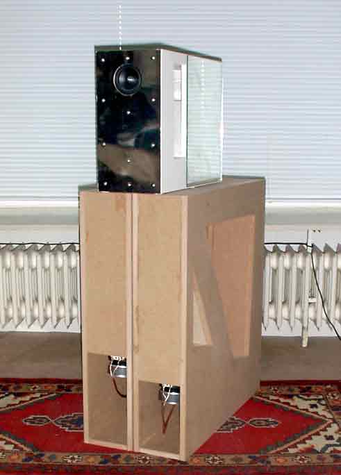

Hello,
if you take two different horns you can reduce the IMP
look my Subfanfare,
if you take 4 (2+2) you can reduce it more
and you get 4 Ohm
here single imp of the long and short horn and the sum
driver WAL 416 Mivoc.
you get a cleaner bass with better contour,
enclosure movement is smaller because no big pressure changes,
and the AMP likes it much more, here below 50 Hz no IMP peak
but down to 35 Hz.
Hello,
look my Subfanfare,
and you get 4 Ohm
but down to 35 Hz.

"if you take two different horns you can reduce the "
Your dual length horns are not practical for high output situations like car audio or PA unless two amplifiers are used so you can cut-off the low end below the 1/4W point to limit cone motion.
Hello djk,
" "if you take two different horns you can reduce the "
Your dual length horns are not practical for high output situations like car audio or PA unless two amplifiers are used so you can cut-off the low end below the 1/4W point to limit cone motion."
No, look the measurements of my double horns,
this technic is for every application useful,
please read "about what" in the middle
http://www.hm-moreart.de/11.htm
djk said:"if you take two different horns you can reduce the "
I've built a simple Akabak model for Horst's dual tapped horns and started playing with possible ways to cause the horns to interact (for example, common mouth) so that the "longer" horn will control the excursion of the "shorter" horn below its resonance. This would allow a single amplifier and high-pass filter. I'm not too hopeful though, Horst has been designing (and, more importantly, building) horns for much longer than I have.
OK, I've done some preliminary checks.
Take two tapped horns with identical drivers and 5/7 length ratios (for example, 2.5 and 3.5 metres). Give them a common last segment (S3) that has a throat area equal to the combined mouth areas of the second segments of the two horns. (Conceptually, imagine two tapped horns placed side by side, with the common walls cut back to just before the drivers.)
Now progressively reduce the mouth area of the combined horn while watching the excursions of the two drivers. The excursion of the driver in the higher frequency horn will be progressively reduced at frequencies down to the resonant frequency of the lower frequency horn. There's no free lunch - efficiency drops slightly, and the excursion of the longer horn driver increases somewhat over what it was as a separate horn. The main advantage of such a combination is that the drivers can be powered from a single amplifier with a single high-pass filter for excursion control.
