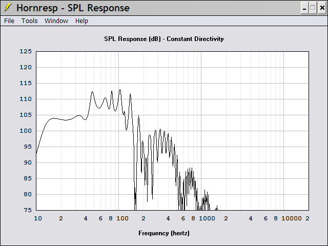

OK, thanks. These are different specs from both the manufacturer's and DUMAX ones, so are these measured?
Regardless, this is a true sub driver, so wants a ~9.8 - 13.29 Hz low corner and its specs being what they are, it doesn't want to go much over 100 Hz, so even if it was suitable for 50 Hz, it's not ideal for at least 150 Hz. Combined with its relatively high Vas, we're looking at ~600 - 1200 L for this thing to 'strut its stuff', making it ideal for a built-in.
Note that like any horn it won't load all the way down to 50 Hz if it's only 50 Hz long, with a half octave below being a typical length for conic and one octave for expo, but you can start there and use HR's slider optimizer to find the right length, etc., for the intended driver's specs.
Dayton DVC385-86 (295-190) 9.8-96.41 Hz conic TH, 1.0 W corner loaded:
