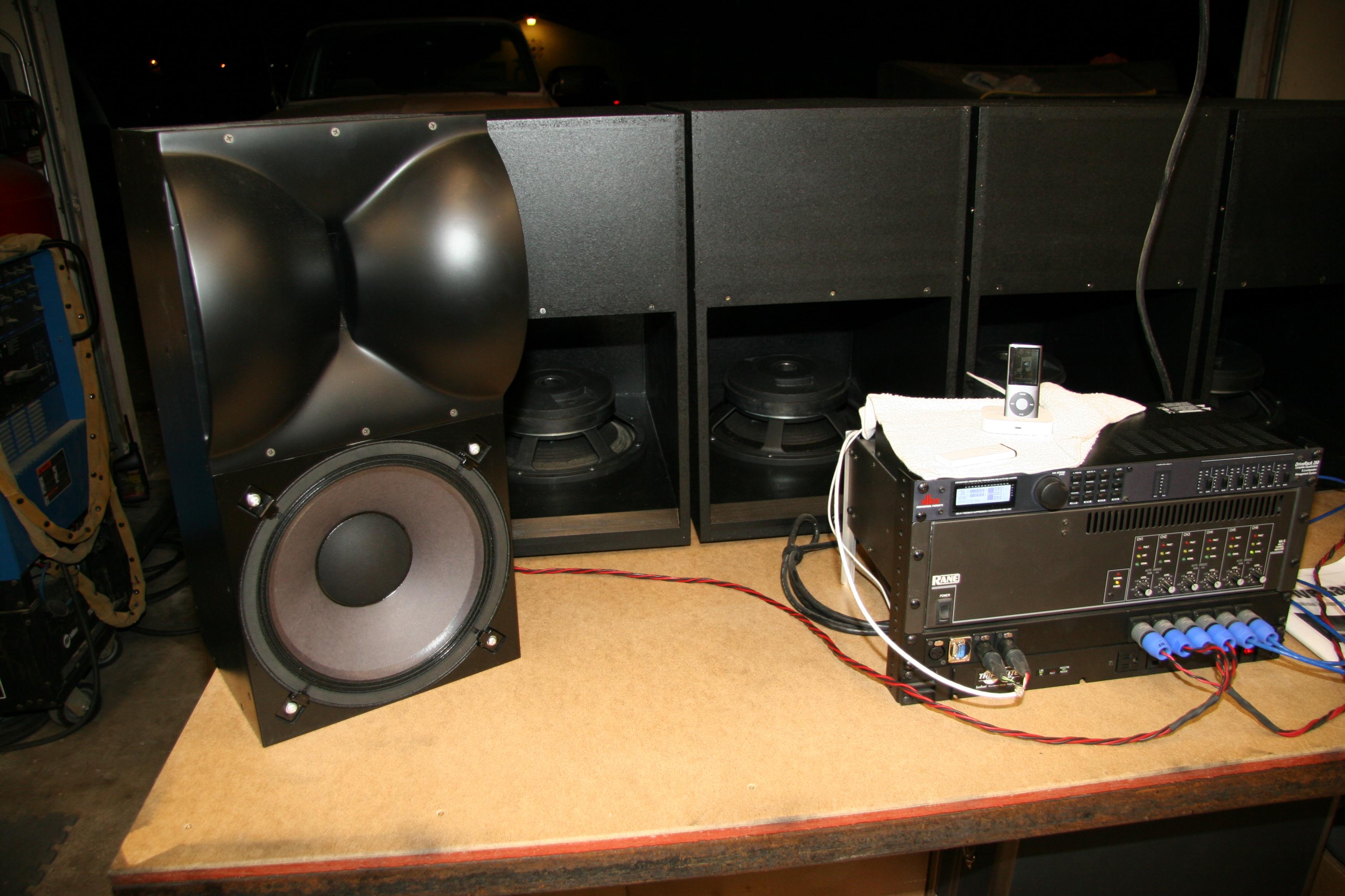

When I first built these (pictured) I had JBL 2404H's in them. Now they have JBL 2206J's in them. They sound better with the 2206's and they play stupid loud, though not with the easy test anything rig in the picture. It's the best use for these drivers I have come up with yet.
It's amazing how physically strong these drivers are. When you watch the cone motion as compared to the sound output you just can't help but thinking they are going to break at the voice coil former/cone junction, but they don't.
Two of them on the ground have a measured smooth rising response of about 10dB from 30 to 140Hz at about 4 meters. I need to measure the four of them and then build about six more. 🙂

The 2204 sounds better than the 2206 as a direct radiator, but the 2206 works better in a tapped horn.

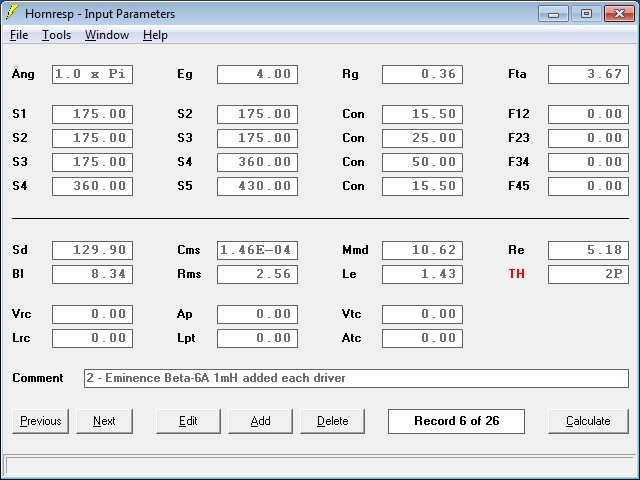

Here is a compact tapped horn. Uses two Eminence Beta-6A woofers. The Beta-6A woofers are little monsters compared to the previous drivers Eminence made. In the T/S parameters I entered 1.43mH for the voice coil inductance to reflect adding a 1mH coil in series with each driver. This was to flatten the response. Should be usable from 80Hz to 300Hz. Lastly, since the drivers are in parallel the input voltage should be 2V instead of 4V. I forgot to change that. I haven't built it yet, but hope to sometime this summer. just too busy right now.
I never saw any of your speaker design plans shared with audio community,or I missed somehow.
