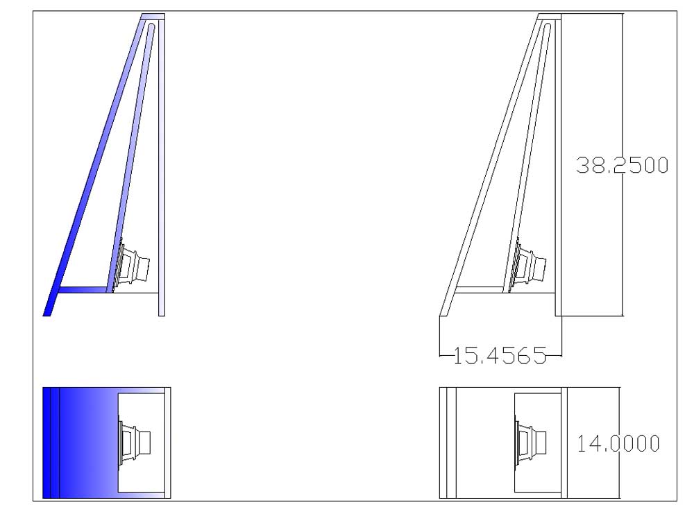

I've designed a new box that incorporates a humongous mouth. In addition, it's explicitly designed for corner loading. In fact the computer simulation assumes that the mouth extends over a foot into the room.
Here's a thumbnail of the design:
download blueprint here
All the dimensions are in the pic. The simulations were performed with the exact same box, and two different woofers. The first is a P-Audio SN-12MB which costs about $150 from Loudspeakers Plus. The second simulation is a quad of MCM 55-2421s. You can get four of them for about $120 from MCM. The MCM offers a lot more output, but the box will be a lot heavier too. The B&C 12" that's used in the TH-Mini will probably work too. Out of respect for Tom's business, I didn't offer any plans for that.
I really wasn't trying to clone the TH-Mini with this design, even though it looks *very* similar. I was just trying to improve on the design that I offered here a year ago. I've noticed that there's a lot of tapped horn designs floating around that look cool on paper, but won't actually work in the real world. It's fun to play with horn response, the tricky part is actually folding the horn and cramming it into a box. I intentionally chose dimensions that are pleasing, as the tapped horn I'm using now is ugly as sin. I'm hoping this one won't look as ridiculous as the last one!

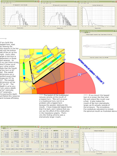

Without further ado, here are the pics. The first pic compares the efficiency of both designs. From 40hz to 100hz, the MCM is about 4db more efficient, mostly due to the 2ohm load.
The second pic is the box diagram. It has a shorter pathlength. The external dimensions are 24" x 24" x 9.5". That's a hair over three cubic feet.
There is always a compimise between ultimate efficiency(dynamics) and bass extention. It's usually better to lean toward dynamics. A Tapped horn built properly should out do anything when it comes to dynamics. My guess is the first one you heard was comprimised too much in the name of extention and so lost the slam. My design for the TB may be also, I'll have to see. It has more power handeling and excursion than anyone will ever use in their livingroom from what I can see. If you consider how many drivers your using and the time and wood used my design ends up being cheaper too. 120db literaly hurts! So if you hit that your golden!

Here's some pics of the boxes. I noticed in the diagram I forgot to include the height of the mouth! It's sixteen inches tall. The first box is 13.5" wide, the second is 9.5" wide.
The simulation for the P-Audio is based on a width of 12", but then I noticed the frame is 12.25". Shouldn't make a big difference in the response...
Based on a discussion here, I threw together a pic of what this box would sound like if I didn't use a flare at the mouth.
The idea is that using a significant flare at the mouth flattens the response, while raising the F3. Since this box will likely end up in a car, a low F3 is actually a bad thing (due to cabin gain.)
Flatter response and a small box are definitely what we're after here.
