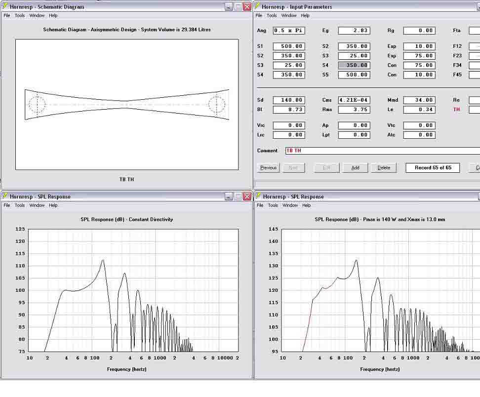

Quote:...Try designing a TH with Tang Band's 6.5" subwoofer. You can get response flat down to 30hz and output well in exess of 120db in a box less than 1cuft!...
Would you mind sharing that design, so far nobody has gotten even remotely close to anything like that with a "Tang Band 6.5"".
I agree with brsanko - the most interesting tapped horns are the ones which use miniature drivers. I'll take three or four tapped horns with 8" or 6.5" drivers over a single tapped horn with a twelve or a ten any day.
While a 6.5" tapped horn won't shake the house, four of them will, and deliver flatter response.
I am currently using a tapped horn with an eight, two bandpass subs, and five sealed subs (a total of eight subs.)
Here's the response of a tapped horn with the TB 6.5" driver:
http://www.diyaudio.com/forums/showthread.php?postid=1787188#post1787188
Look for more posts by that author, he posted dimensions, predicted response, etc...

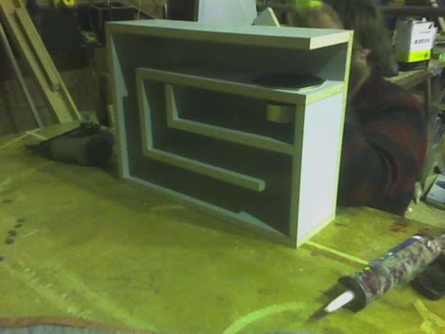

Here's a pic of the tapped horn in question:
I ran some tests on it, and found that it's not behaving like the model would predict. I did some thinking about this, and I think it's because the mouth is so small. In a 'normal' horn you can get away with this to some extent, but in a tapped horn you have the woofer itself sitting in the mouth, so it's a good idea to use a dramatic flare at the mouth.
Does that make sense? Tapped horns can still be made very VERY small, but you need to compensate for that big hunk of steel and iron that's taking up bunch of space at the mouth.

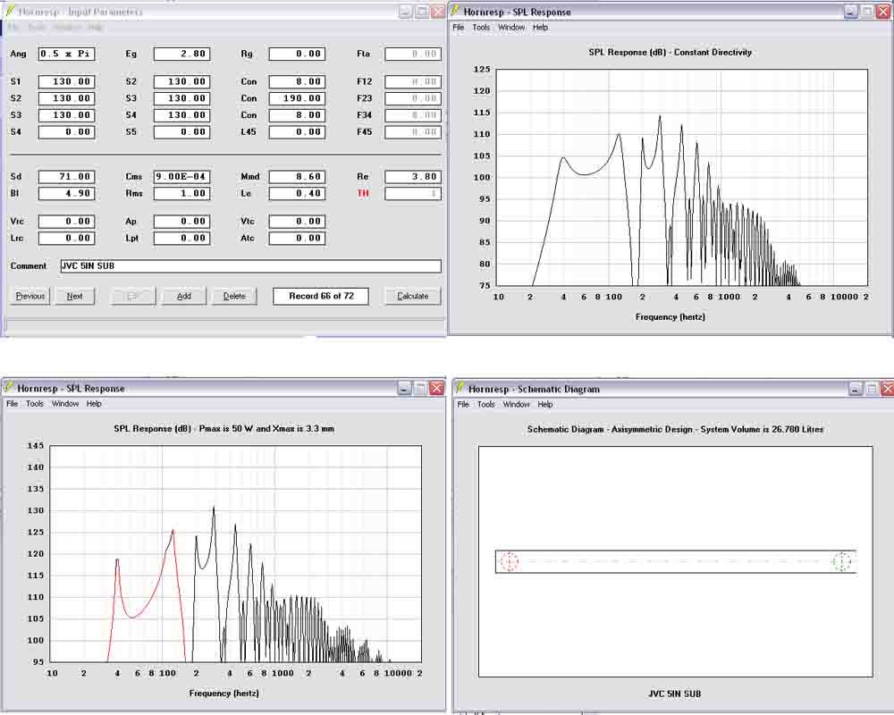

Well here's some pis of a very small tapped horn I designed and had built from a 5" driver from a JVC HTIB system. I will post the design I came up with for the TB 6.5 as soon as I draw it up again. I sell my computers and I have lost a few HDDs lately so I will have to model it again. As soon as I have the $50 for one of those drivers I will build it up for sure.

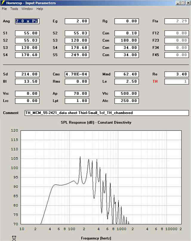

Hi Patrick,
I have wondered about the end effect of the TH mouth for a while, but I always come back to the assumption, that Hornresp already accounts for end effects, and the corner loading effect as well. If it does than adding an additional spherical mouth as you illustrated would lead to an incorrect model. Bye the way, I could not read the Hornresp input screens, and the "download blueprint" link didn't work. I do like the general concept of increasing the flare rate at the mouth, that gives another degreee of freedom in the layout, and usually an increase in output level.
As to the Danley TH-Mini, the driver is mounted at the bottom of the mouth flare, this would indicate a folding scheme more along the lines of the SPUD (?). I have tried a number of different foldings, and I just cannot tame the peakiness in the response of the MCM 55-2421 unless I increase the compression beyond 3:1. I like the basically 2'*2'*set-width-to-match-sectional-areas box format for its good use of wood, and easy portability.
The task of converting a model into an enclosure drawing is made a lot easier if one has a CAD program with the ability to insert and manipulate blocks (e.g.: speakers), make multiple copies without having to redraw, rotate items, measure, etc.. I'm just using an old copy of ACAD, and cannot imagine to build anything without a CAD program anymore (did we actually do that? 🙂).
Thanks for all the inspiraton, attached a 1cft version of the TH with MCM 55-2421, not the smallest TH, but came out better than I thought it would (on paper that is).
