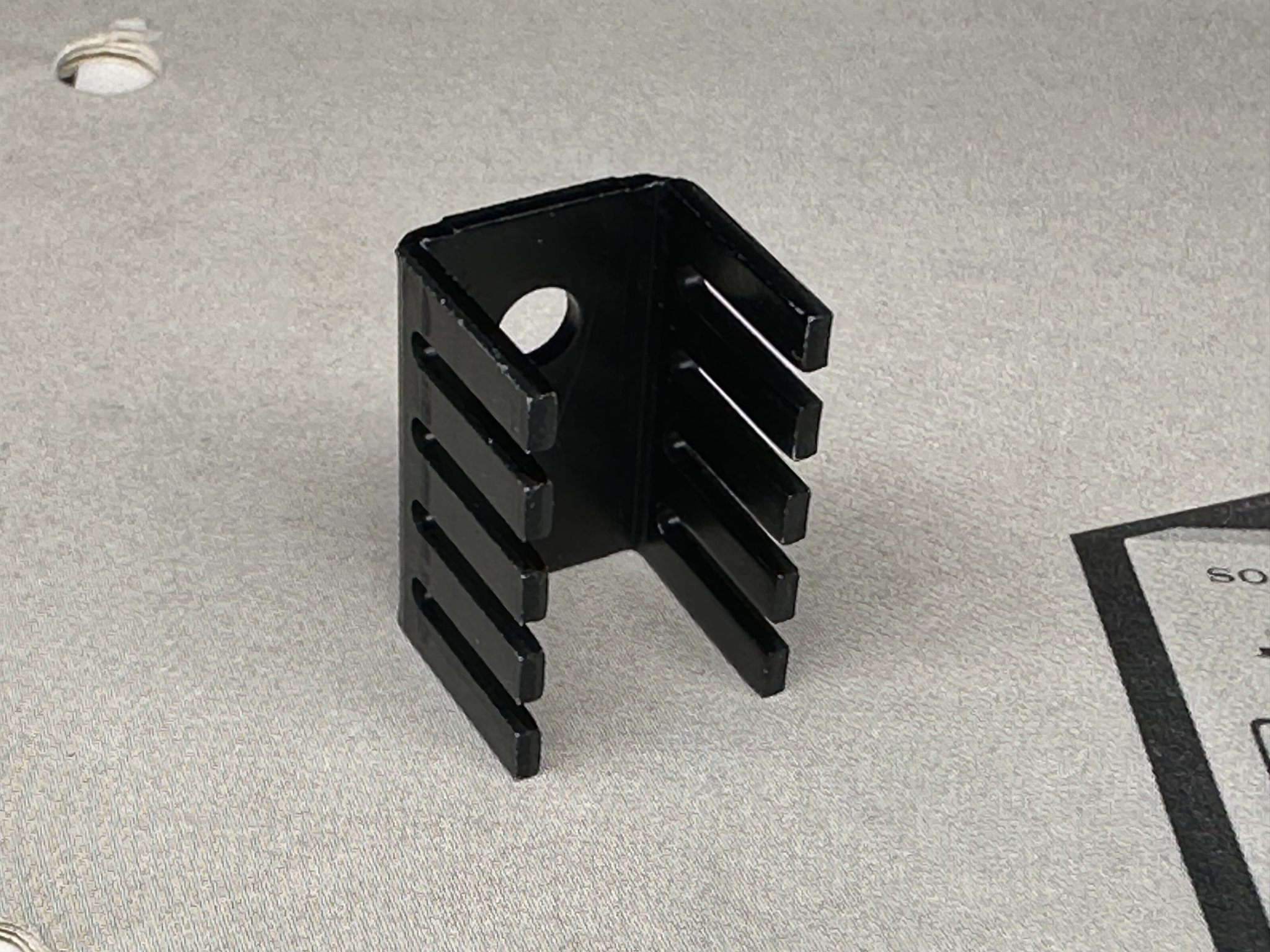

Hello everyone,
I would like to know if it is OK not to solder the heatsinks to the SLB pcb that have the BD139/140 transistors attached to them. I am hoping for a "yes" answer, as I will have to disassemble a lot of pieces on my build to solder them in place. Thanks for the help,
MM
You don’t need those heatsinks at all, you can use small clip/bolt on sinks.

Thanks Vunce,
I built these 2 dual rail SLB's quite awhile ago using the larger SK104 type heat sinks. I was hooking up the grounding cables and cables from the SLB to the AN amp board and I noticed that I have not soldered the SK104 heat sink posts to the SLB board.
I am getting ready for a power up, and I am wondering if soldering of the heat sinks to the pcb is mandatory?
MM
Thanks for the explanation Hugh. I looked up what galvanic isolation is, and why it is used. I looked at the circuit layout posted by X in post #1, and it looks like there is no direct connections to the heat sink pins.
Anyways, I am just glad that I do not have to remove the SLB and their heat sinks just to solder the heat sink pins. Pretty tight fit in my enclosure. I am planning to post a picture when I have it ready for power up.
