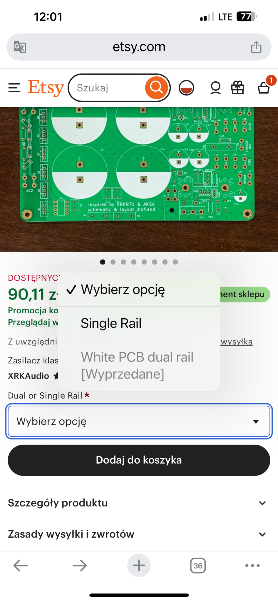

A new batch of dual rail SLB's has just been ordered - I should have them back in stock in a few weeks.
Yes, you are correct...the picture shows a double rail but the choice menu allows one to order a single rail.
Thank you

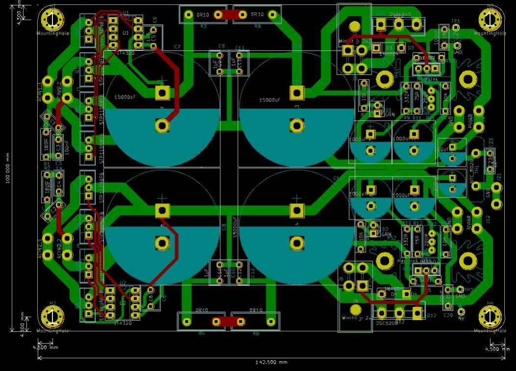

Hi all, what are the dimensions of the dual rail PCB? I'm looking at this for a retrofit project.
Apologies for what is most likely a repeat question, but google didn't have an answer 🙂
Thank you!

Thank you Anand. The PCB would fit in my project.
I did not see the dimension lines on my phone display, sorry about that
Hi🙂 Only single rail is still available…They should arrive any day now - I think should be available to place orders.
