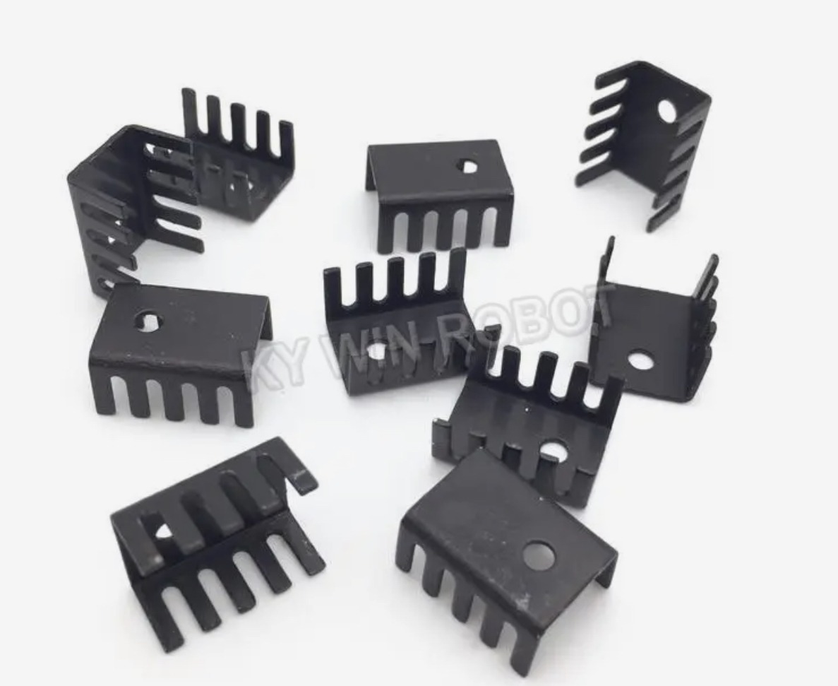

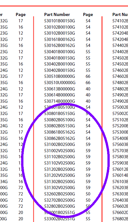

Hi X, while ordering the parts for two dul-rails SLBs, I couldn't find the heatsink that is specified in the BOM (AAVID 531192B02500G). As there is no further specification in the BOM, I'm guessing which alternative partnumber would fit. Do you have som specs for it: size, thermal transfer? Would part number 531102B02500G (mouser) fit?
Thanks for your help.
Christophe
Christophe
Hi Christophe,
The BD139/140 BJT's do not get hot, you can use a small clip/bolt on heatsink. (I’ve even run them naked in the SLB😁)
https://octopart.com/577202b00000g-aavid+thermalloy-59858

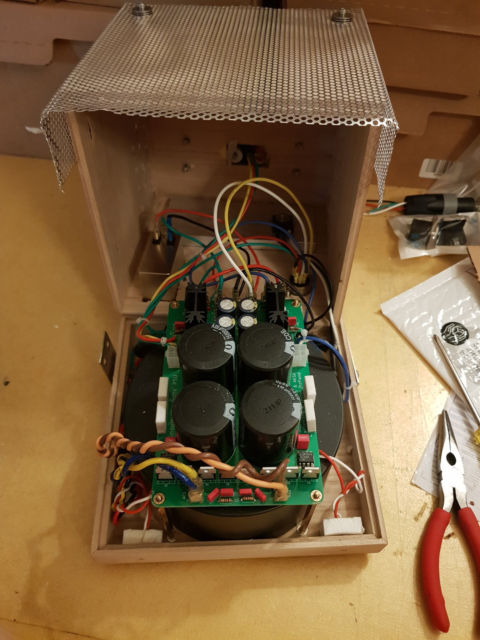

They said that wood case has safety problem.

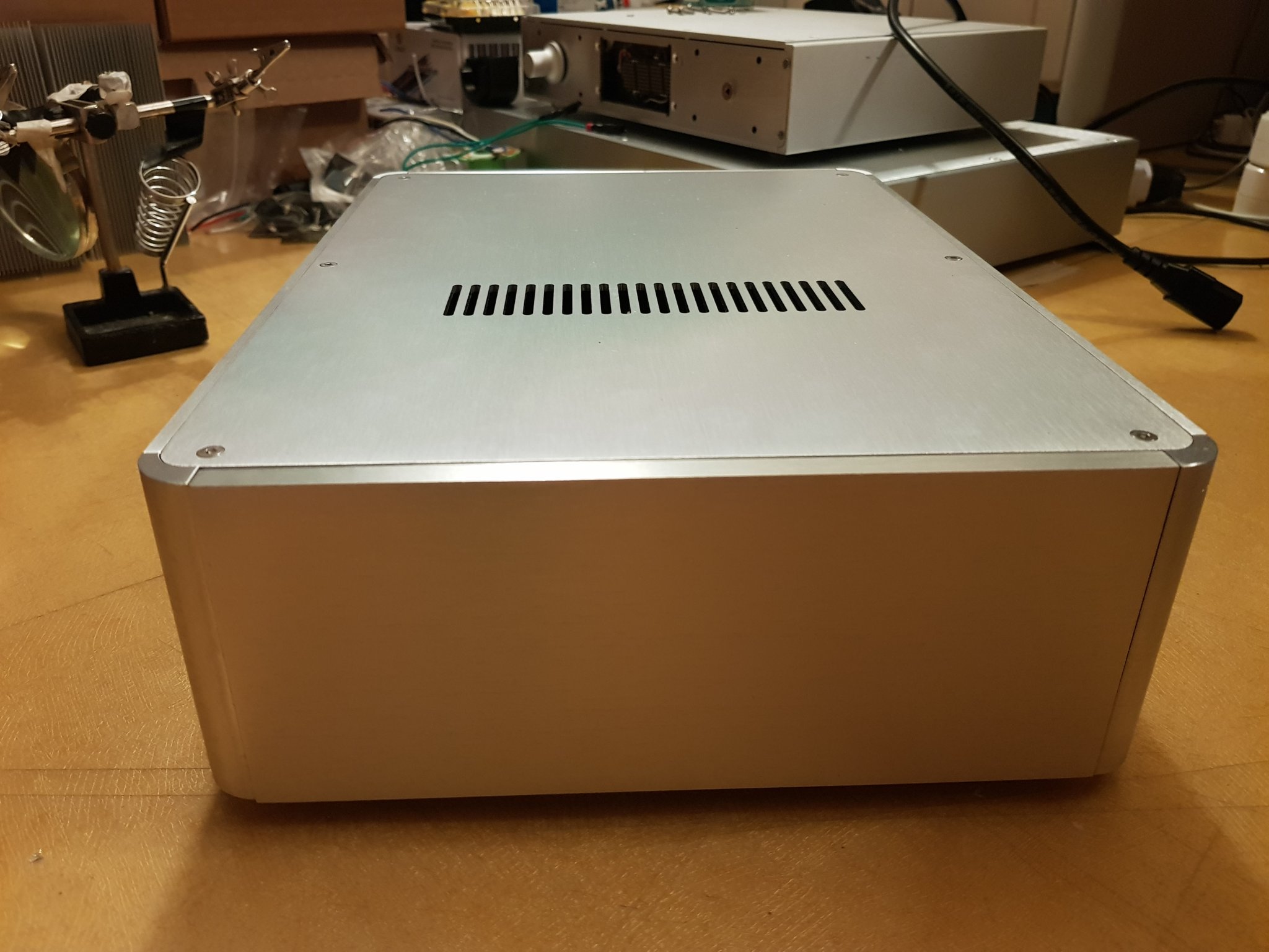

I've move my SLB in a wood case to a aluminium chassis.

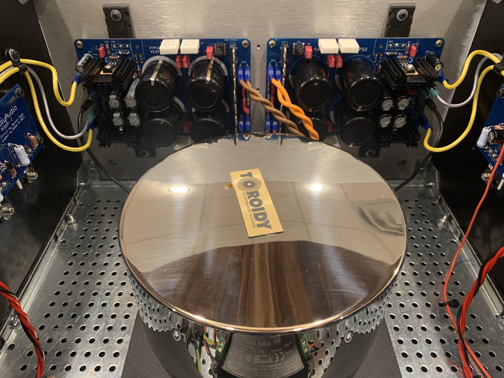

Hi X, Vunce, other builders,

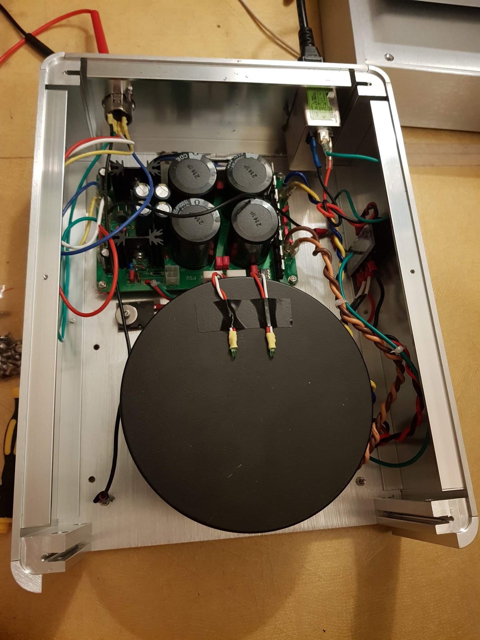

I would prefer to keep the dual rail SLB boards in a position where the caps are vertical, and would like to attach the transistors and the board to a heatsink. The heatsink I have in mind for the psu is an " aluminum slab with an area just slightly larger than the psu board ". No fins on the al slab. The al slab is 3/8" thick. So idea is to bolt this slab to the chassis base and use 1/4" standoff for the board, and attach the transistors to the surface of the aluminum.
So, do you think this is enough sink for the 2 power transistors?
I have the aluminum already from years ago, so would like to use it up. If needed I can add some 1/4" thick copper slab to the aluminum and mount the transistors to the copper. Copper is 1/4T 7"L x 2"W, and can be cut easily.
Comments and idea's are welcome.
Cheers
Cheers

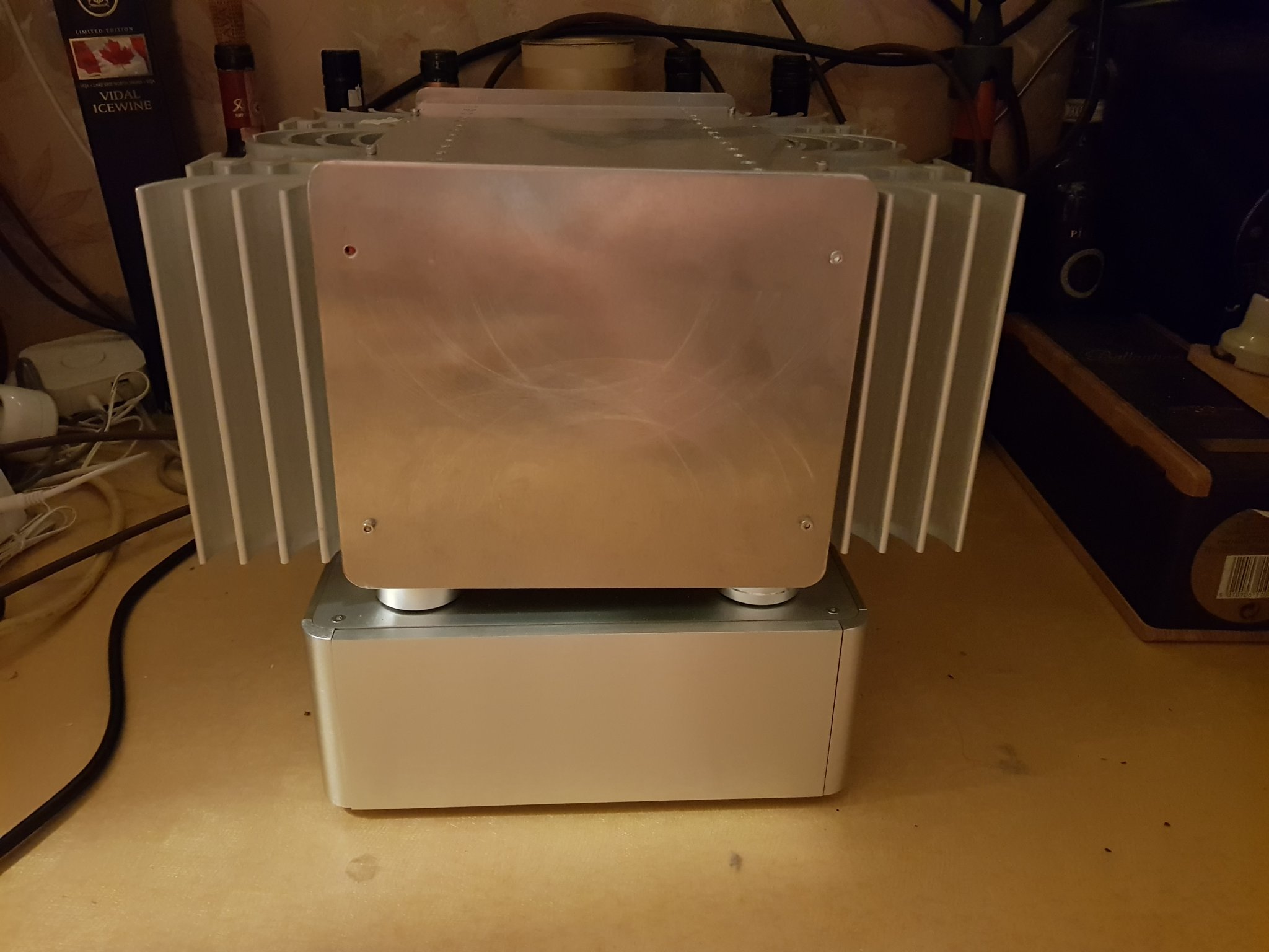

The above is a pic from my NPXP, when I had the Aleph J. Each Aleph J draws roughly 100 watts/ch and a bias current ~2A/ch (+/- 24V supply). That being said my front panel in this 5U (10mm thick which is roughly 3/8 inch thick) reached about 40 degrees C (some of this temperature rise I am sure is bleeding over from the Aleph J boards themselves!). You’ll see the panel is a bit bigger than the outer edges of the BJT transistors in the capacitance multipliers which will get warm but not hot.
As such, much of this depends on the LOAD you are imposing on the SLB supply board.
For what amplifier design is this for?
Best,
Anand.
Thanks Anand. It is for the Alpha Nirvana. Will be using CPU coolers for the amp transistors. I think the AN operates on a +/- 27V supply and about 1.7A x2 for a total of 92W/ch pretty close to your 100W per channel. It will be dual mono, so chassis will be large.
Having the big caps hanging like that makes me nervous, hence the preference of mounting flat on the aluminum slab.
Cheers
Cheers

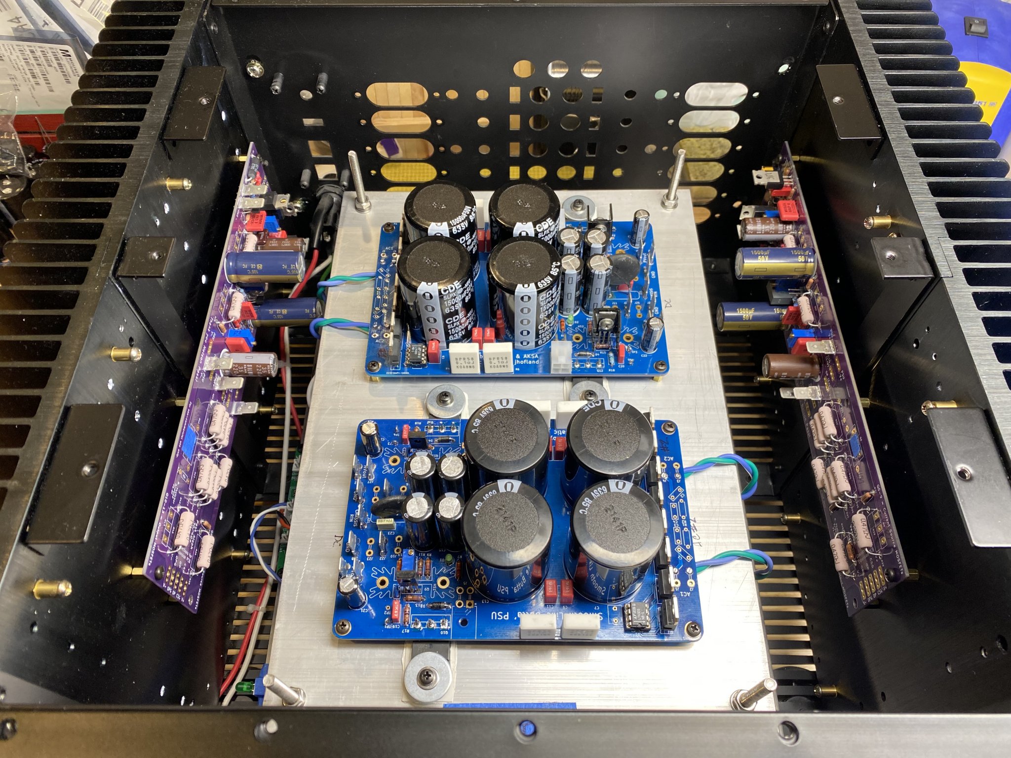

Thankfully the Mundorf’s have a very nice adhesive helping them stay on the board (and thankfully so does the solder!). I’ve had no issues personally. Moreover, when you mount vertically, convection helps in keeping the transistors cool.
An example that is more like what you want is from Vunce in his Aleph 30 build
Best,
Anand
Best,
Anand
I have a tube of the RTV silicone that could be used for adhesive. Will have to see if it is OK for the caps. Vunce's build is interesting also. Is your adhesive underneath the cap or spread around the circumference of the cap bottom / pcb making a seal? Hard to tell, your build is so neat/impeccable work. I have a lot of thinking to do about placement of boards, coolers, etc inside the enclosure. Just trying to get a bunch of boards built first. Appreciate your idea's.
It’s spread around the circumference of the cap bottom making a seal. It’s actually integral to the design of the capacitor and meant for unusual mounting positions. Many manufacturers use RTV silicone without issue. Unless you expect the amplifier to be in a highly vibrational environment…
