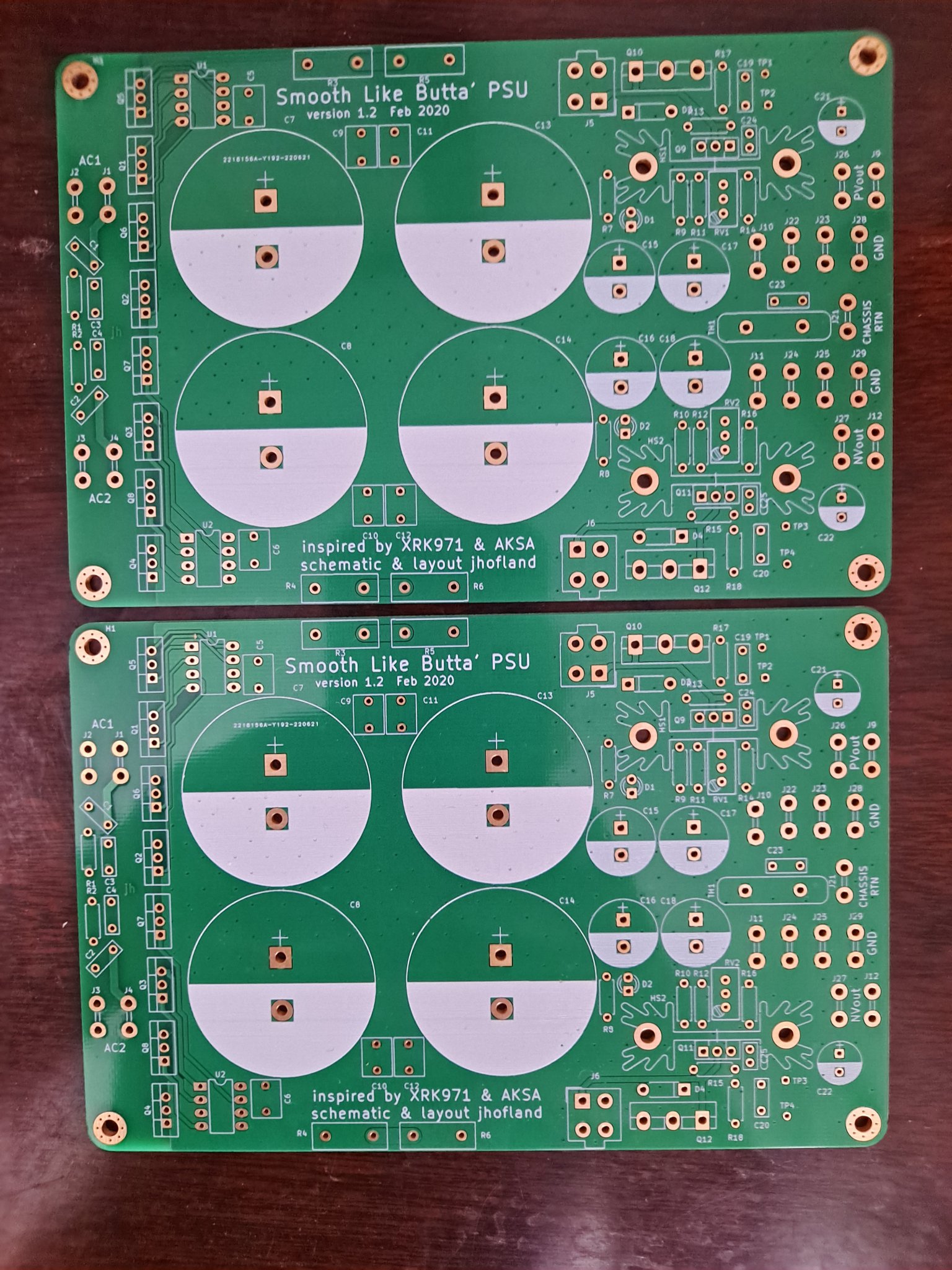

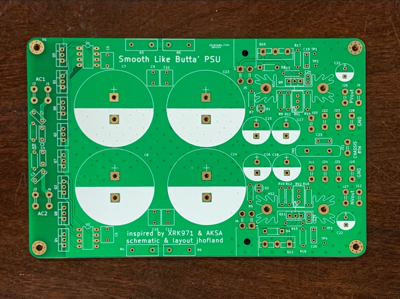

Hi again X, I will get the 2 pcb's from Mike, can you tell me if there are any differences from the original dual rail SLB as shown in post #135 of May 2019 and the version 1.2 dated Feb 2020 which Mike has got?
If so, can you point me to the relevant changes thanks again.
The only thing that might be different is the Molex connector for the off board BJTs. They were 90deg, the. 0deg (vertical), then back to 90deg.
If the board looks like this:
It’s the main one I have been selling for the last 3 years. It is the 90deg(horizontal) jack. Other than that nothing changed.
