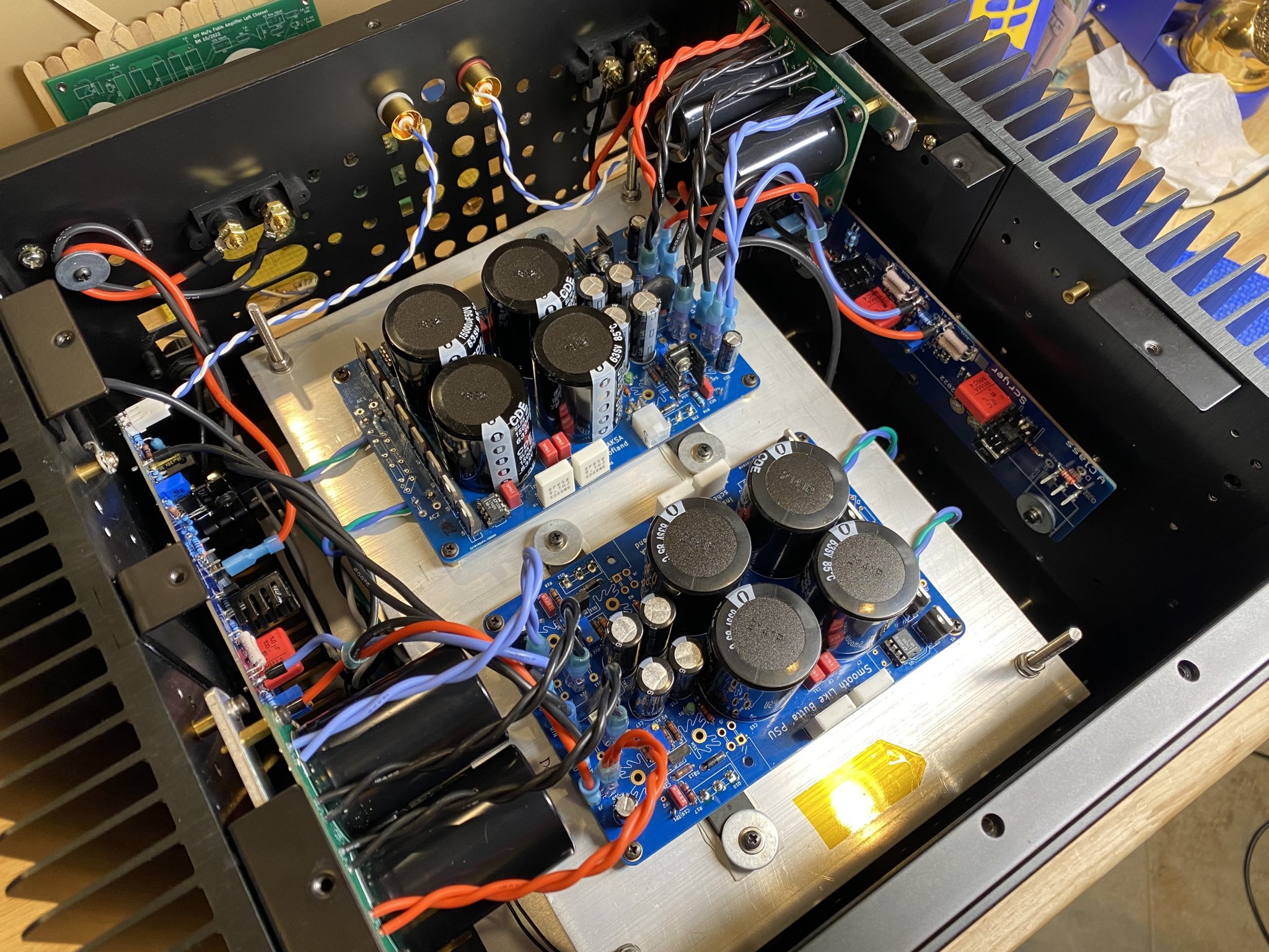

I started by testing the Toroidy transfomer first, all secondaries disconnected from the SLB:
  • DC resistance of all secondardies is less than what my DVM will measure (0.0 Ohm). Not unreasonable, since this is a high-power transformer.
  • DC resistance between the secondaries is "overload", which sounds good, too.
  • Brought up the transformer via Variac and bulb tester (can't afford blowing more fuses, because I must not run out of fuses on a weekend 😉). Bulb tester remains dark. All secondardies work fine, and give the same AC readings. Good, too.
  • Brought up the transformer without Variac and bulb tester. AC readings on the secondaries are fine (approx. 22 VAC). Good.
I continued by connecting the secondaries to the SLB, one after the other. Running everything through the bulb tester and ramping up the Variac slowly. DC outputs from SLB are fine. Tried again by adding a high-power load resistor to the SLB DC outputs, also works fine (yes voltage was a bit lower due to the load). Removed the Variac and bulb tester, everything still works fine.
Soooo, this means there's nothing really broken in the power supply, as it works fine. This is good news, sort of. However, why did it act up so badly yesterday? I hate when I can't reproduce the issue. Where would you guys look?
