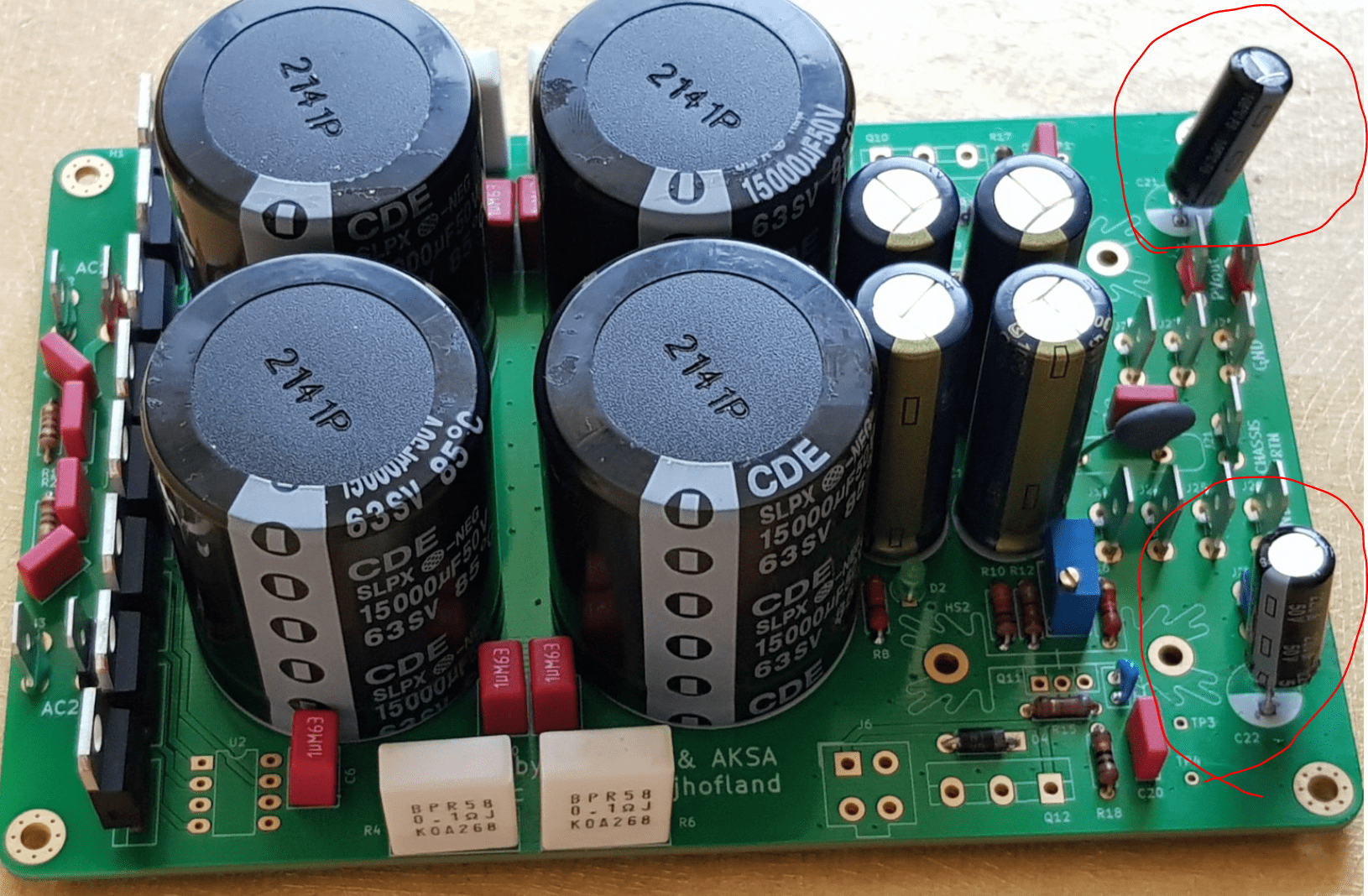

I am a newbie.
You can see the spaces between caps (C21, C22) and pcb in the image.
I wonder whehter it occures some problems?
It’s not a problem unless you subject your board to a lot of mechanical vibration. Ha I g the cap touching the board reduces flexing and prevents strain induced breakage of leads. But it should work fine for stationary amp. You can heat up solder and push to snug if you want. You can’t go the other way.

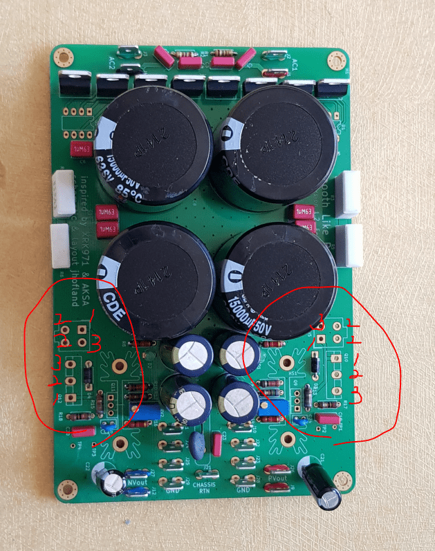

I am making a SLB with version 1.2 PCB.
I want to know this pin connections between the molex adapter and the transistor.
And I have done continuity test with multimeter but don't know whether the short state between pin 1 and 3 of molex adapter is right.
