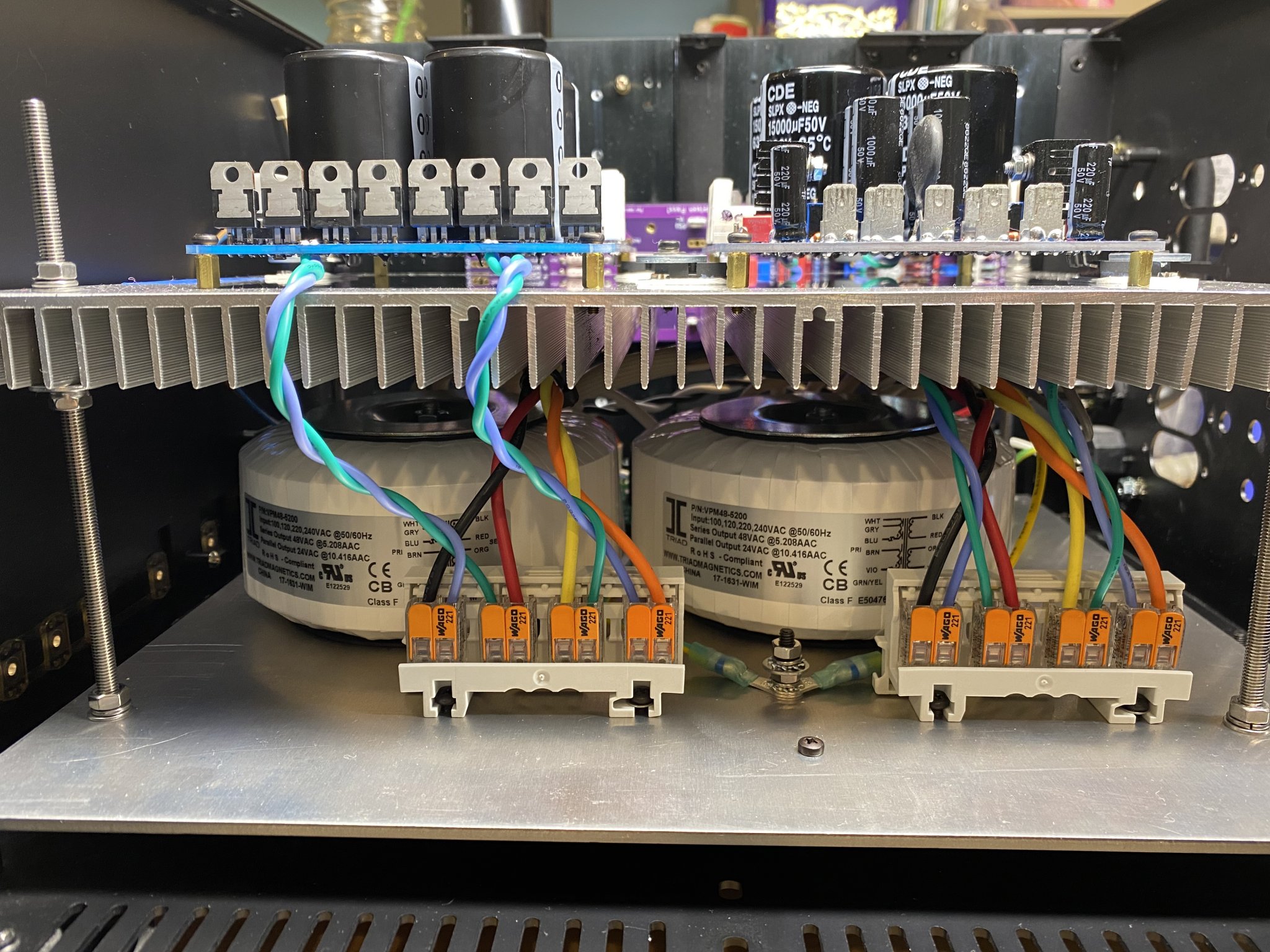

Vunce, those Wago terminal blocks look awesome. What series are they, or do you have a link to some?
Yeah, the Wago 221 connectors ROCK!! I found a Wago mounting bracket that holds 2, 3 and 5 sized connectors. Makes the wiring very neat.

Vunce,Yeah, the Wago 221 connectors ROCK!! I found a Wago mounting bracket that holds 2, 3 and 5 sized connectors. Makes the wiring very neat.

WAGO connectors do rock ! Love the execution. Really wanted to build those into my boards in lieu of faston's but darn if my BOM cost didn't skyrocket. Looking forward to getting many many free samples from WAGO @ IMTS this year.

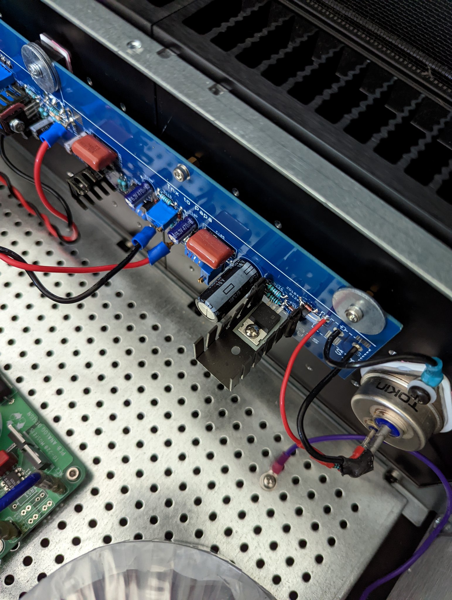

Hi Alan,I am trying the SLB on my Aleph J mono amps and am getting a large spike into the speakers when I shut the amps down. This doesn't happen when I power the Aleph J with the standard First Watt power supply, nor when I power my F6 boards with the SLB. Any idea why this happens with the Aleph J, and is there any way to alleviate it short of installing speaker protection boards?
Thanks,
Alan
I'm having the same turn-off spike in my recently completed SLB->Aleph J amplifier. For now, I connect speakers after amp is on and disconnect before shut-down. Wondering If you ended up installing speaker protection?
No, I didn't. I am going to try to back down the rails to ~24 volts. If that doesn't mitigation the issue, I'll go back to the standard first watt power supply that I was previously using.Hi Alan,
I’ve been thinking about your Aleph J/SLB turn-off spike noise, I wonder if you added some capacitance at the SLB output it would slow the power rails down at turn-off similar to a standard First Watt CRC psu.
Before you lower the voltage, add a 10000uF cap across each power rail. As built per schematic the output caps are 220uF, add the new caps in parallel to these.
Another thing I've noticed with this combination... with speakers connected the positive rail bleeds down very quickly while the negative rail takes some time. With speakers disconnected both rails bleed down together, very slowly.
This asymmetry in the bleed down was what I suspected as the source of the turn off thump. If we ask ourselves why the asymmetry is not there when it is on, it would indicate that the input stage swings positive when no more power is supplied. It might be that increasing the bulk capacitance above the positive input stage rail may help. Maybe increase the value of C4?
