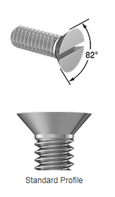

You could try (1) removing the pan head machine screw and replacing it with a flat head screw (triangular silhouette); and then (2) inserting the screw from the back, so the nut is on the TO-220 side of the assembly, and the head is on the trimpot side. This may reduce the overhang enough, to be able to access the trimmer's adjustment slot.

Good idea by Poseidonsvoice to flip the pot.
Good solution, Anand. It merely means the screw direction is reversed; CW is the new CCW.
