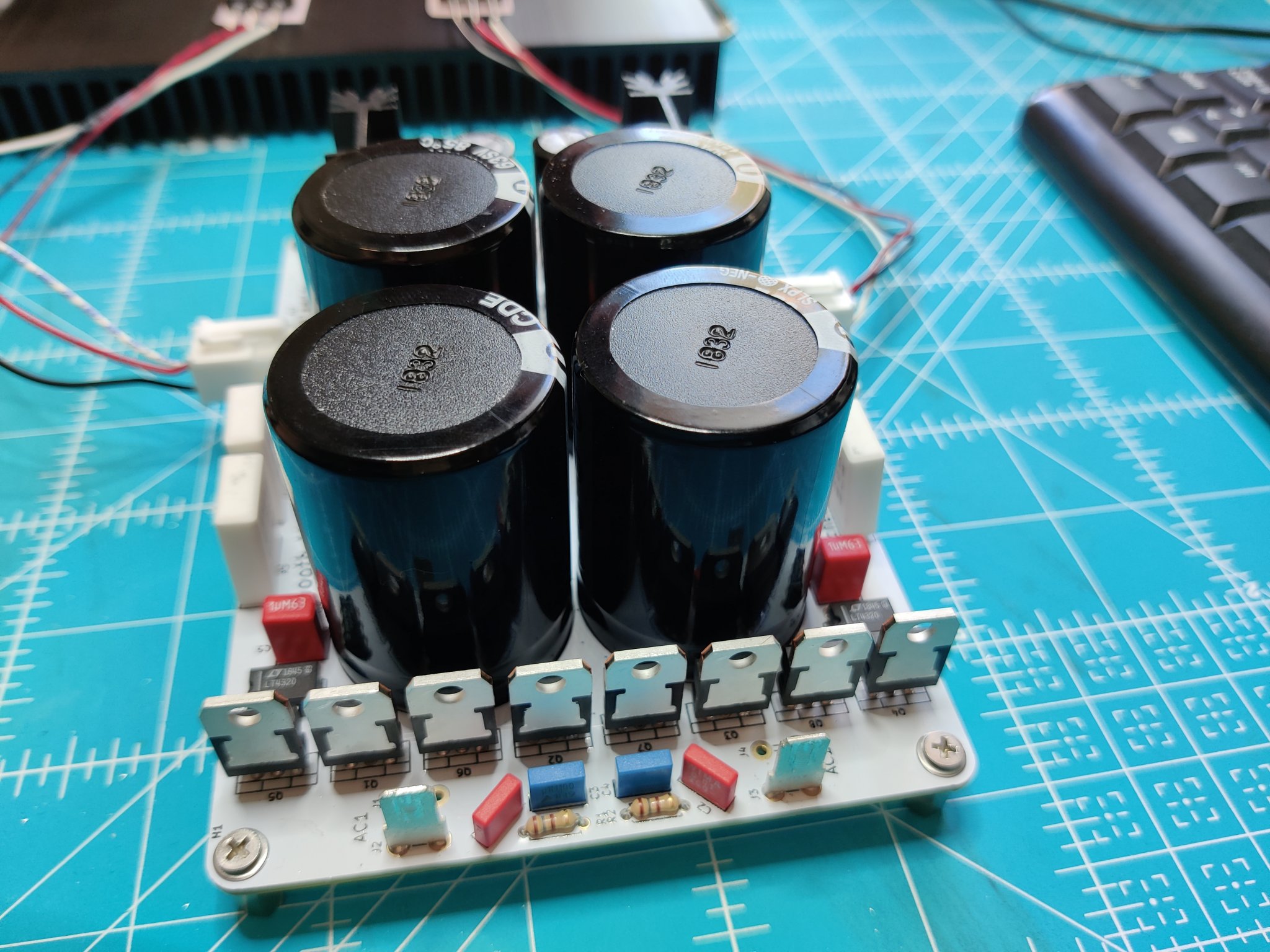

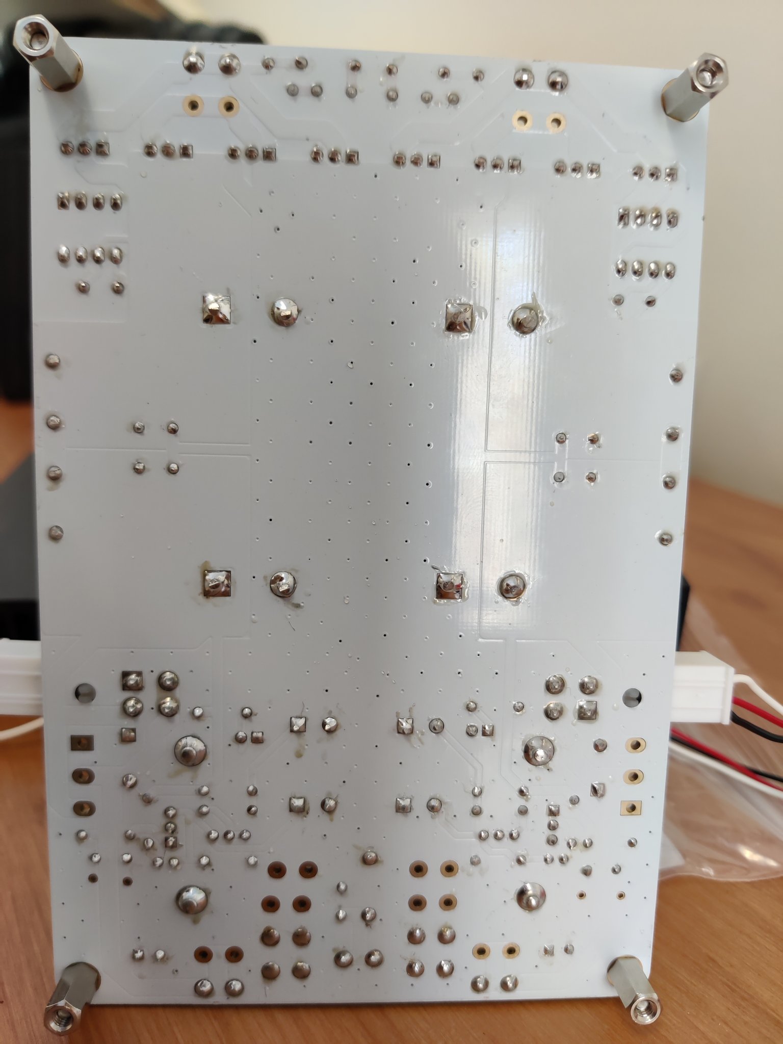

I'm afraid I'm going to have to ask for some guidance.
I populated first of my two double-rail SLB's yesterday, and proceeded to test it today, with not so great results.
For background, I will be using a soft start board in my amp, and have already completed that. In my testing with a light bulb it seems to work as intended. The board in question is the EU version of this design presented in post #545: https://www.diyaudio.com/community/...soft-start-h9kpxg.354971/page-28#post-6996675
I'm using a Triad 2X24V 250VA transformer. I measured that it is outputting the correct voltage before connecting the SLB.
Now, when I connect SLB and power up, the fuse (5A slow blow) on the soft start board blows within a few seconds. Output voltage from the SLB rises to about 15V but doesn't have the time to stabilize.
There was no smoke, no smell, and visually I don't see anything wrong. The soft start still works when I use it with the light bulb. The build itself I felt was quite straightforward, the one thing that left me with an uneasy feeling was the orientation of Q9 and Q11. On the BD139 was clearer, with the metal plate to go against the heat sink, but on the BD14016 I didn't see an obvious way to tell which is pin 1, even from the datasheet. I installed it "visually" the same way as the BD139.

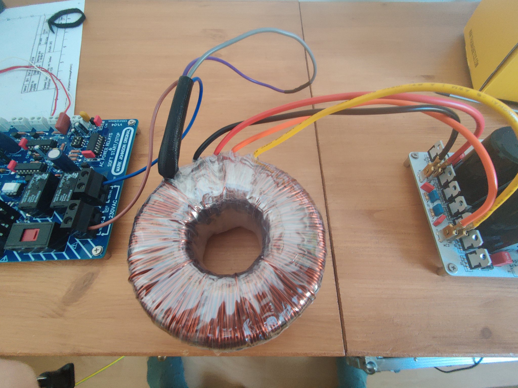

I'm attaching a few photos, perhaps you can immediately see something amiss?
IMG_20220417_130249.jpgIMG_20220417_123103.jpgIMG_20220417_123428.jpgIMG_20220417_123436.jpgIMG_20220417_123450.jpgIMG_20220417_123513.jpg
Hi Niko,
Looks like your SLB AC input is incorrectly connected. The SLB requires a transformer with 2 secondary windings.
Secondary#1 connects to AC1 (J1/J2) and secondary#2 connects to AC2 (J3/J4).

Somehow I completely overlooked that. I saw it in the schematics, and for some reason thought it was optional... Luckily that is easy to fix. I'll make the correction and report back.

Thanks @xrk971! I'm hoping everything is still OK as well. The transformer I have is a dual secondary one. I just happened to have a brain fart and connected the secondaries in series like I had done in some earlier projects...
OK, I fixed the transformer connection. No more fuses blowing, but things aren't quite right yet either...
First of all, I think I indeed have wrong transformers. These are 24V with secondaries in series, 12V in parallel. Since I had failed to understand the way the transformers are meant to be connected (although it is mentioned here several times, I believe...) I think I have now transformers that produce half the voltage they should.
Secondly, I measure 16,7V on NVout, and 0,2V on PVout (between ground and the respective terminal). I'll need to go round the board and take a bunch of measurements to see what is going on.
Thanks for the photo - helpful, but I have the impression this has two independent secondaries, perhaps each 12Vac?
If so, as you mentioned, not enough volts. You need about 25Vac from each winding if you are using the SLB since it will drop about four volts.
Do you have a schematic and color code from the transformer manufacturer?

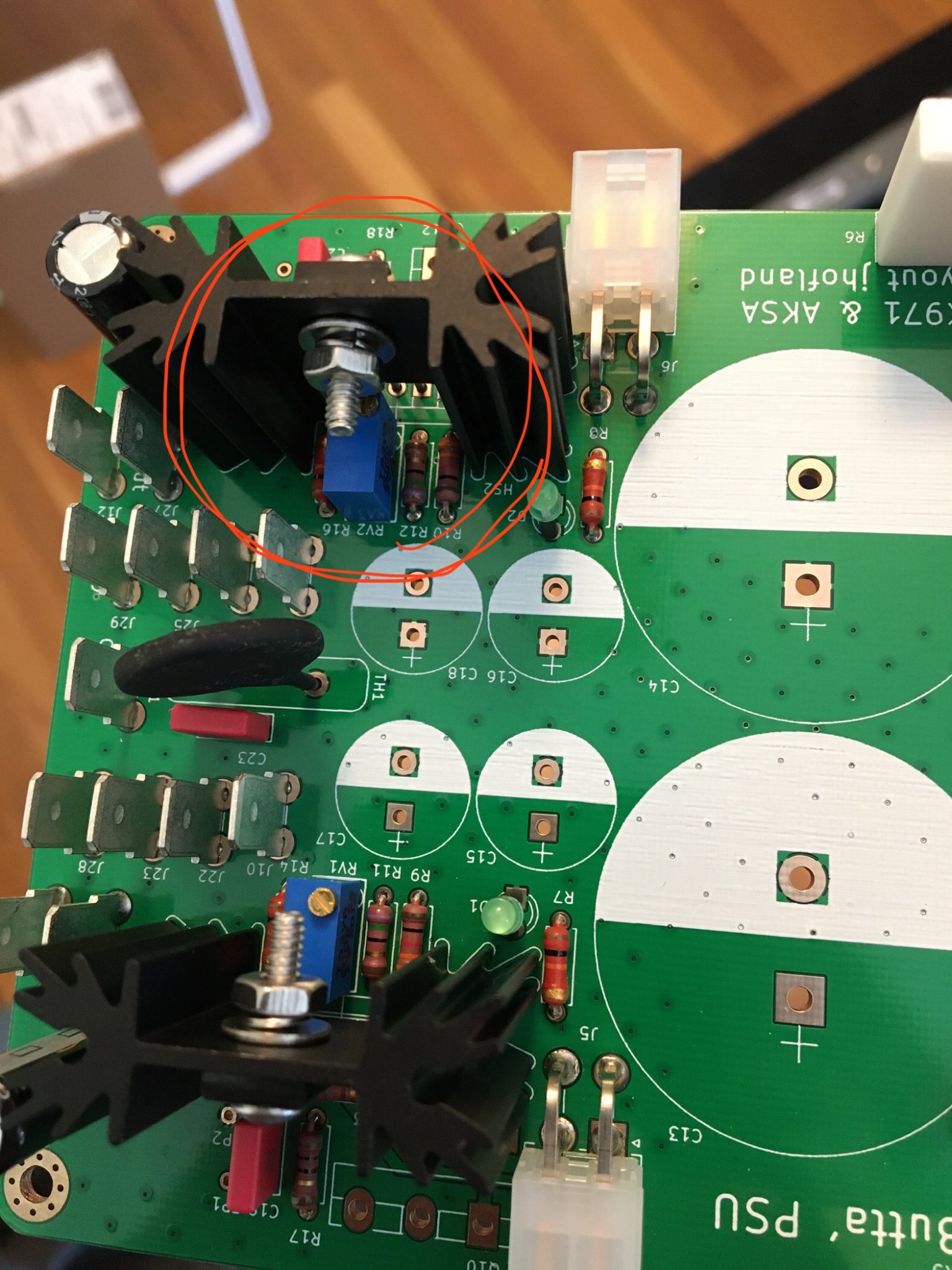

I was just dry fitting my Q9 & Q11 transistor/heatsink assemblies, and noticed that when they're soldered in place, the adjustment screw on RV2 will be inaccessible because the mounting screw for Q11 is directly above it. How do you adjust RV2 once these are soldered?
Has anyone else run into this problem or did I do something wrong?
You didn’t do anything wrong. It’s a small oversight from the original board design. I have been recommending folks (like Sledwards did in his Alpha Nirvana build you have seen on the AN thread) that they flip RV2 around so that the screw is accessible. It won’t affect anything. You’ll just twist the screw the other way while you are setting your output voltage.
Good on you for picking up on this in advance of soldering.
And just so you know, both RV1 and RV2 only adjust the output voltages by about +/- 1.5V tops. The best way to adjust them, is to hook up your scope on the output of the power supplies and adjust the voltage for lowest voltage ripple (which is already uber low anyway…like <2 mV). Don’t worry about this too much if you don’t have a scope. Just set and it and forget it (famous rotisserie infomercial!).
