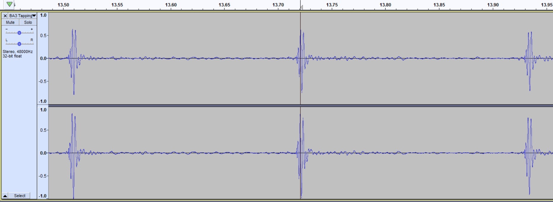

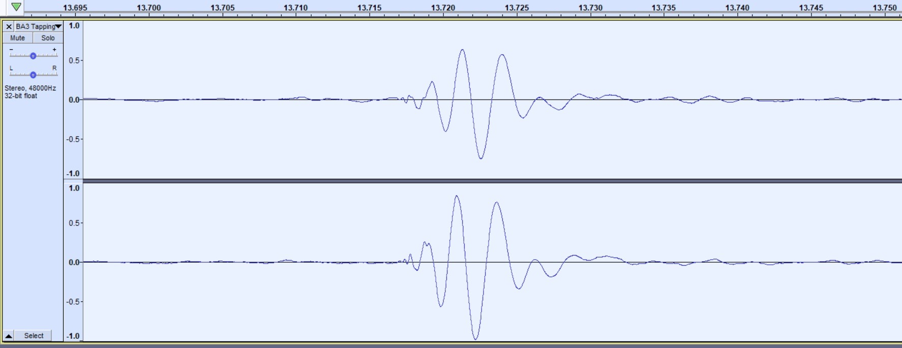

Thanks for the video. I looked at the sound file on Audacity and I suppose this might be similar to what an O-scope will see. The FFT says that the pulses have about a 390Hz frequency, they are spaced at about 4.7Hz an have an exponential rise and decay envelope. Not an high impulse followed by a decay.
The 4.7Hz sounds like a frequency that might match the time constant of the BA3 input stage coupling caps and input resistor. Could it be that you have DC somewhere that is charging the caps, and at some point, the charge is released?
Is there a discharge bleeder resistor on your input cap? If you ground your RCA inputs does the sound still remain?
I suspect that this is not a PSU problem but something in the amp input stage.

Fascinating information XRK, I appreciate the effort. I did for awhile have 1v of DC before the FE output cap but I have since zeroed that offset and the sound remains in both channels. The sound also remains when I plug in a preamp that is grounded and the noise floor does not change...meaning no additional hums or buzzes or static appears. There is no input cap in this design and there are 3 resistors to ground on the FE board per side.
