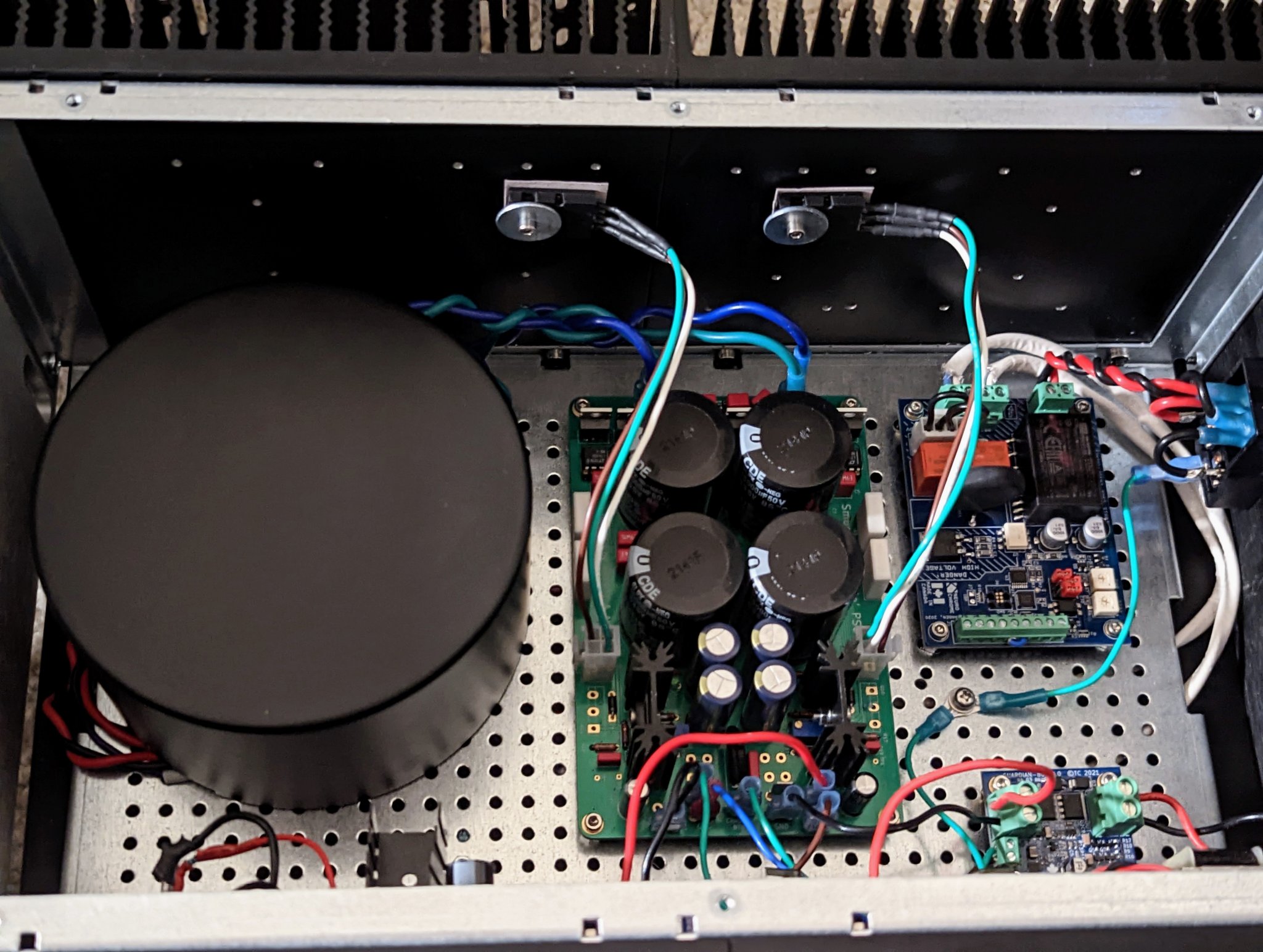

Well, it seems I got the pass transistors right since it's playing beautiful music right now -- if I hadn't got it right, it wouldn't work at all, right? Hopefully. 😂
The great news is that it seems to have solved my low-level humming issue (probably due to low PSRR in the amp). Getting around +/-23.3VDC with 20VAC 300VA Anteks.
Hi Sp33ls,
Glad you got it working! The fact that the low level hum is gone and the voltage appears to be correct means it is working. The transistors should be warm but not hot. If it was mis-wired it would not work or you would have smoke. Many SE Class A amps don’t have the best PSRR so the SLB will help to make the background quiet. Is that a speaker protect or soft start board you have mounted next to it?
Works it does. I'm very thankful to everyone who helped make this one possible, too. I love not being able to discern whether the amp is on or not when your ear is pressed to the speaker cone lol.Glad you got it working! The fact that the low level hum is gone and the voltage appears to be correct means it is working.
Correct! Neurochrome goodies. Recently picked up the ISS (soft start) to go alongside the speaker protection, and I'm very happy with both.Is that a speaker protect or soft start board you have mounted next to it?

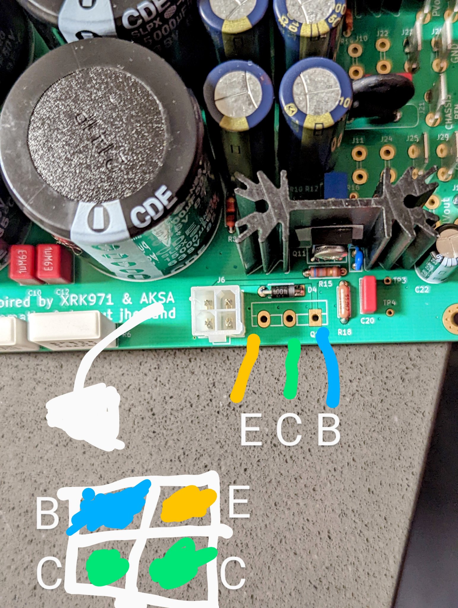

Sigh, so I let the magic smoke go tonight...Do you have Q10/Q12 properly connected, if not when a load is connected to the output R17/R18 will let the magic smoke out.
I somehow managed to forget to connect Q10 after double-checking my connections... >.>

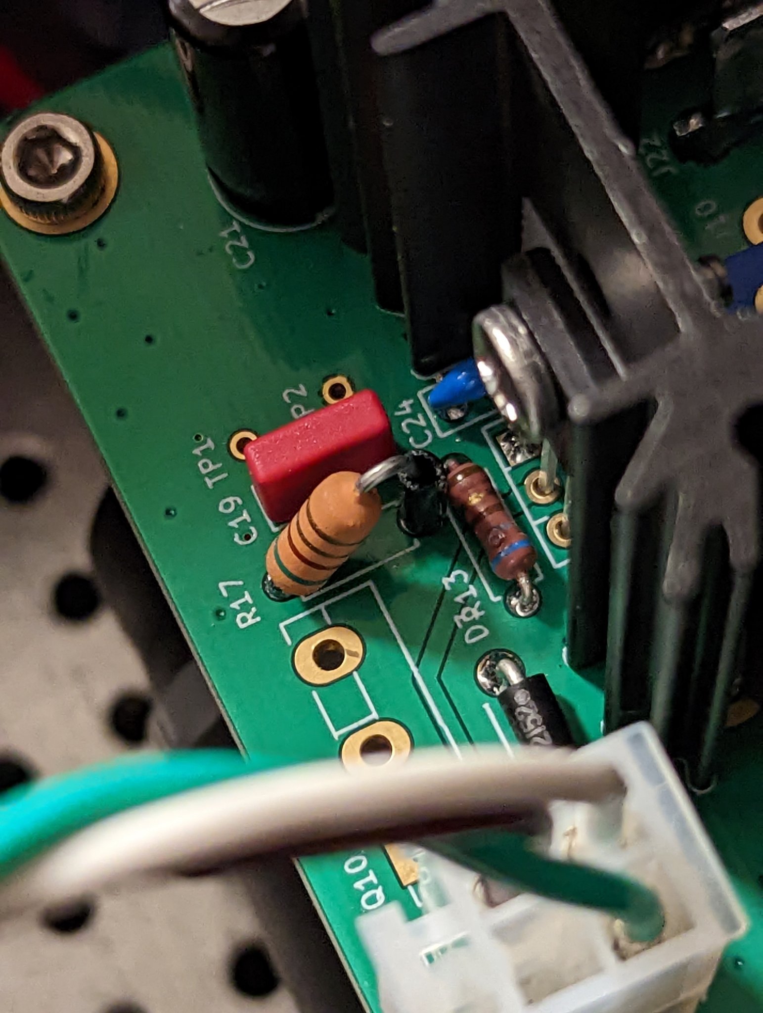

R13 was burned and measured 15R less than it should.
I've since removed R13 and tried to remove that scent with isopropyl. Burnt resistors is a strong scent lol.
R17 seems to still measure about 5R (in circuit). I also removed D3 & R7, and both still appear to be fine, but going to replace them both anyhow.
Is there anything else I should replace while I'm at it, or do you suspect R17 took one for the team?
The good news is that swapping in my other SLB board results in the amp working as expected.
Well, I replaced R13, only for R17 (4R75) to start smoking after being on for about 5-10m.
I ended up replacing it a 2W 5R1 I had lying around. Haven't had any issues thus far with this 2W in now.
I'm guessing when R13 went out, it must've also damaged R17 -- even if it had still measured alright.
