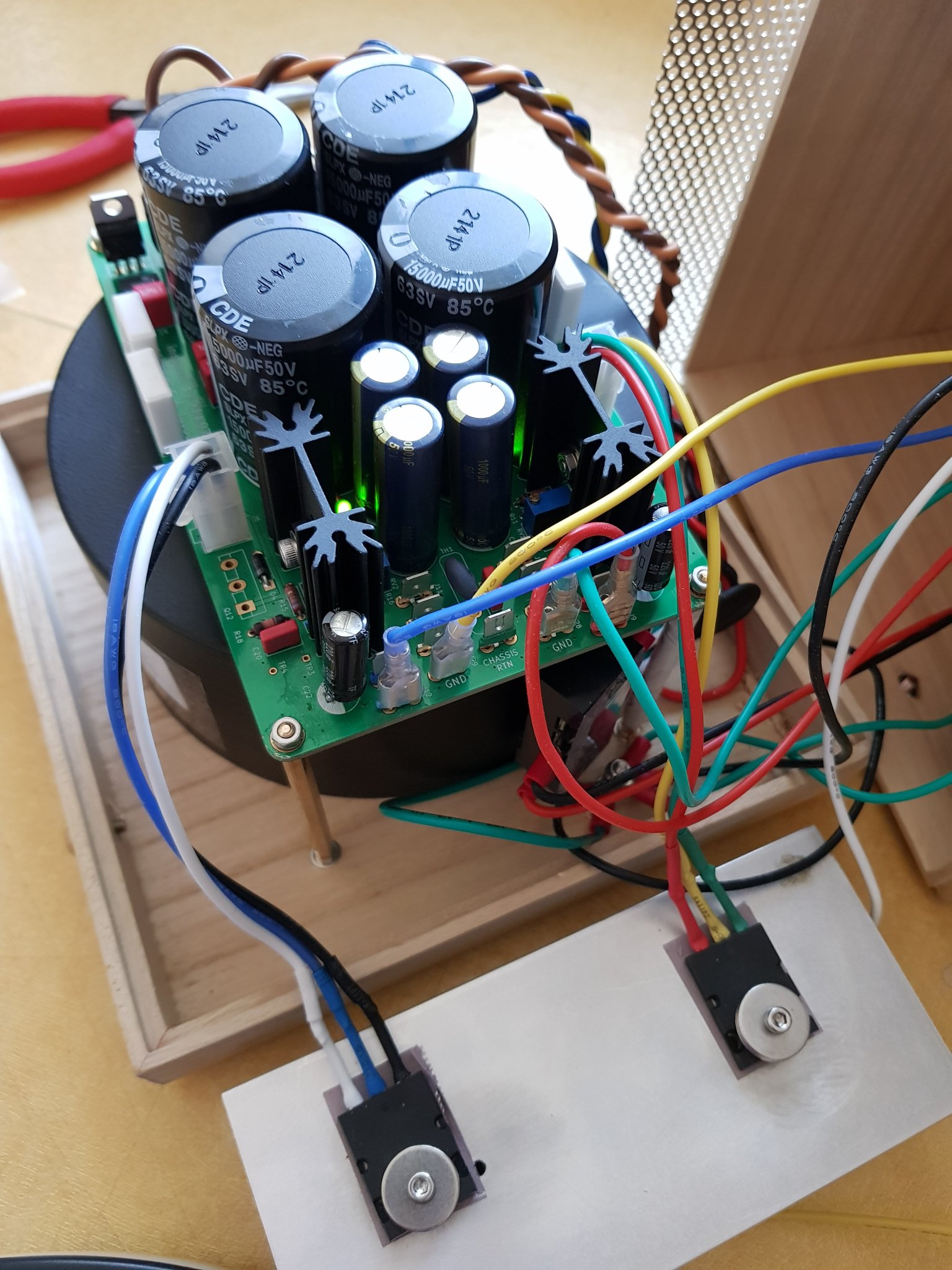

I am building this power supply in a separate chassis for FirstWatt M2X amp (and for other Class A Firstwatt amps).
220VAC -> switch -> fuse -> NTC 8D-20 -> primary of toroidal transformer (primary 220-0, dual secondary 21-0-0-21) -> SLB
I have two question.

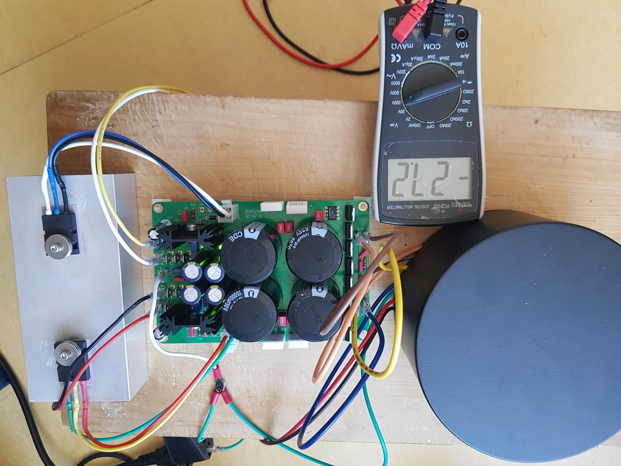

Before putting these in a chassis, I got +/-27.2VDC from this SLB without NTC 8D-20 and load.

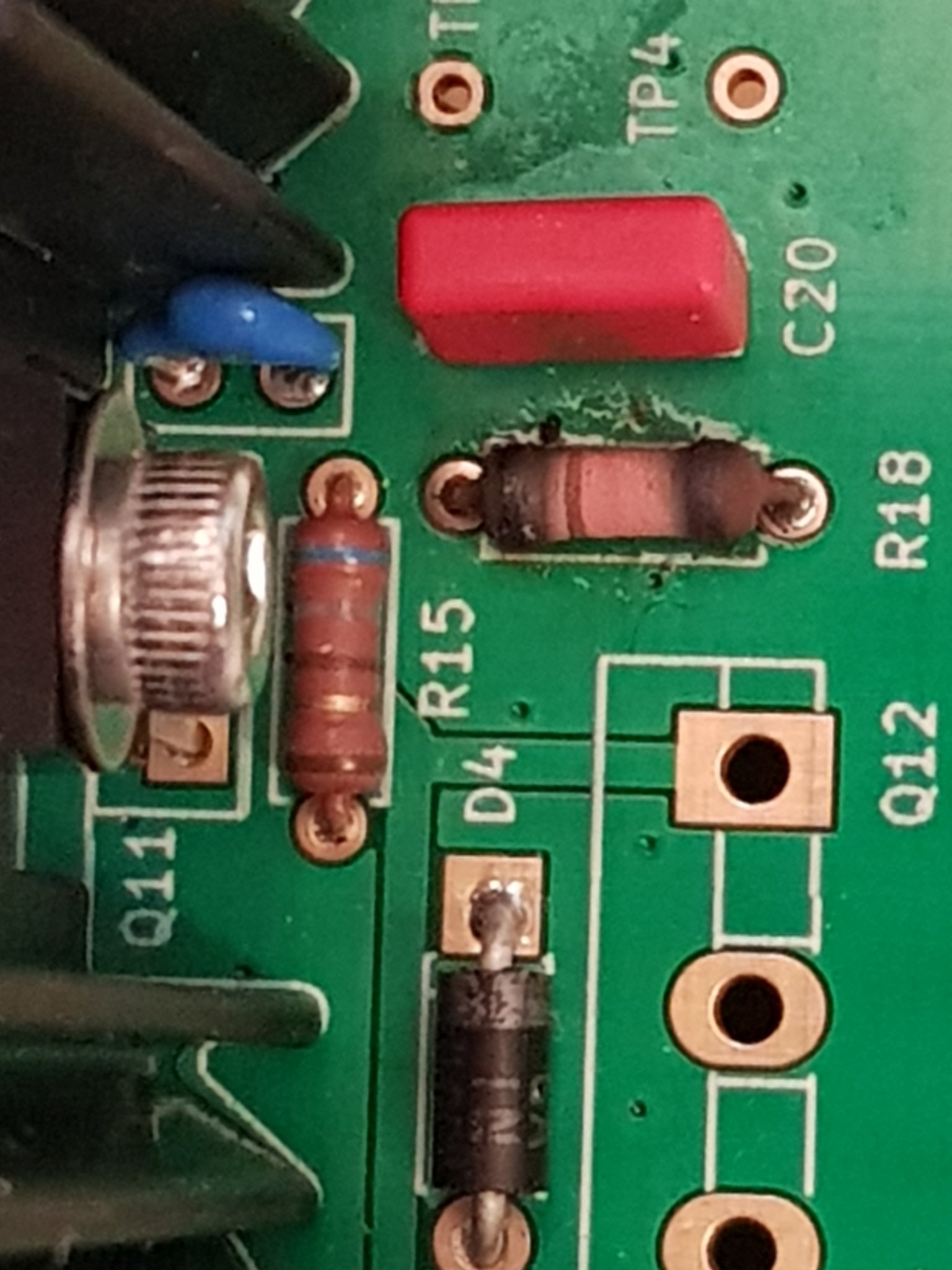

I put these all in a chassis at this time, and power it up .. then I smell somthing burnning so power off immediately.
I opened the chassis for checking some wirings and power it up again, but this time I got +27.6VDC at both PVout and NVout.
It seems so weried. I don't know what happened.
Is it okay to just use this as it is?
I turn the offset RV to CCW fully, and get 27.2VDC with no load.
It seems so high for a FirstWatt M2X amp that accepts around 24VDC.
Are there ways that drop some more output voltage of this power supply proper for M2X amp?

On your DMM, I see both a “27.6 Vdc” and a “- 27.2V dc” so I think you are fine. Make sure you have the correct polarities connected on your DMM (positive to red, negative to black/gnd). Or else you will be confused about the polarities when you look at the DMM display. Don’t fool yourself!
You have to understand that these values are near normal when you do not have a load. The load on an M2X is 1.3A approximately, so the voltage will/should drop to about +/-24 to +/- 25V. Even +/- 27Vdc is fine for an M2X design as the JFETs in the input stage (if using the Ishikawa Board) will not exceed their dissipation at that voltage.
Make sure all your wiring to that external umbilical connector is absolutely perfect. Use 2 DMM’s if you need to. And use a variac or dim bulb tester. I like to use variacs.
Remember the M2X circuit takes up to 60 seconds to draw a load as the 3300uf capacitor has to charge up first. The optical bias circuit on the M2 is a pretty cool implementation by N.Pass.

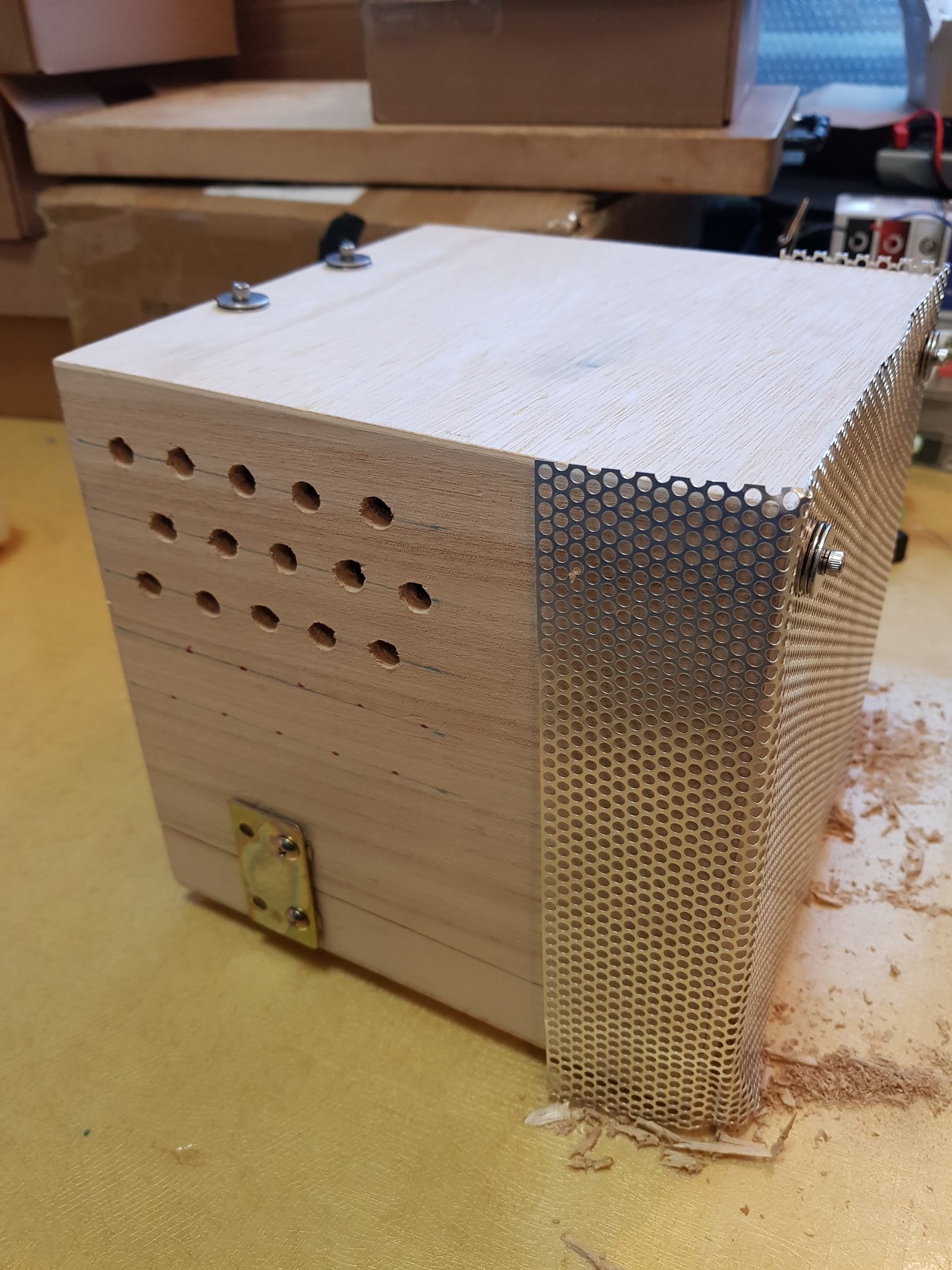

Your wooden enclosure looks a bit small to safely hold the SLB with transformer 😬

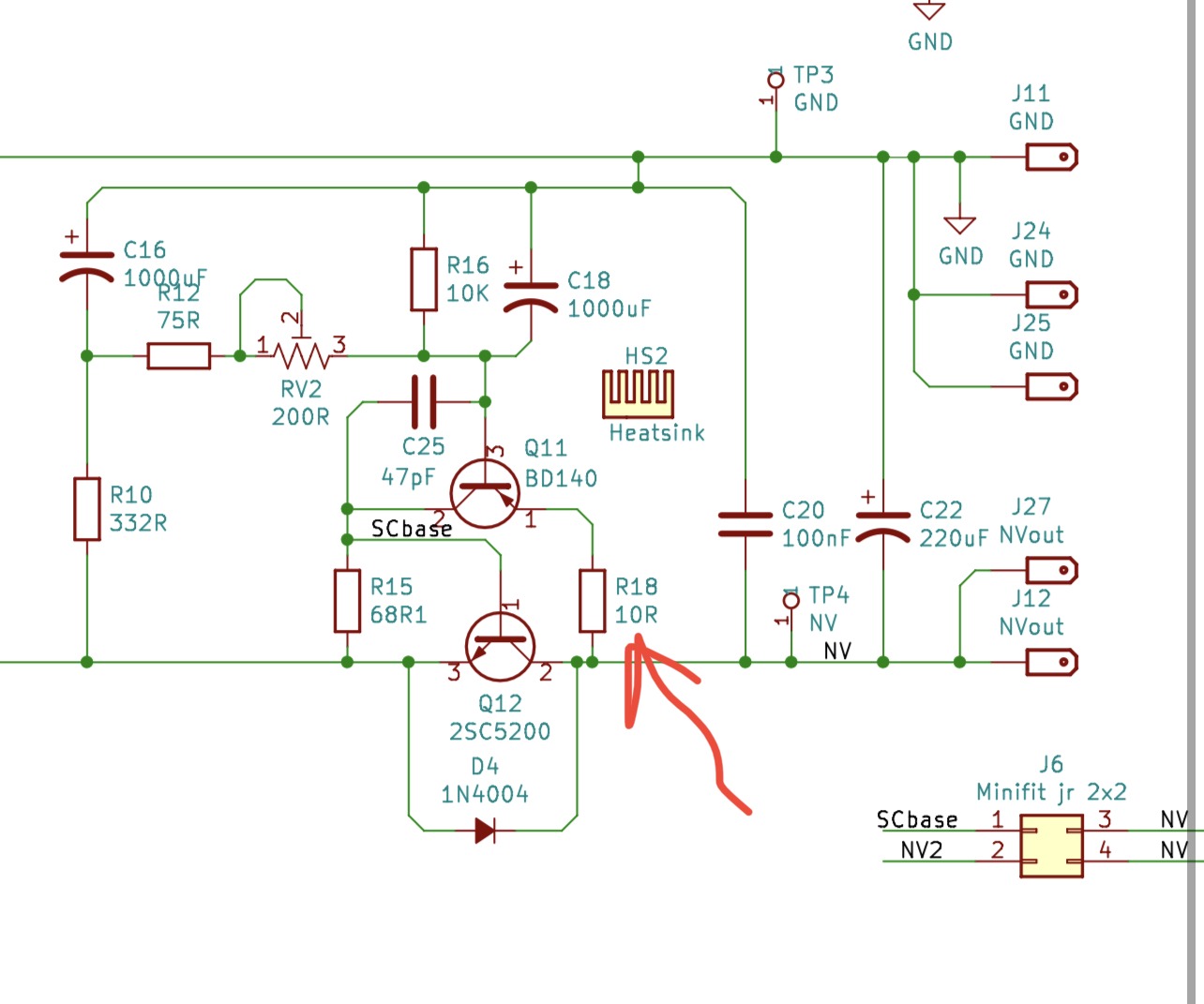

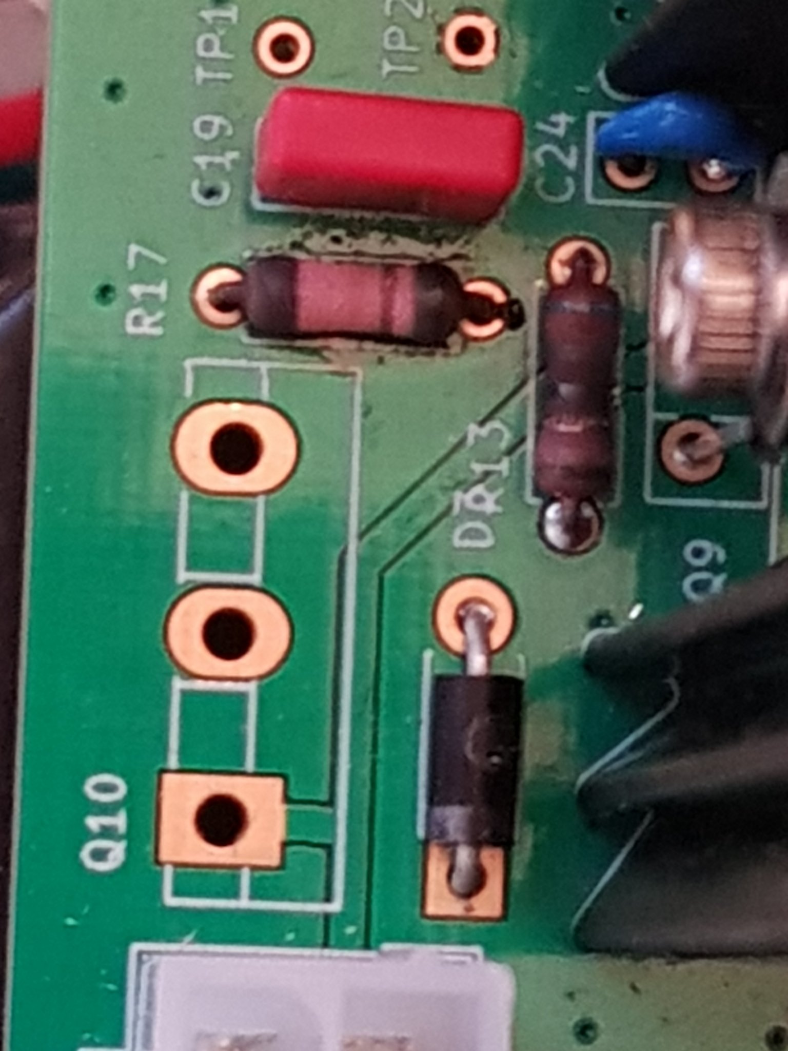

Check R18, looks like it was overheated, could be the source of the smell.

Yes, sharp eye Vunce.
Hi namghiwook,
R18 will try to pass the full current of the big Q12 external transistor if the transistor is disconnected or open circuit. If this happens, it will smoke and burn. I had this happen once when I forgot to plug the Molex MiniFit connector in before powering up.
Was your Q12 plugged in? Did you check to make sure the pin outs on Q12 cable matches the pins on the board?
27v under no load is good. You will have about 3v drop and this will make it 24v so perfect for 1st Watt 25W Class A amps.
I agree with Vunce that a small wood box with no air space is not the best choice for a chassis for this PSU. Add some vent slots. Also, know that the white KOA BPR resistors can reach 150C and they might burn the wood if they touch.
