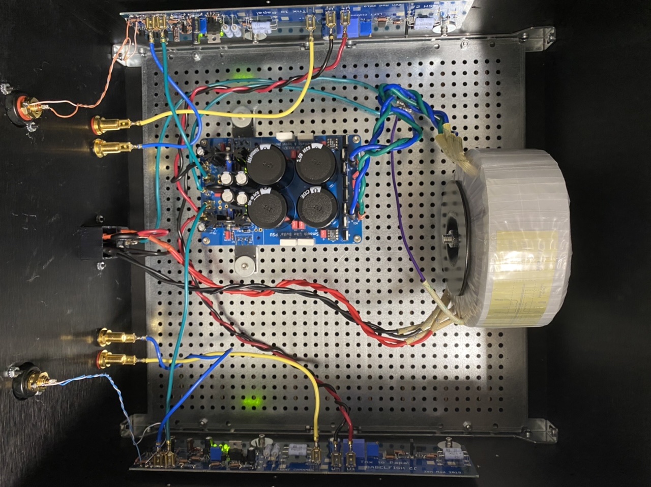

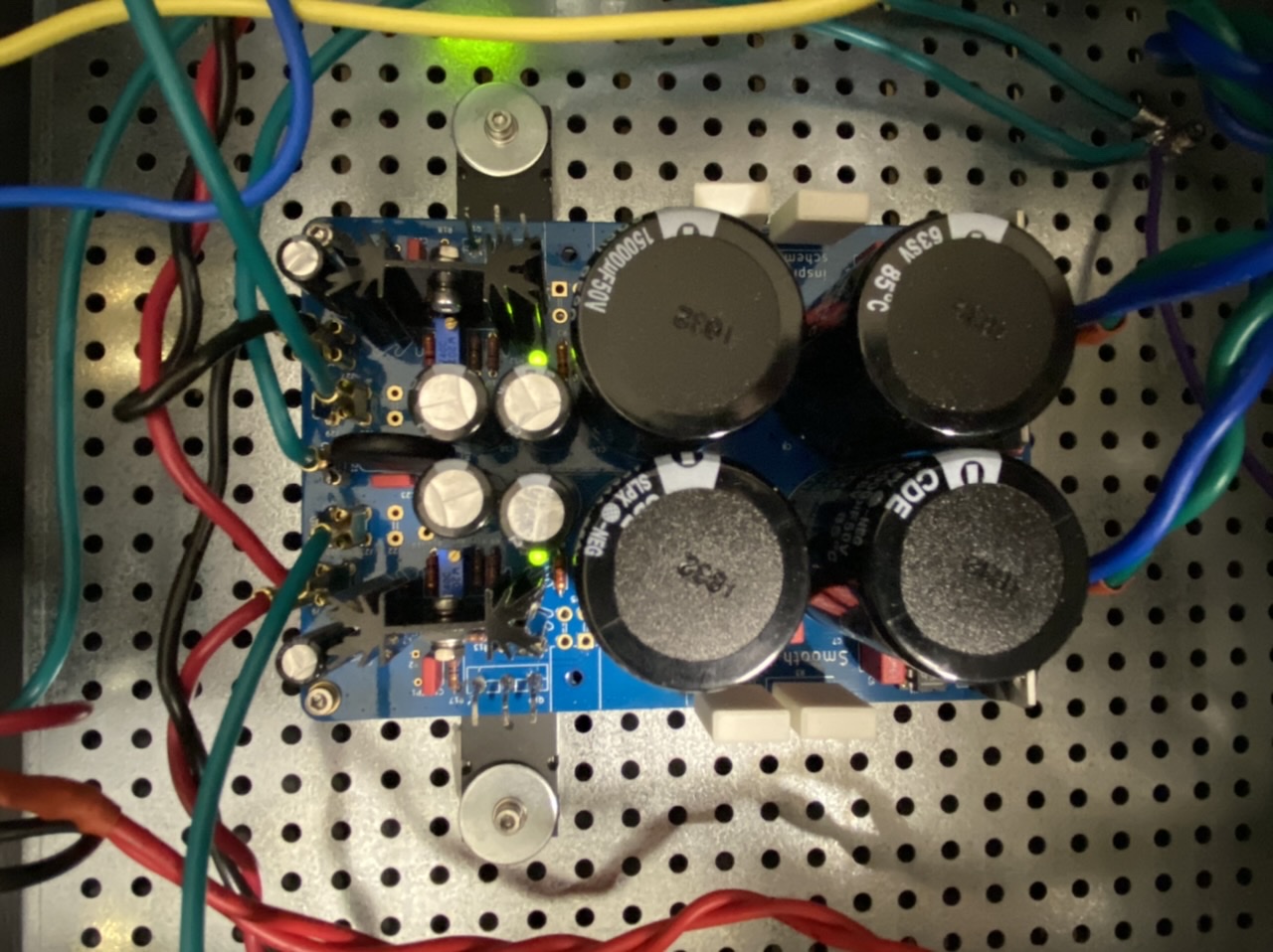

So I finally soldered up a dual rail SLB and powered it up tonight. I’m using an Antek 4222 transformer along with a Babelfish J2 board. Only one channel for testing right now. I’m getting 28.5V + and - with the single channel powered up. I believe I’m at about 1.5a bias at the moment. Everything seems fine, however, I’m not able to dial in any change in voltage with the pots on the SLB. I’ll have to go back and check my resistor values. I also have the LED on the negative rail in backwards but that shouldn’t affect anything, correct? Anything else I should be looking out for?
The amount of variation that the pots can change is very little. Maybe a few volts. It's not like one of the other cap Mx designs where you can basically dial in 6 or 7v or difference.
Are you not getting any change at all or very little?
Basically zero change. Maybe .1 or .2V. During my first test I hooked up a dummy load across each rail to ground, 16ohms to be exact. Could this have done any damage vs hooking up the dummy load across the positive and negative rails?
16ohm load should be fine. I the cap Mx reducing the ripple? What is the voltage drop?
Should be circa 100mV rms ripple in and 1mV ripple out.

Congrats on your new SLB! The trimpots have very little adjustment on the output voltage, less than 1v. Also, flip the LED so they are both working. 🙂

It seems to be filtering the ripple X. I’m not getting a single mv AC on my Fluke meter, unless there’s a better way to test. I have a cheap eBay scope I could put on there but I haven’t tried it yet. Not sure if it’s good enough to measure what I want to measure and not blow it up in the process. I’m no EE.
SLB is doing its thing with Babelfish J2 boards. I originally planned for dual mono but the single board seems to be working well so I’ll probably hold off on the second board for now. Best part? Both LEDs are working now.

Interesting! I am planning to do a dual mono SissySit anplifier. What makes you say one SLB is fine? My reason for dual mono is lower ground loop noise, as I have 110db efficient horn compression drivers.
And may I ask, how hot is that base plate now that you have screwed the fets to it?
Nice work Jwjarch! Glad it’s working out with just one. Dual mono will reduce ground loop noise, if it was a problem. If not then that’s cool. You will also get better stereo imaging with two.
@RobinDW, those are actually BJT pass transistors. You can calculate the dissipation if you know the current. For a stereo 25w Pass amp the bias is typically 1.25A per channel. So 2.5A x 3v drop. Or 7.5W or 15W for both. Not insignificant but I don’t think it’s too hot.
