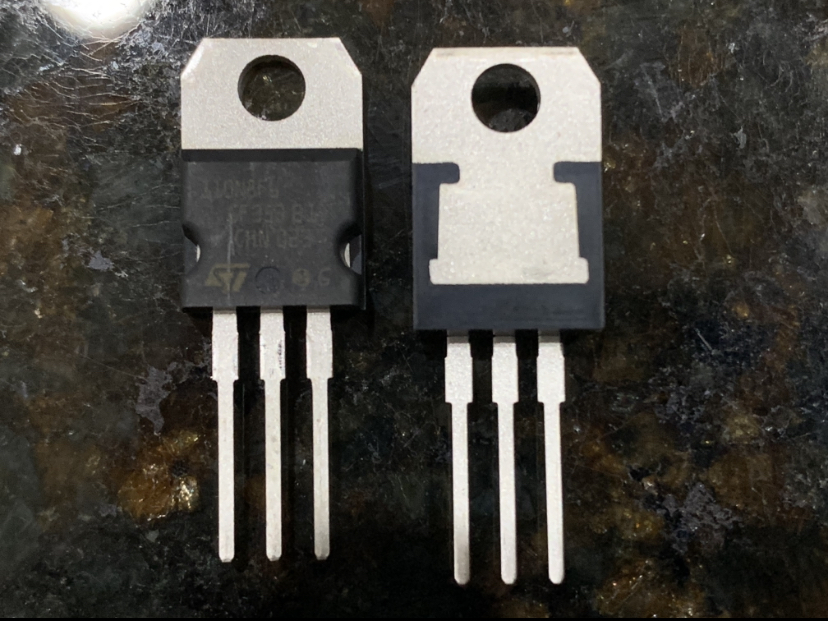

This says in stock (20k units) and only $0.55ea. That’s a great price. 110A, 80v, 6.5mOhm. Nice.
STMicroelectronics|STMicroelectronics STP110N8F6|MOSFET|LCSC

I just received 32 of these low RDson MOSFETs (110A 80v, 6.5mOhm) from LCSC for $24. Took about 10 days but they do look genuine. LCSC is parts branch of JLCPCB so they are reputable as they assemble PCBs.
Digikey have about 2k in stock of the STP110N8F6 - should still be plenty in Europe stockist.
