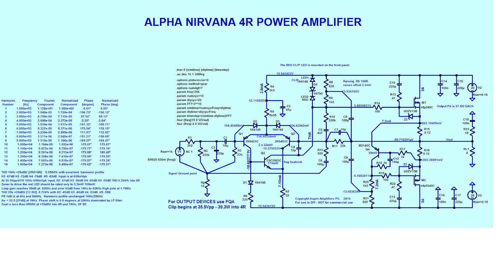

But when I connect up the AN board ... R18 starts to smoke - and R4/R6 get very hot! (These are reses on the SLB board.)
Hence Hugh is thinking that maybe the AN 4R circuit is not compensated correctly and is oscillating. So I am waiting for my Variac to arrive, so I can reduce the input mains voltage to get +/-15v on the SLB DC rails. If R18 doesn't smoke ... then AN oscillation would seem to be the cause of R18 on the SLB smoking at full voltage!
Andy
My Variac arrived - so I fired up the suspect AN 4R board with my new Variac on the mains supply (160v instead of 240v - to deliver 15v DC rails). R4/R6 on the SLB still got blisteringly hot ... and R18 started smoking!
So I switched off.
Hugh then suggested the AN 4R must be oscillating - which is causing oscillation in the SLB. So I should increase C4 on the AN 4R circuit (attached) from 15pF to 22pF, to stop this oscillation.
I had to wait a couple of weeks for these caps to arrive but, yesterday, I installed the 22pF cap. Fired it up this afternoon (with the Variac) and - at last! - R4 & R6 on the SLB only got hot (not blisteringly hot!) and R18 did not smoke! Yay!
So, yes, it would seem that C4 in the AN 4R circuit needs to be 22pF - not 15pF.
X, are you able to mark up the schematic with this change?
Now I have to do the same on my other three AN 4R boards.
Andy
