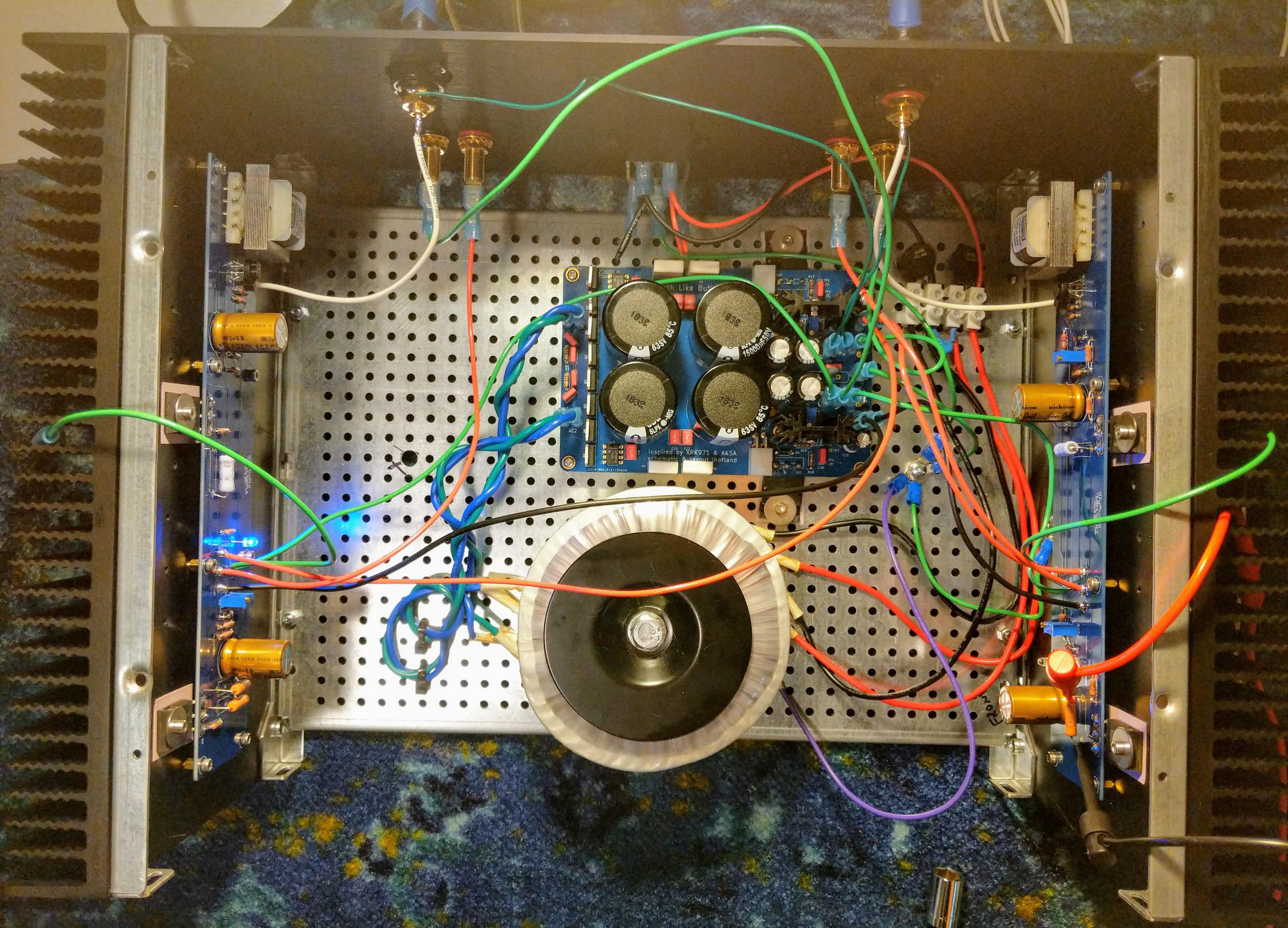

Solved the hum!
Sorry for the rapid fire posting (can you tell I'm excited?!), but I seem to have solved it.
The ground from the L channel PCB (which, recall, has nothing landed to it) was passing right over the Antek torroid. I unplugged this from the SLB ground hub AND I moved both it and the L channel speaker ground as far away from the torroid as possible. They both still land on the SLB hub. This seems to have solved the hum issue.
Photo attached.
Wahoo! Thanks all for the quick help. Now I can nicely dress the cables 😀.

Excellent work Metaphile!!
It’s very satisfying to tame the “HUM” beast, we’ve all been there 🙄
When you clean up all your wiring make sure to twist all of the AC wiring, primary and secondary side of the Trafo.
Enjoy your new F6!! :cheers:
Nice work! Glad you got it fixed so quickly.
Enjoy the hum-free music.
Do twist the primary red/black wires when you get the chance. That will help too.
A hum free Aleph J by evanc and a hum free F6 by metaphile. 2 quiet Class A amps courtesy SLB in one day. That’s a pretty good day.
