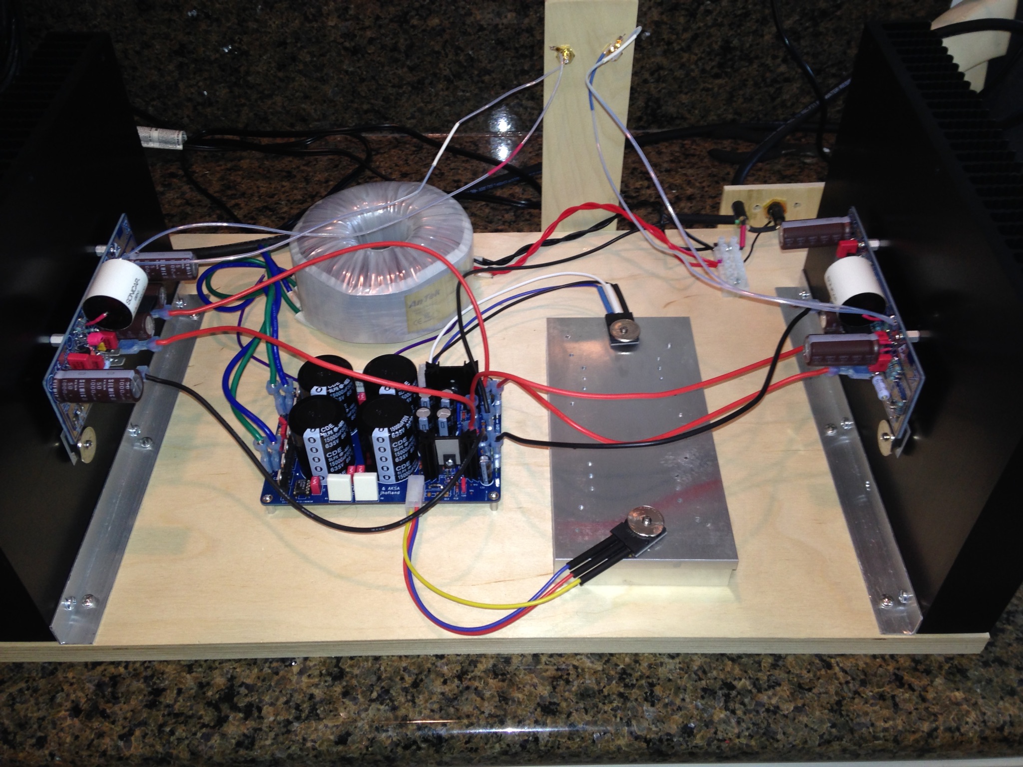

We had a few more successful Alpha 20 builds with the SLB posted earlier today (yesterday) by Bigaudioscotto and Raptorlightning.
Aksa Lender P-mos Hybrid Aleph (ALPHA) Amplifier
777300d1566684057-aksa-lender-mos-hybrid-aleph-alpha-amplifier-img_2256-jpg
Very nice work, gentlemen!
:cheers:
