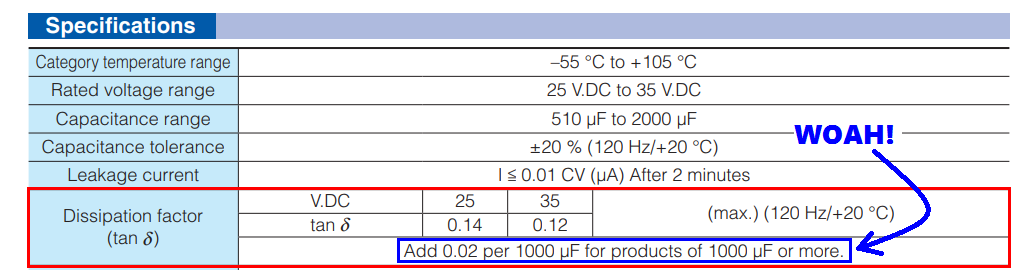

It might be useful to have your circuits guru read through the ripple current rating section of Nichicon's Applications guidelines for aluminum electrolytics (3 pages attached below -- the full doc is too big to attach).
Remember that in a mainstrafo-->rectifier-->caps circuit, the ripple frequency is 120 Hz so your calculations use tan_delta (dissipation factor), NOT the high frequency "ESR" spec that's provided for high frequency SMPS applications. Most electrolytic capacitor datasheets tell you the tan_delta AND the derating vs capacitance: see blue arrowhead.

Not sure why you are referencing the Nichicon datasheet. The BOM specifies a CDE 15,000uF 50v cap with 6.5A ripple current spec’d at 120Hz per the requirements defined by the LTspice simulation.

More as a caution to member evanc who proposes to use his existing stock of SLPX223M050H9P3 capacitors as substitutes.. Run the numbers and decide: comfortable? / nervous? / certainfailure? (That part number is just a guess based on the markings visible in the photo. Check against the invoice or shipping bag that evanc received, for the definitive not-a-guess part number)

Evanc has same Cornell Dubelier Electronics (CDE) SLPX 50v (photo clearly says CDE SLPX) but next size up at 22,000uF.
CDE caps
The 22000uF caps can handle 1.4 Amperes more ripple than the 15000uF ones, but have an ESR of 16 mOhms compared to 23 mOhms. And they're slightly cheapper than the 15000 uF ones. There shouldn't be a problem?

Looks like my part is rated at 7.89A @ 120hz.
I’m all for being careful with part selection but am unsure on how to math out this one. In this case I’m ok with letting intuition rule and checking the parts in use.
