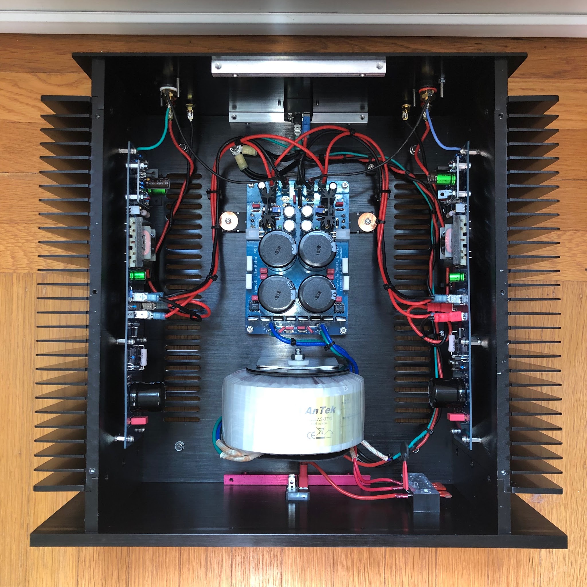

I was noticing that there are a lot of projects that need lower voltage, but high current low noise supplies. Like Rasp-Pi based music streamers, or various high end DACs, etc. There is a good reason to use an SLB SR to provide the 3A to 5A at 5v or 9v for these projects to get the ultimate low noise background.
Assuming a 3v drop across the capacitance multiplier, and another 1v across the CRC, and 3-4v sag under load, about 3-8v on top of nominal is needed. So 9v would be about a 16v to 17v dc from a trafo under no-load conditions. So a 12vac 25VA or 50VA trafo would be good for a 9v dc requirement. For a nominal 5vdc supply, use a 9VAC trafo.
Two SLB SR's as the other side of the SLB dual rail is strictly designed for -ve voltage. How many amps of current do you need as one SLB SR is good for 5A.

My initial application is to provide raw DC to the Salas Phono (yes overkill) - load is ~100 mA (I'm strongly considering to just use one board!). If I need more voltage drop, do I increase R2 and R3?
Max. raw DC recommended by Salas is 50 VDC. My existing Tx is 36 V secondaries and given the low load I'm estimating only ~3V drop across SLB. Australia typically has high mains voltage too.

Thanks for the order - did you want the single rail, because you ordered the standard dual rail. This PSU has about a 3v drop adjustable by maybe 1v or so. If you need more drop, and you only have 100mA current maybe you can use a larger R in the CRC?
Alternatively, you can use my simple cap Mx and regulated PSU. It has a CLC filter, MOSFET capacitance multiplier (4v drop) followed by a 78xx TO220 voltage regulator. You can use a TPS7Axxx LDO with 4uV rms noise regulator in TO220 package.
This does not have a rectifier though as it was meant for use with a Class 2 wall wart or SMPS.

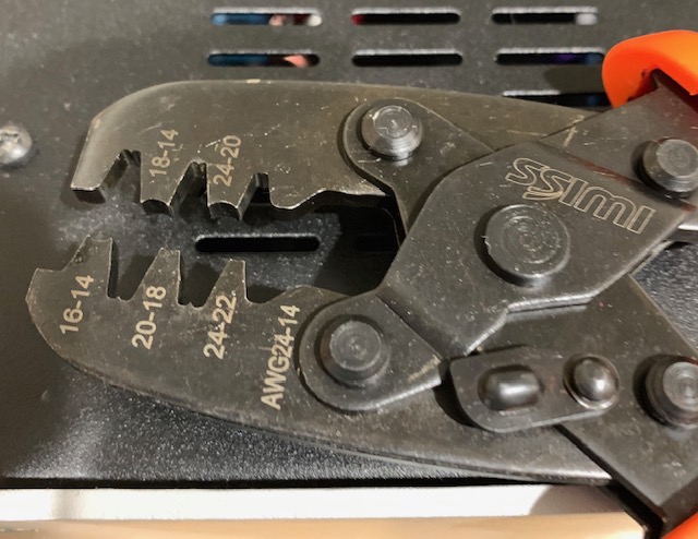

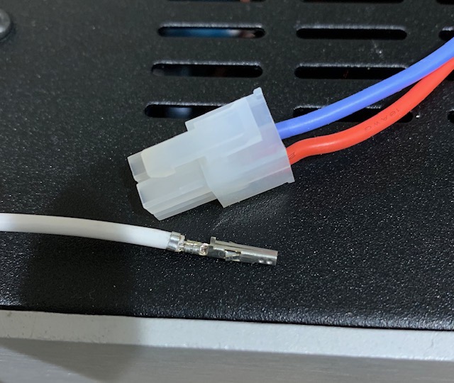

One more thing, if you want perfect crimps for the flying lead Molex, try this tool. I just got it and works superbly well. Good to have for the ABBB amp as well. I think we are going to be using Molex connectors on a lot more Aksa/Xrk/JPS64/jhofland designs, so not a bad tool investment.
IWISS Open Barrel Terminal Crimper Plier Tool for Molex Style DELPHI AMP TYCO Terminals Crimper Open Barrel 24-14 AWG - - Amazon.com
Example crimp on 18ga silicone insulation RC car wire:
attachment.php
Closeup of dies:
attachment.php
